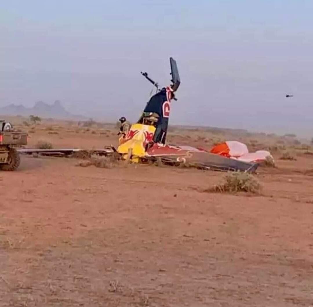

skydiverek 64 #55 April 25, 2022 (edited) Video attached, looks like a delayed parachute deloyment: - time interval between AAD fire (smoke visible from parachute rocket launch) and parachute appearing. - parachute seems to be reefed (like on space rocket). So, the Cypres might have fired at 750 feet, but it was not enough for this kind of parachute, IMO. 20220425_174719.mp4 Edited April 25, 2022 by skydiverek 1 Quote Share this post Link to post Share on other sites

gowlerk 2,303 #60 April 25, 2022 Not a good look for the BRS system, but it's not really their fault. It was a nose dive that clearly must have been slowed down somewhat by the very short canopy ride. They are mounted in such a way that deploying one will put a reasonably intact aircraft into a level configuration for a firm but survivable contact with a reasonably level piece of the planet. With that huge airbrake deployed it was never going to level out. I'm not even sure what the point of even having it was. But there probably were scenarios during the testing and training phase where it may have saved lives. Quote Share this post Link to post Share on other sites
wolfriverjoe 1,523 #61 April 25, 2022 2 hours ago, gowlerk said: Not a good look for the BRS system, but it's not really their fault. It was a nose dive that clearly must have been slowed down somewhat by the very short canopy ride. They are mounted in such a way that deploying one will put a reasonably intact aircraft into a level configuration for a firm but survivable contact with a reasonably level piece of the planet. With that huge airbrake deployed it was never going to level out. I'm not even sure what the point of even having it was. But there probably were scenarios during the testing and training phase where it may have saved lives. I was wondering what sort of attitude the airplane is supposed to be in for the BRS to work properly. I did a quick search, but didn't find much. How reliable is it when the airplane is in a steep dive? How long (how much altitude) will it take to deploy from that speed? It's been mentioned that there was a CYPRES that activated it. Is that true? An Airtec CYPRES used on a BRS? I'd need to see some confirmation on that (not that it wasn't, I just am skeptical). I know the 'standard' BRS is manually activated. I don't see any automatic options, but I wouldn't be surprised if these guys rigged something up (the airplane was supposed to be empty for a time, so that makes sense). I find it interesting that the FAA supposedly refused to grant an exemption to the rules for this, but they went and did it anyway. This sort of takes away any "I didn't know it was against the rules" defense. Given that they put a lot of effort (successfully) into making sure nobody got hurt, they saved themselves a fair amount of grief, but I wouldn't be surprised to see some significant fines and potentially ratings suspensions/revocations for this. Quote Share this post Link to post Share on other sites
JerryBaumchen 1,489 #62 April 25, 2022 22 minutes ago, wolfriverjoe said: I was wondering what sort of attitude the airplane is supposed to be in for the BRS to work properly. I did a quick search, but didn't find much. How reliable is it when the airplane is in a steep dive? How long (how much altitude) will it take to deploy from that speed? It's been mentioned that there was a CYPRES that activated it. Is that true? An Airtec CYPRES used on a BRS? I'd need to see some confirmation on that (not that it wasn't, I just am skeptical). I know the 'standard' BRS is manually activated. I don't see any automatic options, but I wouldn't be surprised if these guys rigged something up (the airplane was supposed to be empty for a time, so that makes sense). I find it interesting that the FAA supposedly refused to grant an exemption to the rules for this, but they went and did it anyway. This sort of takes away any "I didn't know it was against the rules" defense. Given that they put a lot of effort (successfully) into making sure nobody got hurt, they saved themselves a fair amount of grief, but I wouldn't be surprised to see some significant fines and potentially ratings suspensions/revocations for this. Hi Joe, My local News at 4, just had a teaser [ that old 'more at 5 PM' thingy ] that showed one person getting into an airplane. About one second of video of catching & getting into the plane. Jerry Baumchen Quote Share this post Link to post Share on other sites

pchapman 281 #65 April 26, 2022 (edited) 2 hours ago, wolfriverjoe said: How reliable is it when the airplane is in a steep dive? How long (how much altitude) will it take to deploy from that speed? Oh they are supposed to work in any attitude, using the rocket deployment, pulling the canopy out. Still a chance of the bridle getting caught up in something, but a good 'angle of fire' should minimize that. It's more about airspeed limits for the deployment. Seemed like a good idea to reduce the crash speed in case "an airplane got away". But it was a bit more of a snivel than there was time for with that activation altitude, however they rigged up an AAD to the pull system. Edit: Probably designed to snivel a bit with its slider, to keep the loads down during higher speed deployments. Not easy to build a parachute that is light weight and can work with the kinetic energy of a regular sized Cessna or Cirrus etc. I don't think there's a hard standard on how fast aircraft recovery parachutes are supposed to open under different conditions. One is expected to not pull them too low, whatever that is. Some FAQs for the BRS for Cessnas, if that's the system that was used: https://brsaerospace.com/questions/ I think the FAA is pretty dumb, they just don't seem to cater their system to 'fun' things like jumping BASE rigs from ultralights, or stunts like this. Even when public safety is taken care of. (Unlike the dumbass Trevor Jacob.) That being said, it really isn't a good idea to blow off the FAA either. Edited April 26, 2022 by pchapman 1 Quote Share this post Link to post Share on other sites

skydiverek 64 #68 April 26, 2022 8 hours ago, wolfriverjoe said: It's been mentioned that there was a CYPRES that activated it. Is that true? An Airtec CYPRES used on a BRS? I'd need to see some confirmation on that (not that it wasn't, I just am skeptical). Yes, it was CYPRES: Quote Share this post Link to post Share on other sites
wolfriverjoe 1,523 #69 April 26, 2022 Ok, I'm convinced. And impressed. I'd be interested in knowing how it was set up. The BRS has a rocket assist parachute launch, not a spring loaded pilot chute. The "B" is for 'Ballistic'. So there's no closing loop to cut, but a rocket to ignite. Probably not a hard thing to do, just take the impulse that ignites the cutter and use it to ignite the rocket. But I'm still curious about the details. And I would say, given the picture in post #56, that this doesn't count as a 'save'. The CYPRES may well have functioned as designed and intended (Airtec makes a big deal that that's something that has always happened), but that plane wasn't 'saved'. Quote Share this post Link to post Share on other sites
DougH 270 #70 April 26, 2022 6 hours ago, spezticle said: Got a video that’s a bit higher res and closer to the crash site. No, I didn’t record it. It was just sent to me. FullSizeRender.MOV 4.43 MB · 6 downloads That looks like way too late of a deployment altitude, it almost make you wonder why they bothered with the use of the BRS at all. I really wonder if that was the intended altitude, or if it was supposed to deploy higher but was impacted by the flat spin. Non pilot, non stunt coordinator, but why wouldn't you set the deployment of the BRS at a more reasonable hard deck? Human hard deck is say 3.5k, giving time to clear the plane, and then the BRS hard deck is 2k. Quote Share this post Link to post Share on other sites
