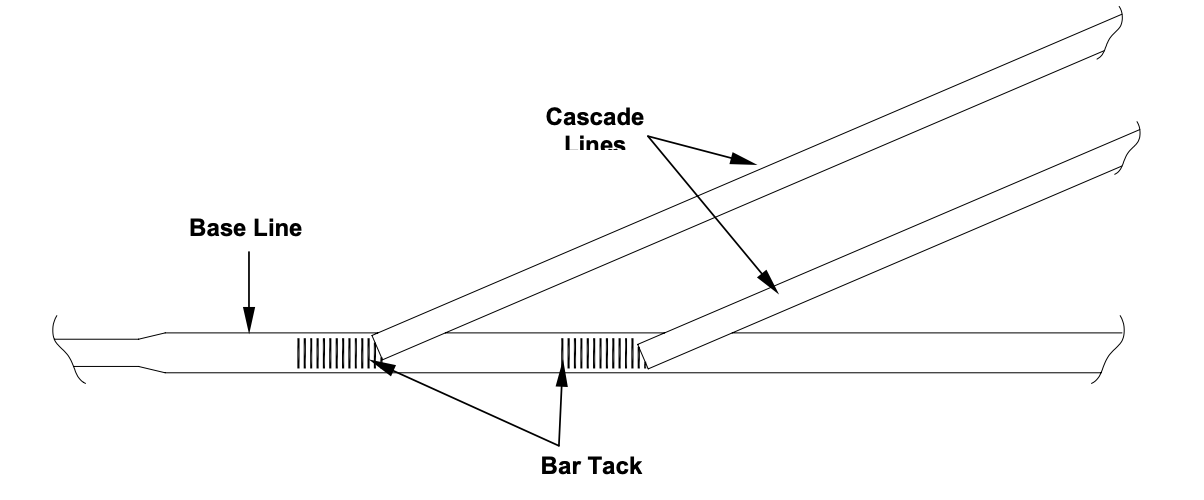

mark 107 #7 February 15, 2022 (edited) 42 minutes ago, TomAiello said: The 'trunk and branch' system was created by Simon Perriard . . . An MC-4 canopy control line has one line continuous from toggle to canopy, and other control lines branch off from this one continuous line. Is this the same thing as "trunk and branch"? If not, how are they different? From the MC-4 manual, a close-up of the branching off from the continuous control line: Edited February 15, 2022 by mark Quote Share this post Link to post Share on other sites
TomAiello 26 #8 February 15, 2022 (edited) That looks basically the same to me. There are variations within the manufacturers, having to do with line type and junction location. Simon put his junctions at fairly wide intervals, where Atair has placed their junctions all within a fairly close spacing. Virtually all BASE gear involves adopting ideas from other fields. Slats came from aircraft wings, loop style brake settings were first used on tandem rigs...the list goes on. Edited February 15, 2022 by TomAiello 1 Quote Share this post Link to post Share on other sites

ChrisHoward 8 #17 March 5, 2022 On 2/14/2022 at 9:31 PM, mark said: An MC-4 canopy control line has one line continuous from toggle to canopy, and other control lines branch off from this one continuous line. Is this the same thing as "trunk and branch"? If not, how are they different? From the MC-4 manual, a close-up of the branching off from the continuous control line: They are the same. The one difference that comes to mind is that on the MC-4s I have seen (DOM 84ish) they used Flat Braid Dacron and the "Cascade" was simply sewn to the side of the continuous line. On the BASE canopies that are finger trapped into the line. Quote Share this post Link to post Share on other sites
