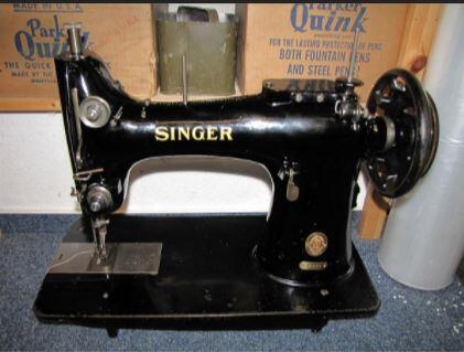

Quagmirian 40 #30 December 24, 2021 Has anyone ever used a Durkopp Adler 204-64 to sew a harness? It's only a needle feed heavy duty. I'm looking at getting one as even a rusty Singer 7 class is being advertised at £1500. Quote Share this post Link to post Share on other sites
RiggerLee 63 #31 December 25, 2021 No direct experience with that machine. But I've often thought that a 7 class was a bit overboard for 5 cord. There are probable machines out there that could handle 5 cord. Make sure you check the lift. Base jumping harnesses are not that thick. You might be able to find a smaller machine that would have the lift that you need and could see through with 5 cord. I can't remember the model. But we had this really old singer. That we got out of a guys barn for $100. We just called it the $100 machine. He was using it to repair really heavy horse tack. Harnesses and shit for the horses. He was sewing with a heavy cord. No markings on the spool. Probably a dacron but it was damn near 5 cord. Single needle simple dropfeed. Looked like a miniature version of a 7-33. That was actually a really great machine. I wonder how small of a needle would carry 5 cord? If you didn't go bigger then you had to that would make it easier to punch the needle through on a smaller machine. Lee Quote Share this post Link to post Share on other sites
JerryBaumchen 1,486 #32 December 25, 2021 1 hour ago, RiggerLee said: No direct experience with that machine. But I've often thought that a 7 class was a bit overboard for 5 cord. There are probable machines out there that could handle 5 cord. Make sure you check the lift. Base jumping harnesses are not that thick. You might be able to find a smaller machine that would have the lift that you need and could see through with 5 cord. I can't remember the model. But we had this really old singer. That we got out of a guys barn for $100. We just called it the $100 machine. He was using it to repair really heavy horse tack. Harnesses and shit for the horses. He was sewing with a heavy cord. No markings on the spool. Probably a dacron but it was damn near 5 cord. Single needle simple dropfeed. Looked like a miniature version of a 7-33. That was actually a really great machine. I wonder how small of a needle would carry 5 cord? If you didn't go bigger then you had to that would make it easier to punch the needle through on a smaller machine. Lee Hi Lee, I've posted numerous times about the Singer 132K6 machine that I used to build harnesses. The only limitation was the lift of the presser foot. I used a #27 needle for #5 cord, and it would sew with ease on anything I could get under the presser foot. SINGER 132k6 Heavy duty leather sewing machine - YouTube Jerry Baumchen PS) Consew makes a version of it but I do not remember their designation for it. PPS) The 132K6 machine is a walking foot & the 132K7 is just a drop feed. Quote Share this post Link to post Share on other sites
RiggerLee 63 #33 December 25, 2021 It's been a few years but I think that is the $100 machine. Must have been a 7. Just drop feed. That thing was small but a beast. We got a lot of work out of that little machine. Never knew the model. The plate was missing. Lee Quote Share this post Link to post Share on other sites

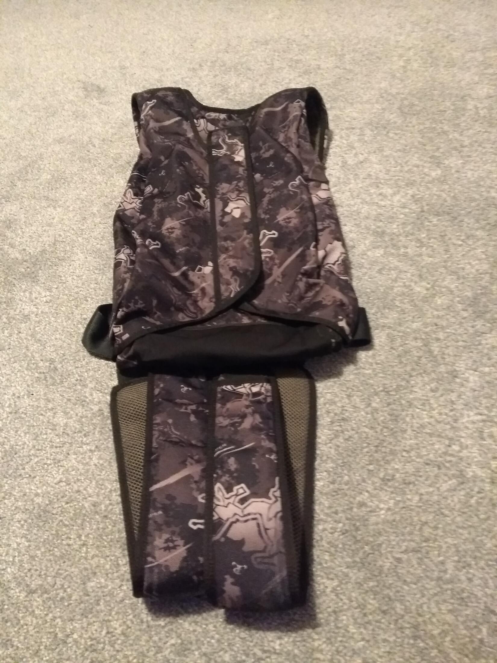

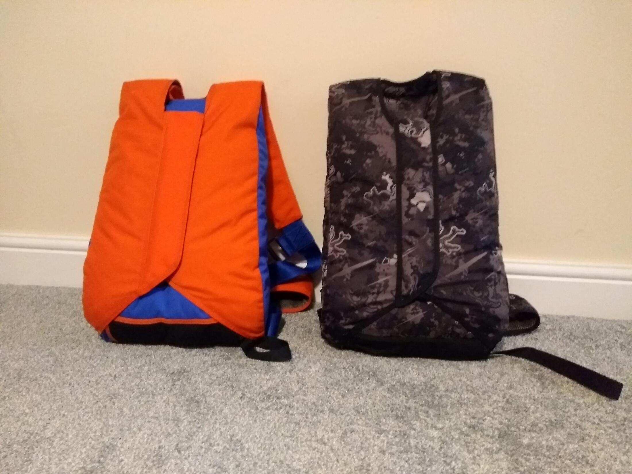

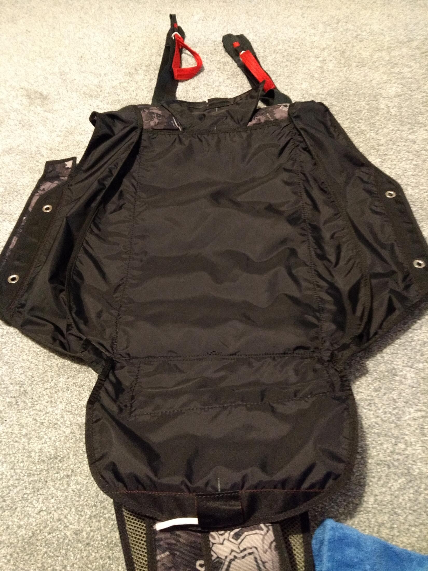

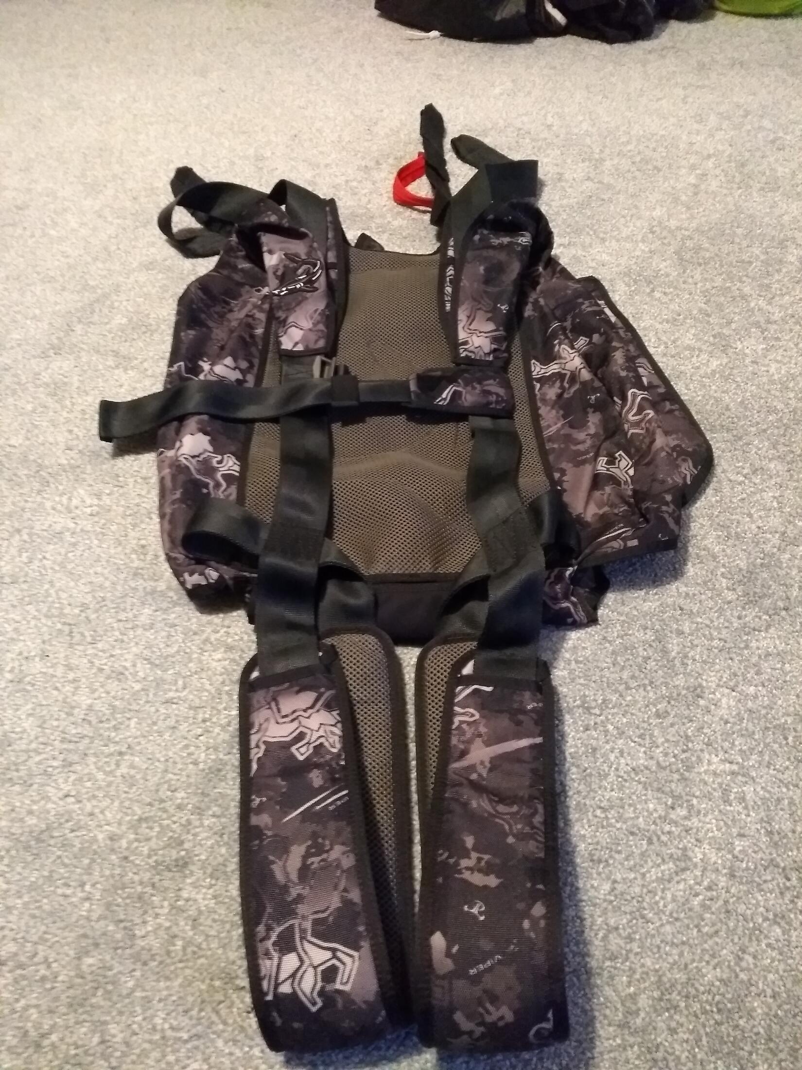

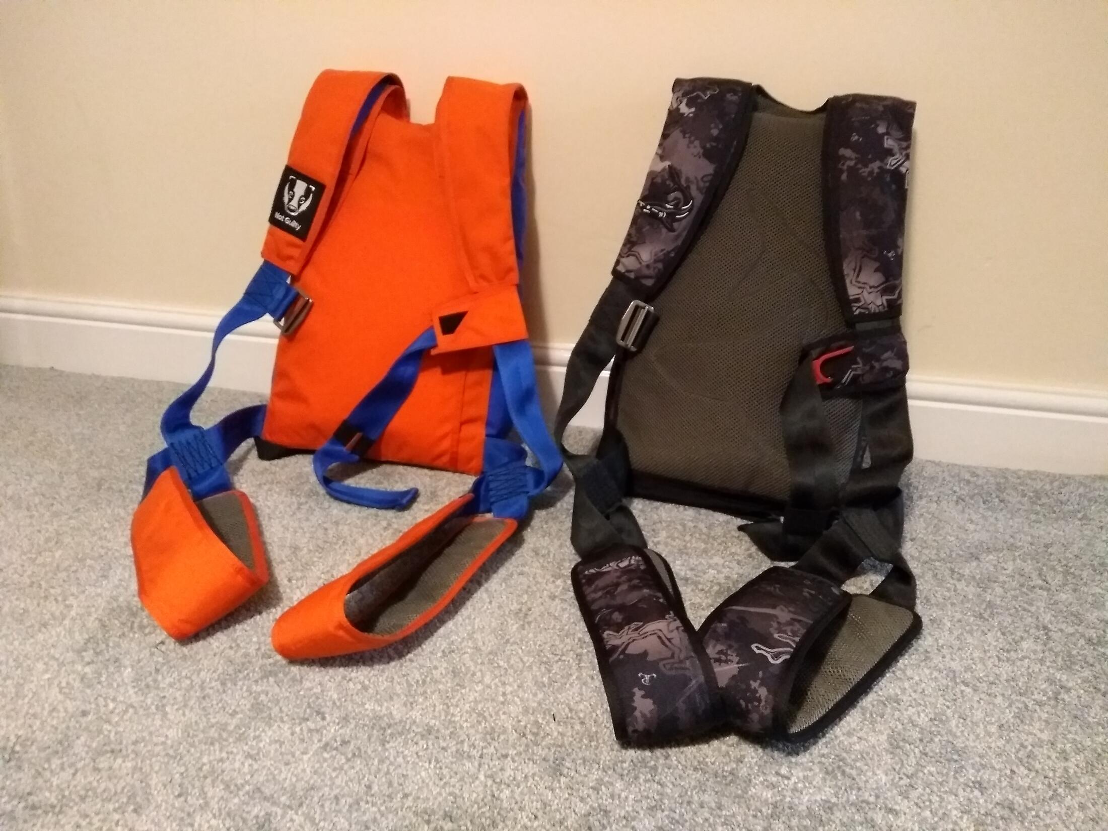

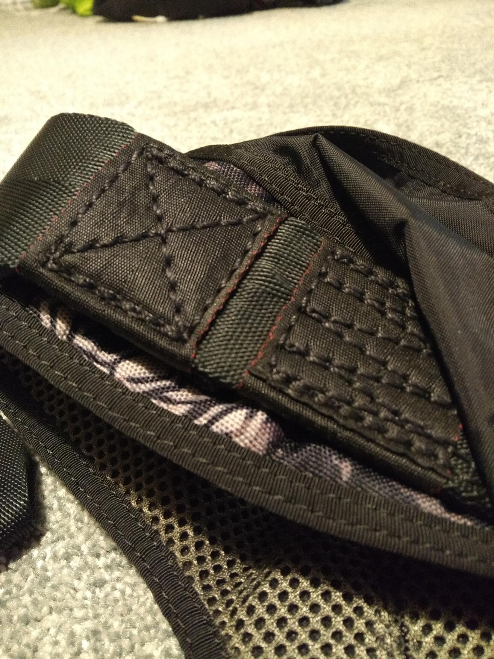

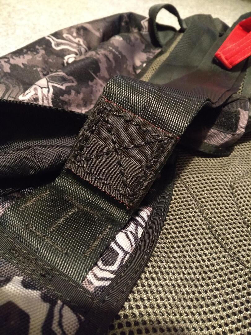

Quagmirian 40 #37 January 20, 2022 My containers are done. They are a bit tight because the harness shrunk more than I expected. 1 Quote Share this post Link to post Share on other sites
mark 107 #38 January 20, 2022 Gorgeous workmanship! 1 Quote Share this post Link to post Share on other sites
RayLosli 11 #39 January 26, 2022 Man those are looking Good . They look real solid just looking at the Pic's. Nice stitching and finish work to, container and tray just open nice and clean for a good extraction . It's a nice feeling to pattern/cut/sew-up your 1st Rig, then pack it up, take it out and put a jump on it . You will always remember that. . Quote Share this post Link to post Share on other sites
RiggerLee 63 #40 January 27, 2022 It does look good. I hope you had fun with the project. Your skill set is rounding out very nicely. I wonder if you realize how much you've learned in the course of all this and how far youve come with these projects. One thing I think you should look at. I don't know where you would find it at this point. It may not still exist but there was a series of threads on base jumper. They grew out of an accident at perion. It was a pilot chute in tow/pin pull hesitation? I don't think it was ever really resolved but it developed into a series of conversations about flap and cover flap designs. It dug into dimensions for pin clearance, rotation, pin orientation, orientation of the pin attachment to the bridle, even pin design and geometry. They did identify some potential failure modes. It's worth preserving if any one is smart enough to go back and find it. I think it was spread out over a couple of different threads. But the rig looks great. Now you need to go and start testing it... Do they still run a ferry from Newcastle to stavanger? Just a quick ferry ride to lysebotten and kerage. Lee Quote Share this post Link to post Share on other sites
