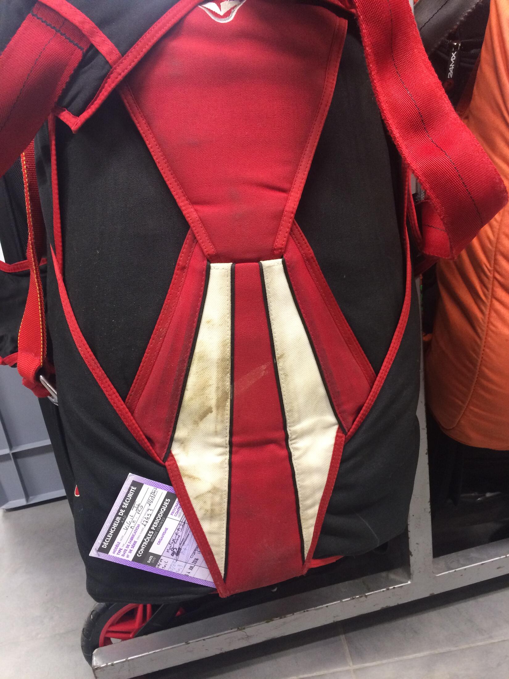

sundevil777 102 #78 February 3, 2022 33 minutes ago, glh said: You leave something in my reseve packjob that doesn't belong and If i survive there is going to more than just a discussion about what happened Of course it is clear what that slotted plate is. They were likely doing a lot of tests, with a lot of re-closing of the container. If in the rush to do many tests the mistake of leaving the plate was made, it should be admitted instead of silence we've had since that video was released. I do understand now that the plate is likely not relevant to the situation, as certainly we can all see there's more to this than just a couple guys setting up a failure on purpose or by neglect. Again, it would be nice if the plate would be acknowledged, but I no longer think it matters. Quote Share this post Link to post Share on other sites
rem 0 #79 February 4, 2022 there's definitely NOT a plate, just paper-rig... like : Quote Share this post Link to post Share on other sites
sfzombie13 324 #80 February 4, 2022 36 minutes ago, rem said: there's definitely NOT a plate, just paper-rig... like : nope. that was not paper or cardboard, unless it makes a clacking sound when it drops, and doesn't flutter or hesitate at all. video a drop of that tag and show what it looks and sounds like. that tag in the picture is most certainly cardboard based on the visible corner dogear. 1 Quote Share this post Link to post Share on other sites
BMAC615 209 #81 February 5, 2022 On 2/3/2022 at 3:40 PM, glh said: You leave something in my reseve packjob that doesn't belong and If i survive there is going to more than just a discussion about what happened There are other videos and testing by FPF and Aerodyne that replicate reserve hesitation/lock without a plate left in. Quote Share this post Link to post Share on other sites
piisfish 140 #82 February 5, 2022 On 2/4/2022 at 1:12 PM, sfzombie13 said: nope. that was not paper or cardboard, unless it makes a clacking sound when it drops, and doesn't flutter or hesitate at all. video a drop of that tag and show what it looks and sounds like. that tag in the picture is most certainly cardboard based on the visible corner dogear. Actually I believe that it was indeed the rig paperwork. In France they have 4 different documents Harness, reserve, main and AAD. Plus the eventual works report, AAD service paper, insurance, license. Often the jumpers keep the paperwork in a plastic envelope. On the video, it looks like the whole booklet. 1 Quote Share this post Link to post Share on other sites
sfzombie13 324 #83 February 6, 2022 it may have been the whole booklet if it was in plastic, but when zoomed in it looks a lot like it has a small slice in it like a tool, but it is really hard to tell and it doesn't matter much i guess. not the first time i made a mistake. Quote Share this post Link to post Share on other sites
eric.fradet 17 #84 February 9, 2022 On 2/4/2022 at 1:12 PM, sfzombie13 said: nope. that was not paper or cardboard, unless it makes a clacking sound when it drops, and doesn't flutter or hesitate at all. video a drop of that tag and show what it looks and sounds like. that tag in the picture is most certainly cardboard based on the visible corner dogear. sfzombie13 is correct. I spoke with the rigger Raphael Plantin in Saumur, he forgot the 4 documents in their plastic cardboard that he had slipped in between the reserve flaps, which made this sound when hitting the ground. Now ,all folks who spend their energy wondering what fell out of that rig, would have better ask Aerodyne what corrective action are they going to take to make their rig working properly? once every 10 days in this repack cycle perio, riggers report to me a malfunction in the Icon reserve opening. This rig will soon be grounded in France, which does not mean that it will work better abroad; like the virus it crosses borders. Quote Share this post Link to post Share on other sites

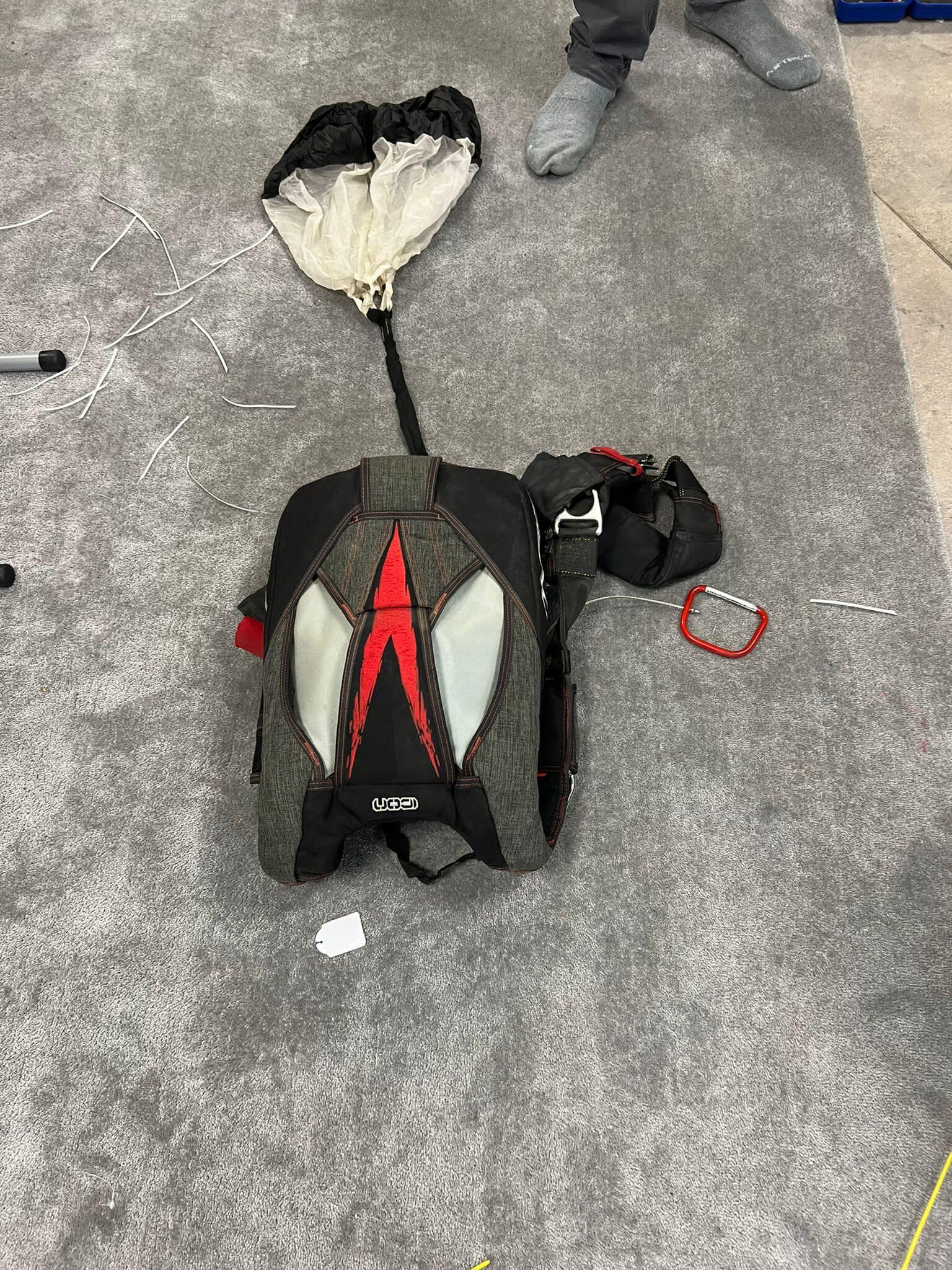

yarpos 4 #92 February 12, 2022 mmm sub optimal it seems I would like to see it deployed with the leg and chest straps done up and normal tension on the harness as it would have been designed for. Very few reserves are deployed without a secured harness , at least not more than once. 1 Quote Share this post Link to post Share on other sites
