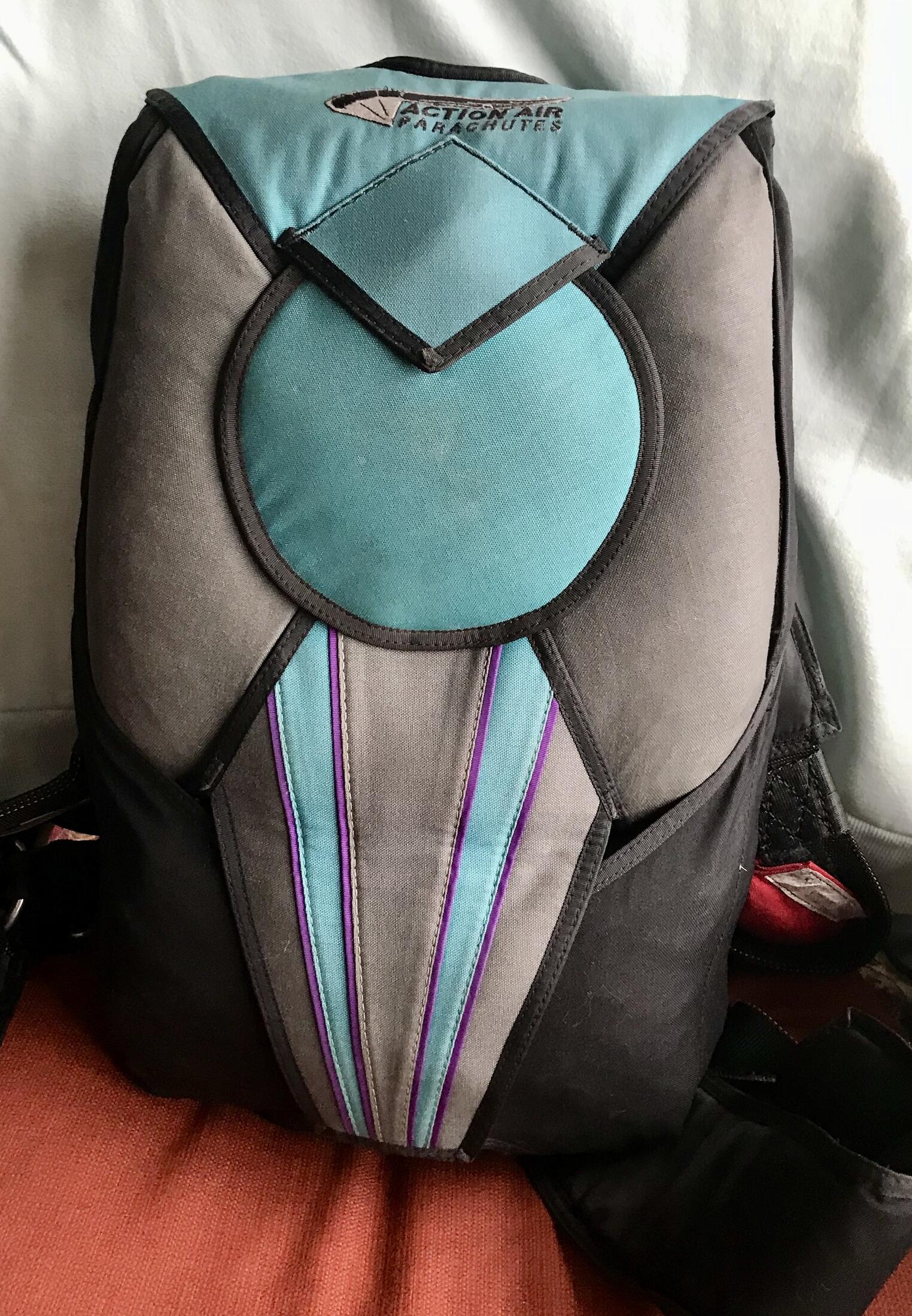

SStewart 13 #5 October 25, 2021 This mod will help keep the cap from getting snagged. I have seen 3 people lose the caps with a Reflex and all 3 were on the door during exit. Standing up too tall in the door. 1 Quote Share this post Link to post Share on other sites
riggerrob 644 #6 October 25, 2021 1 hour ago, SStewart said: This mod will help keep the cap from getting snagged. I have seen 3 people lose the caps with a Reflex and all 3 were on the door during exit. Standing up too tall in the door. That extra flap was originally designed for a canopy formation team. I think they also built a few Reflexes with a similar flap protecting the bottom edge of the pilot-chute cap. 1 Quote Share this post Link to post Share on other sites
