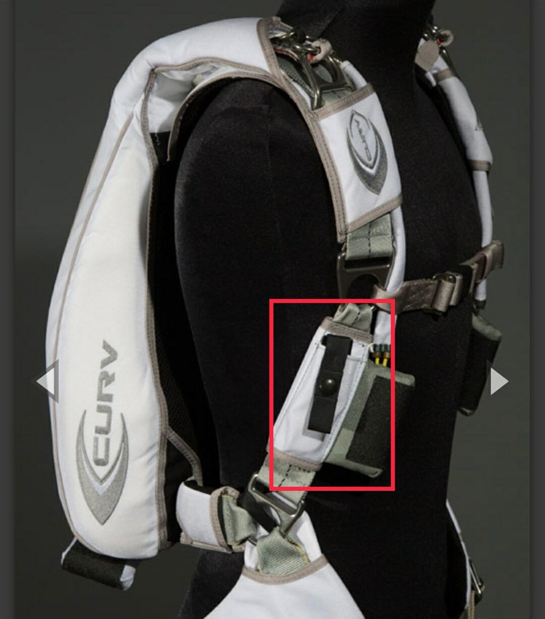

mark 107 #5 August 29, 2021 1 hour ago, BIGUN said: BTW, wear a knife. This rig comes with a MLW-mounted hook knife standard. Quote Share this post Link to post Share on other sites

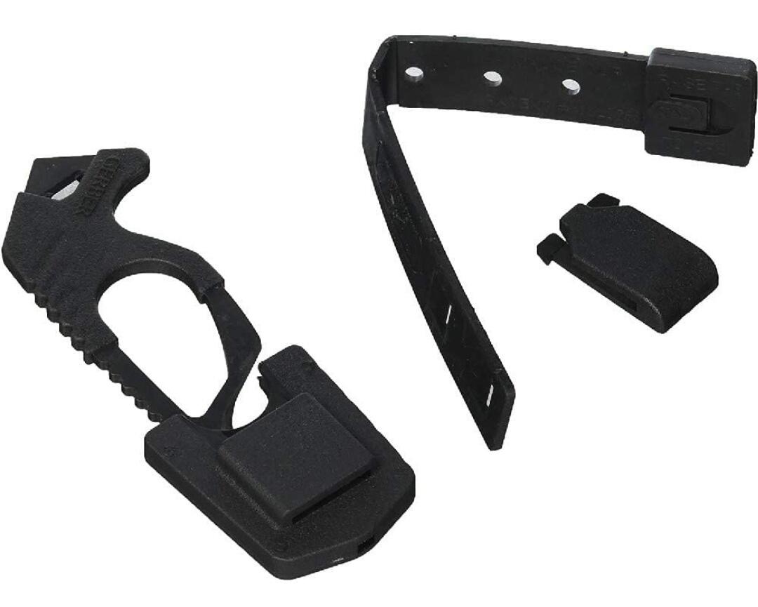

tabouare 25 #6 August 29, 2021 6 hours ago, BIGUN said: The reason for the EP is to prevent one from firing their reserve into a horseshoe malfunction. BTW, wear a knife. Makes sense but usually a horseshoe happens higher up and you have more time to deal with it. Like Mark said, the rig came standard with a hook knife. A very shitty one. I replaced it with a mystic (flew away during a group jump) then with a Dakine. The problem with most the hook knives on skydiving rigs is that they have a floppy fabric handle and you need to reposition your hand to use it. It's very easy to drop as demonstrated during my malfunction. My recommendation is to have 2 knives on you. Gerber and FKM-1 solve the need to reposition your hand and are compact. I'm sure others are available on the market that fits the bill. Quote Share this post Link to post Share on other sites

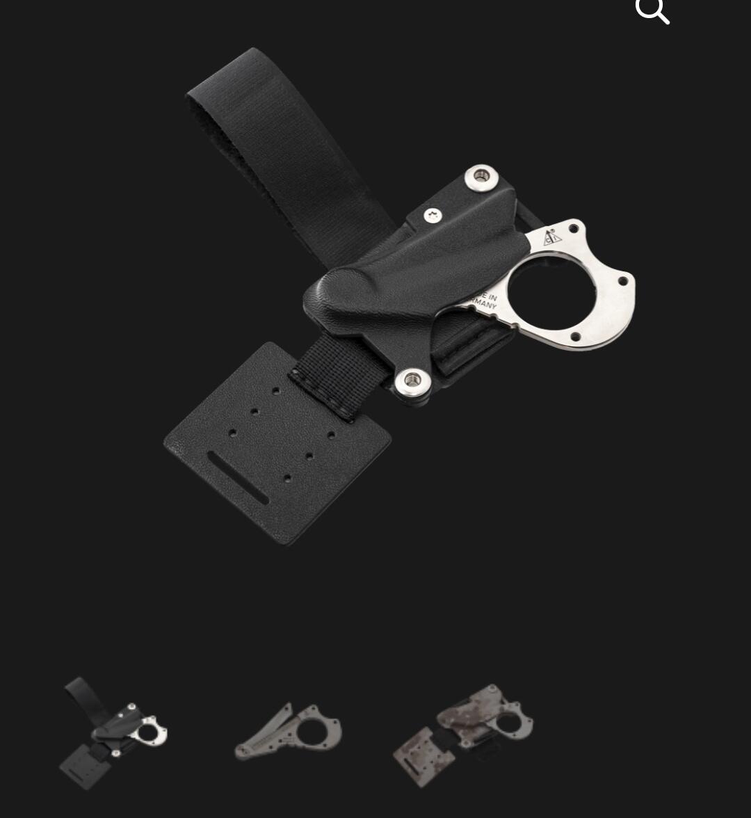

AYY_BBY 0 #7 August 29, 2021 Hey, could I get links to the two hook knives that you recommend please? Quote Share this post Link to post Share on other sites
meteora 2 #8 August 30, 2021 https://westerwings.de/shop/fkm-1-kappmesser-2/ That's the FKM-1. A friend of mine makes them in Germany. They also made a video to compare it with other skydiving knives: Quote Share this post Link to post Share on other sites
timski 80 #9 August 30, 2021 On 8/29/2021 at 9:46 AM, BIGUN said: BTW, wear a knife. 4, but who's counting?!! 1 Quote Share this post Link to post Share on other sites
tabouare 25 #10 August 30, 2021 17 hours ago, AYY_BBY said: Hey, could I get links to the two hook knives that you recommend please? Amazon for the Gerber Quote Share this post Link to post Share on other sites
