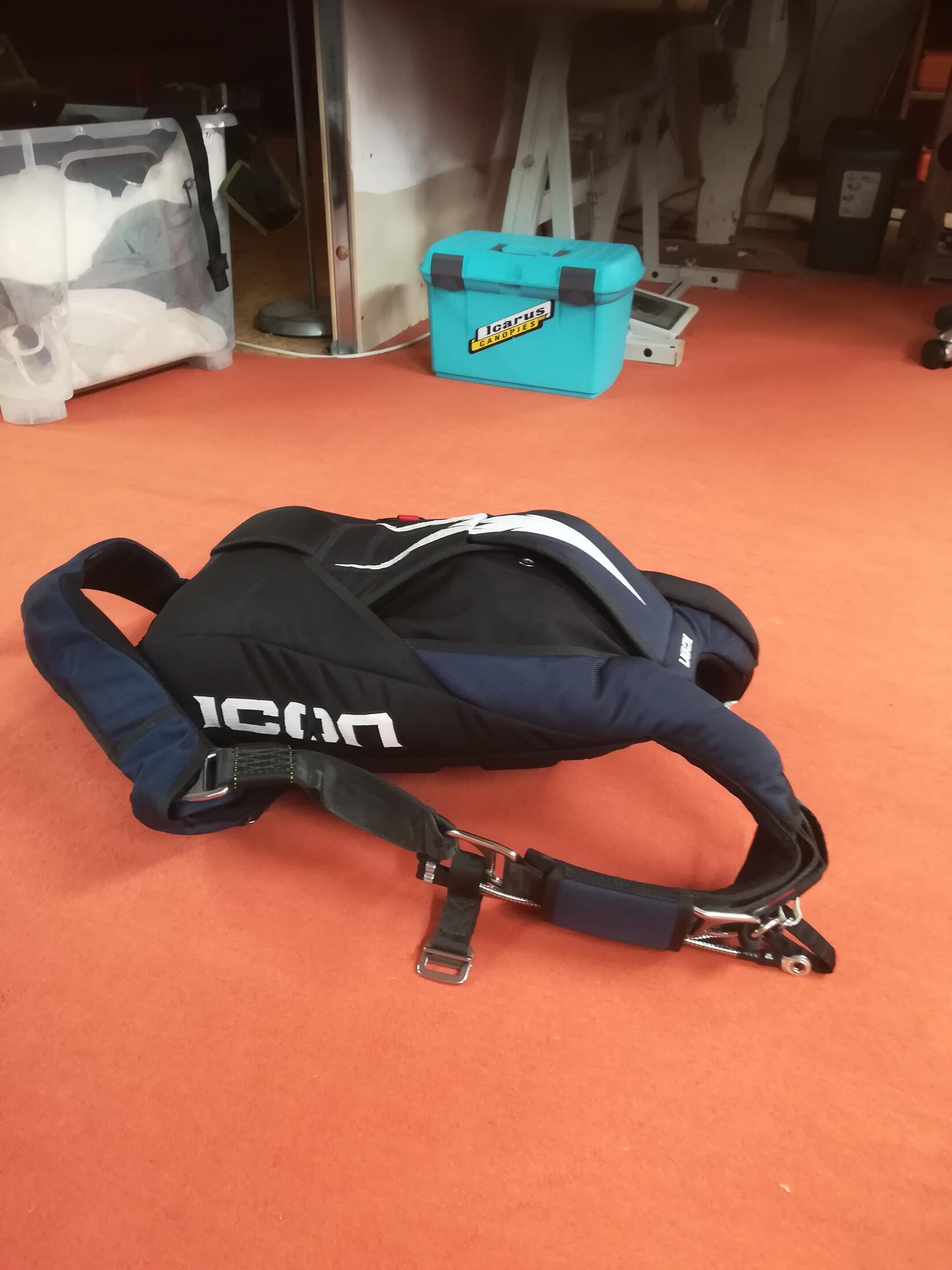

george rousseau 1 #9 July 23, 2021 16 hours ago, skybytch said: Thats a hesitation. A total is when nothing launches. Can't tell much since the video is from the front. From the side would be way more useful. A hesitation on the bench does not mean it will hesitate in freefall. Freefall is not static like laying on a bench is. If the jumper were to drop a shoulder should it happen in freefall (standard student training, yes?) the shifting of the container and additional airflow over the back will likely clear any hesitation. Just too many variables involved to be blaming the container without specifying exactly what caused the hesitation. Besides the fact that bench hesitations are not unusual on any container (per my master rigger husband with 6k repacks...). Is the closing loop the correct length? One that is too long could cause a hesitation. Are the canopies correctly sized for the container? Over or understuffing can create these sort of issues. More details and a video that actually shows something useful are needed if you are going to attempt to damn the container manufacturer for something that may not be a container issue. Especially on the internet... using a click bait title... in a forum frequented by noobs... you are correct, here is a reserve total malfunction with Icon, the rigger had time to take the rig off and picture it 1 Share this post Link to post Share on other sites
sfzombie13 324 #10 July 23, 2021 5 hours ago, george rousseau said: you are correct, here is a reserve total malfunction with Icon, the rigger had time to take the rig off and picture it that's even worse than the first video. hell, i can take a picture of my rig like that with the right shit stuffed inside. Share this post Link to post Share on other sites
BIGUN 1,521 #11 July 23, 2021 (edited) 4 hours ago, george rousseau said: you are correct, here is a reserve total malfunction with Icon, the rigger had time to take the rig off and picture it Oh lookie. Another sock puppet from France who also joined four hours ago to bash Icon on this site. How about you [BLANK] write up the necessary report to Icon instead of dragging them thru the mud. I jumped an Icon for years and had no such issue and at that time; never heard of one. Edited July 23, 2021 by BIGUN Share this post Link to post Share on other sites
skybytch 273 #12 July 23, 2021 (edited) Nice picture. Might want to shorten up that closing loop. What did Aerodyne have to say about this? Edited July 23, 2021 by skybytch Share this post Link to post Share on other sites
