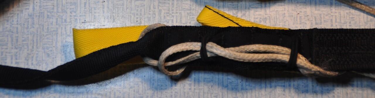

Veis 29 #43 June 3, 2021 We lock the line by the textile rubbers and the tip of the loop by the lower tongue of the toggle 3 Quote Share this post Link to post Share on other sites

lug 4 #45 June 3, 2021 9 hours ago, Veis said: We lock the line by the textile rubbers and the tip of the loop by the lower tongue of the toggle Veis thank you for providing an image that illustrates the real issue of this thread. This thread went wrong, not productive when the debate started about equipment or what could/should have been the proper course of action made by NWT. The thread should be focused on the management of the excess break lines and how well they were not secure and then show methods on how to improve securing the excess break line that can help prevent this type of unusual malfunction. 4 Quote Share this post Link to post Share on other sites
