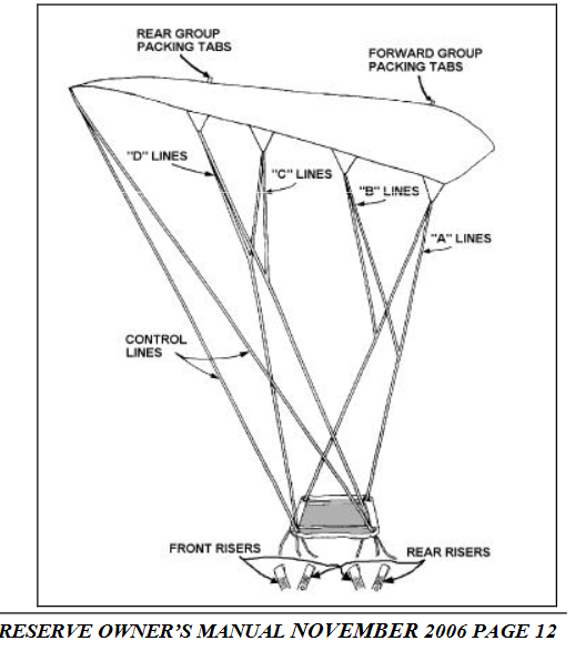

riggerrob 644 #3 May 2, 2021 Amusing how it attaches suspension lines to mini-flares. Note that these mini-flares are far broader than those used by Flight Concepts. They are conceptually more like the broad flares on Para-Foils and other early ram-air canopies. Quote Share this post Link to post Share on other sites
nwt 131 #4 May 3, 2021 On 5/2/2021 at 11:39 AM, riggerrob said: Amusing how it attaches suspension lines to mini-flares. Note that these mini-flares are far broader than those used by Flight Concepts. They are conceptually more like the broad flares on Para-Foils and other early ram-air canopies. What are flares in this context? Quote Share this post Link to post Share on other sites
gowlerk 2,296 #5 May 3, 2021 23 minutes ago, nwt said: What are flares in this context? They are the method of attaching the lines to the canopy using triangular pieces of fabric sewn into the bottom seam. They are used to distribute the load and in some designs also act as small keels and can replace stabilizers. As shown in this drawing of an FCI reserve canopy in side view. 2 Quote Share this post Link to post Share on other sites
