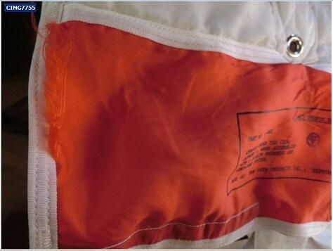

stratoflyer 0 #1 Posted April 15, 2021 Do you have any old gear stashed? How about a Freebag for a Javelin J3, DOM 1992? Seeking Replacement Javelin FreeBag and Repair to J-002 FB. Looking for a J-002 Freebag, size B or compatable to a 172 reserve. On mine, the pocket seam pulled from the edge on the short side, so a repair option is being explored through the manufacturer,,, but if a rigger wants to tackle this,, i'd run the option past the local who will be packing it.. Thanks SF75 Quote Share this post Link to post Share on other sites
riggerrob 644 #2 April 15, 2021 That can be patched without opening the side seam. Start with a piece of slider tape bigger than the tear. Secure the outboard edge by sewing a piece of slider tape on the outside. Make those rows of stitching directly on top of the stitch rows on the binding tape. Then sew the patch to the pocket. . Quote Share this post Link to post Share on other sites
