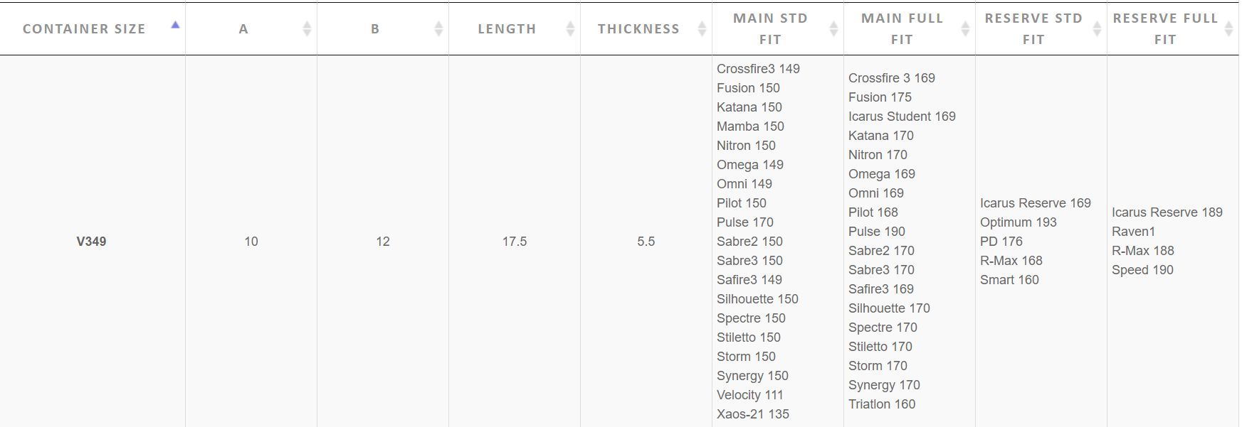

cbassmnm 6 #5 February 18, 2021 Thank you all for your insight and advice. Yes I was wanting to make my 2011 vector with closing loop on bottom into a wingsuiting rig. Smallest size it holds is a 150. It has the full fitting optimum 193 reserve. I was wanting to stay in the 150 size... smaller is cooler right? Anyway if I need to go Zp like a specter that’s what I’ll end up doing, but I do like the way the f111 material feels! Plus the bandwagon of the wingsuit specific canopies seems to be super crispy. I do jump a 120 regularly in my primary rig. Quote Share this post Link to post Share on other sites
20kN 93 #6 February 18, 2021 No, there is no real way to make them pack larger. They are intended for people jumping smaller canopies who want to put a larger main in their current container without buying a new container. You could take it out to the desert and then it would pack larger. You could pack it only in rooms with heavy A/C which reduces humidity and that will make it pack larger. Outside of that, nope not much you can do. I am curious how you fit a 120 into a rig with a 193 reserve. I'd imagine that main is swimming in there it's so small comparatively. Quote Share this post Link to post Share on other sites
Binary93 65 #7 February 18, 2021 3 hours ago, 20kN said: I am curious how you fit a 120 into a rig with a 193 reserve. Could be a V349 with a Velo or some other xb? Quote Share this post Link to post Share on other sites
Kenzdik96 26 #8 February 18, 2021 6 hours ago, 20kN said: I am curious how you fit a 120 into a rig with a 193 reserve. I'd imagine that main is swimming in there it's so small comparatively. I believe he said that his wannabe wingsuit rig is a Vector with an OP 193, and he is jumping a 120 in his primary rig (which he didn't specify the make, size, or reserve). 7 hours ago, cbassmnm said: Yes I was wanting to make my 2011 vector with closing loop on bottom into a wingsuiting rig. Smallest size it holds is a 150. It has the full fitting optimum 193 reserve. So with a Vector, you can't really do much with a bottom mounted closing loop in terms of over-shortening it (you will just wind up touching the grommets together), but you can have a go with a larger main Dbag, or having your reserve packed to be bottom stiff and push the AAD out. Alternatively, you can get a regular pack volume ZP wingsuit main like the WinX or Pilot7. ZP will give you better flight characteristics, and since you already have a rig that holds a 150 standard, and you want to put a 150 in it, you will really experience no benefits from going for an ultra low pack volume option. Quote Share this post Link to post Share on other sites
Binary93 65 #9 February 18, 2021 28 minutes ago, Kenzdik96 said: So with a Vector, you can't really do much with a bottom mounted closing loop in terms of over-shortening it At a certain point in time, Vector switched to a "Jav-like" closing loop location (inside, next to the reserve). I agree that with most Vectors it will be on the bottom closing flap, but posting these for awareness/completeness. Quote Share this post Link to post Share on other sites
Kenzdik96 26 #10 February 18, 2021 1 minute ago, Binary93 said: At a certain point in time, Vector switched to a "Jav-like" closing loop location (inside, next to the reserve). I did say "with a Vector, you can't really do much with a bottom mounted closing loop" I've known about that series, they did change it back to bottom flap rather soon though. Good info for the ones who didn't know about that series (without highjacking the topic and going into the pros and cons of both systems). 1 Quote Share this post Link to post Share on other sites
cbassmnm 6 #11 February 18, 2021 Kenz is correct. My main rig is as 120 with 160 optimum. This is for wanna be wingsuit or secondary rig. Ill end up getting zp 150, which it is suited for. Quote Share this post Link to post Share on other sites
