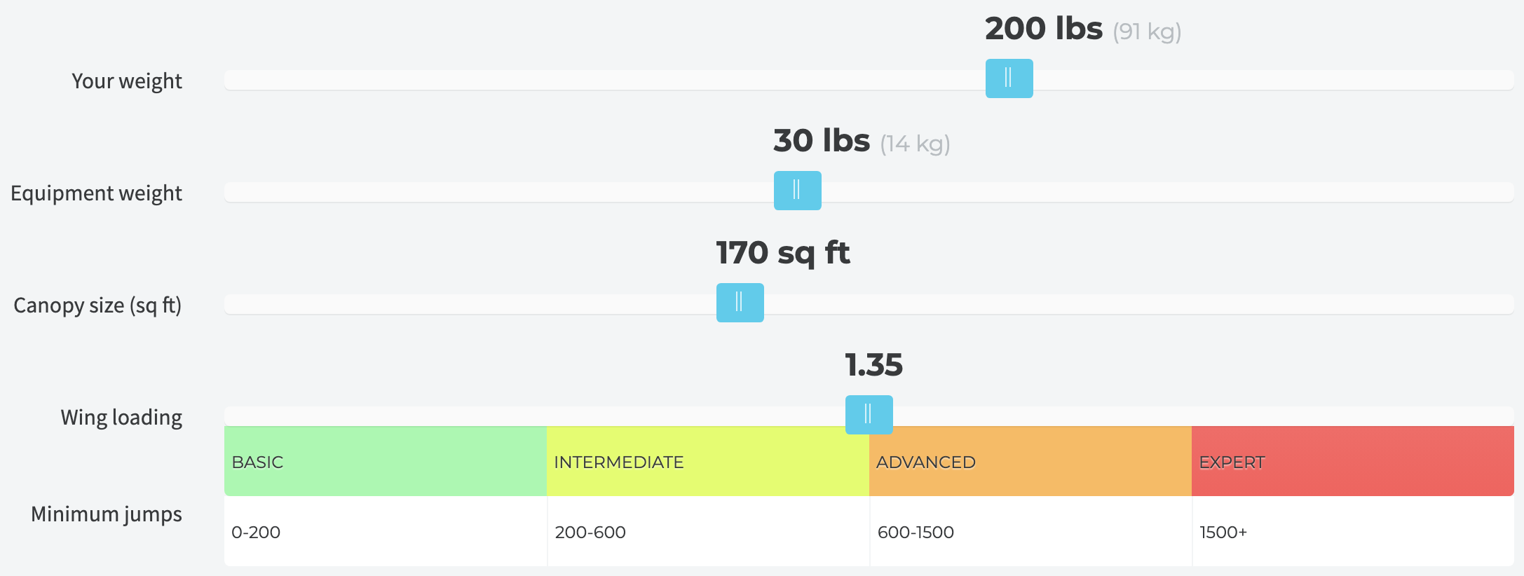

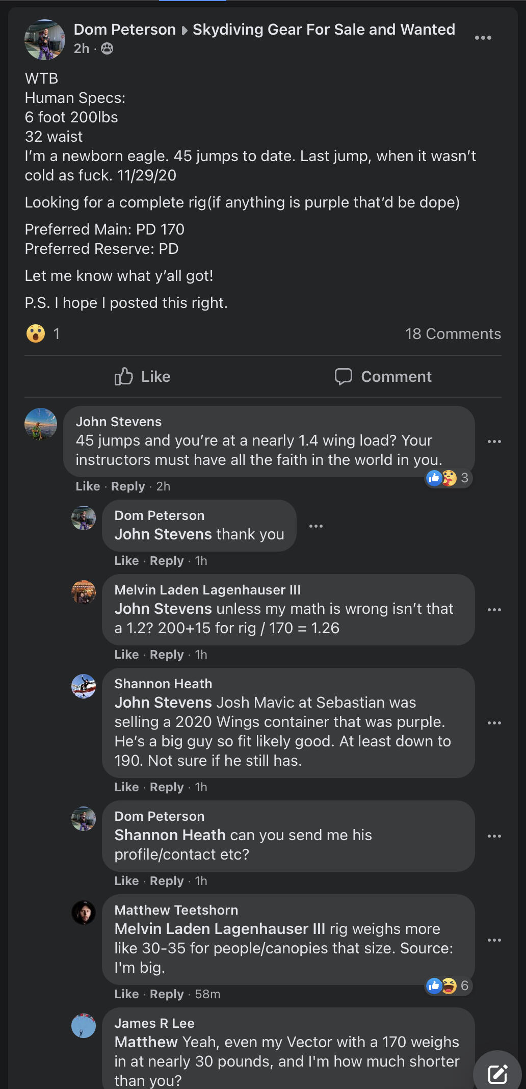

BMAC615 209 #1 Posted February 7, 2021 (edited) Skydive Cross Keys A License jumper on FB w/ 45 jumps weighing in at 200 lbs. + gear looking for a rig w/ a “PD 170.” Claims his instructors and coaches and S&TA have already had him on a 190 for the past 20 jumps and are guiding him to purchase a Pulse or Sabre 170. What are the coaches, instructors & S&TAs thoughts on this? Edited February 7, 2021 by BMAC615 Quote Share this post Link to post Share on other sites

base615 77 #4 February 8, 2021 I'm not an S&TA or AFF-I but I wouldn't be advising this for someone with 45 jumps and find it difficult to believe anyone with those ratings would be either: I have nearly 1200 jumps but, after a hiatus, I have similar jump numbers to him since returning to the sport. I'm feeling reasonably comfortable again but I've only got myself back to a wing loading lower than that (1.32) so far. I'd be very wary of the wing loading I'm currently on if I didn't have the previous experience to call on. The one saving grace might be that a 1.35 wing loading on a 170 is a bit different from a 1.35 wing loading on a 107 or 120 but I still don't think it's a very good idea. Quote Share this post Link to post Share on other sites
Kenzdik96 26 #5 February 8, 2021 (edited) Without knowing the skill of the person in question, and altitude/climate of the local dropzone, it seems excessive, but I can see the circumstances under which those would be considered acceptable. A lot of people don't have the money to change gear very often, so the idea was probably to get the guy a container that will be useful for a couple of future downsizes, providing he doesn't get hurt for the first 20-30 jumps while he is getting used to the canopy. If the local dropzone has rather constant winds, low altitude, and a C182 which limits the number of simultaneous people in the air to 4, it might not be the smartest idea in the world, but it isn't a catastrophic one. I would also recommend a Safire over a Sabre as it has a shorter recovery arch. While in the ideal world of the average person advocating safety on this website (conservative people with infinite money, strong safety culture, and highly regulated skydiving) this situation would be frowned upon and this person would be prevented from jumping that gear, we are living in the real world, and things often need to be optimized using more than one parameter (the likelihood of the jumper getting hurt). I have seen it very often that the first canopy a person buys at under 100 jumps is a 170 by default, regardless of a wing loading (and sometimes even a 150 with a very light person). Edited February 8, 2021 by Kenzdik96 3 Quote Share this post Link to post Share on other sites
BMAC615 209 #6 February 8, 2021 (edited) Thank you for your response. I think what I’d like to get a better understanding of is the philosophy that downsizing and increasing wing loading beyond 1:1 is necessary or inevitable - especially for someone with less than 100 jumps. I recognize having fun under canopy is part of the skydive, but, why do we have a culture of being able to rapidly downsize in order to land progressively smaller canopies? Edited February 8, 2021 by BMAC615 Quote Share this post Link to post Share on other sites
