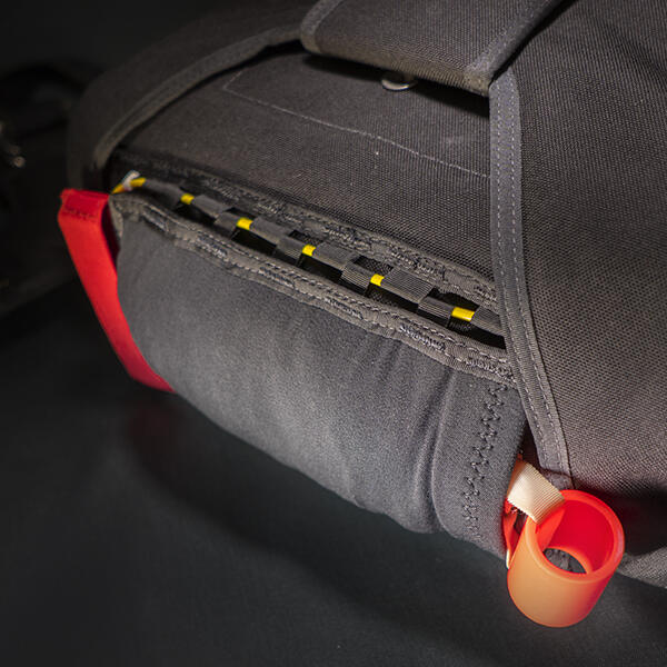

CoolBeans 11 #8 January 4, 2021 (edited) Some of the AFF rigs that I've seen have the BOC that can initiate deployment from right & left hand side. It's helpful if during first AFF jumps right instructor goes MIA and left one can still deploy. Can those rigs allow for flipping BOC 180 degrees without any rigging? Picture below. If it could be flipped, then @David Wang could potentially use existing AFF rental rigs without having to worry too much. Edited January 4, 2021 by CoolBeans Quote Share this post Link to post Share on other sites

David Wang 78 #11 January 4, 2021 1 hour ago, CoolBeans said: Some of the AFF rigs that I've seen have the BOC that can initiate deployment from right & left hand side. Hi CoolBeans, what is that red thing on the left side BOC? Do you mean reserve side instructor can deploy the main by pulling that? Interesting... 55 minutes ago, skytribe said: Get your shoulder fixed. I'm doing it! I'm seeing a sports ortho this week to see how much damage there is and see if surgery is needed. If a surgery is needed, I will do it. if I don't need surgery, I will do PT to strengthen my shoulder up. Or I can still use right handed rig...I will need to do practice pulls in the wind tunnel to test my right shoulder out! Is SOS system a better idea than left handed BOC? 53 minutes ago, wmw999 said: Perris is a big and very busy place -- hopefully someone there can spend some time with him if he shows up on non-busy days and hangs out helping. Thank you Wendy, and I saw your private message as well. I have tried to communicate with jumpers at Perris via Facebook but not much help...Seems like not showing up in person can cause difficulties.I can't be there every weekend because of school but I will try to be there these months. Quote Share this post Link to post Share on other sites

mark 107 #15 January 4, 2021 (edited) 4 hours ago, CoolBeans said: Some of the AFF rigs that I've seen have the BOC that can initiate deployment from right & left hand side. It's helpful if during first AFF jumps right instructor goes MIA and left one can still deploy. Can those rigs allow for flipping BOC 180 degrees without any rigging? No. In particular, in your photo, pulling the red handle detaches the pilot chute pouch with the pilot chute still inside it. If you pull and throw the red handle, you'll have a pilot-chute-in-BOC in tow. Edited January 4, 2021 by mark Quote Share this post Link to post Share on other sites
dudeman17 376 #16 January 4, 2021 39 minutes ago, mark said: In particular, in your photo, pulling the red handle detaches the pilot chute pouch with the pilot chute still inside it. If you pull and throw the red handle, you'll have a pilot-chute-in-BOC in tow. That's not accurate. 5 hours ago, CoolBeans said: Some of the AFF rigs that I've seen have the BOC that can initiate deployment from right & left hand side. It's helpful if during first AFF jumps right instructor goes MIA and left one can still deploy. 3 hours ago, David Wang said: Hi CoolBeans, what is that red thing on the left side BOC? Do you mean reserve side instructor can deploy the main by pulling that? Interesting... What that handle does is open the top of the BOC. The bottom seam is still attached to the container. When the reserve side AFF-I pulls that handle, it exposes the pilot chute. The wind usually deploys it, but if it hesitates in the burble the instructor can grab it and throw it. It would not be suitable for a self-deployed left handed pull. 2 Quote Share this post Link to post Share on other sites

CoolBeans 11 #18 January 5, 2021 2 hours ago, dudeman17 said: What that handle does is open the top of the BOC. The bottom seam is still attached to the container. When the reserve side AFF-I pulls that handle, it exposes the pilot chute. The wind usually deploys it, but if it hesitates in the burble the instructor can grab it and throw it. It would not be suitable for a self-deployed left handed pull. After pulling the red handle - can it be assembled back 180 degree flipped? So that way it would become a left hand side rig. Quote Share this post Link to post Share on other sites

CoolBeans 11 #25 January 7, 2021 6 hours ago, skydude2000 said: (...) he had a local rigger convert one of his rental rigs to a dual BOC, so it could be packed for either side. I want to see pictures of that invention! Was it one BOC on top of another? Or one BOC with openings on both sides? Quote Share this post Link to post Share on other sites
