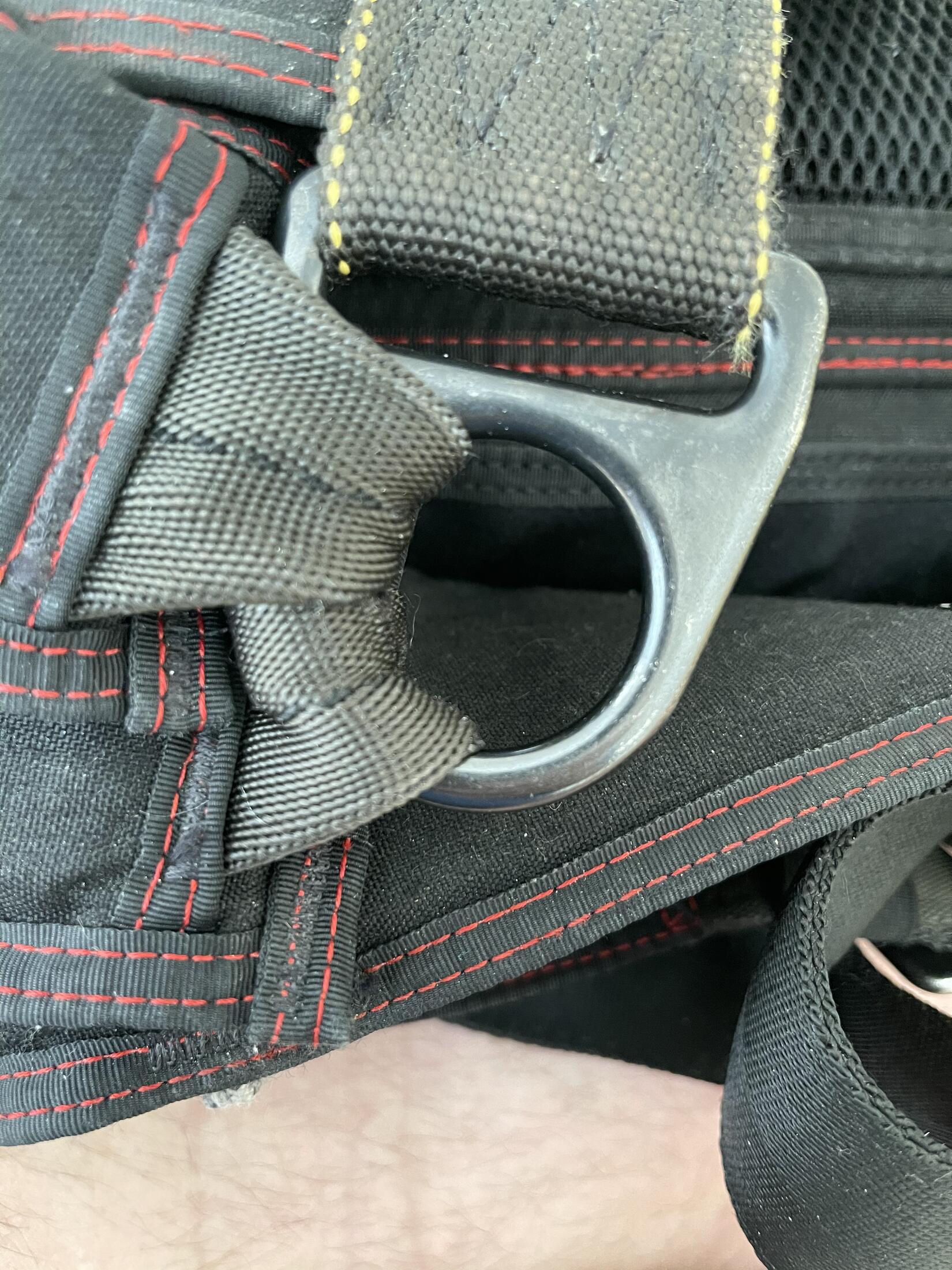

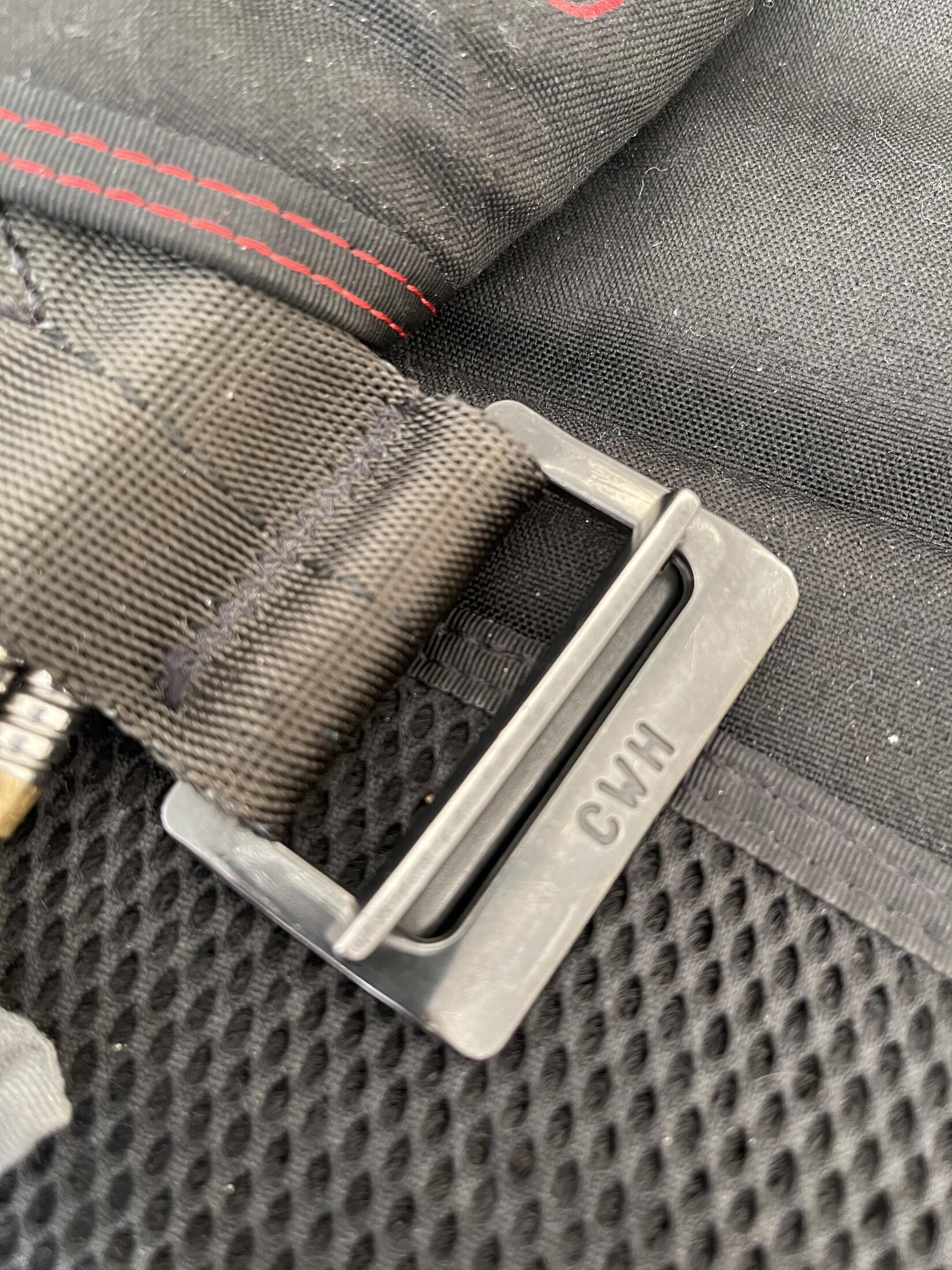

FataMorgana 0 #8 December 22, 2020 Here are some pictures of the black hardware from UPT (Vector) after 5 years of jumping and ~1000 jumps. It still does look cool IMHO. Also, there is absolutely no damage to the webbing that came in contact with the oxidized surface of the hardware. Quote Share this post Link to post Share on other sites

gowlerk 2,277 #11 December 22, 2020 (edited) 30 minutes ago, Kenzdik96 said: You would think so, but I have seen some rigs (15+ years old) where the hardware seemed almost destroyed, if I had to guess, I would say rings looked like they were exposed to salt water and corroded because of it. I have also seen 20+ year old rigs where hardware looked new. I don't know if some manufacturers use something other than stainless for the rings? I have seen rigs with cadmium plated hardware ruined by rust. This was the standard type used for many years. The plating resists rust, but not in all conditions. It can also wear off and leave the steel underneath exposed. I have not yet seen rusty stainless steel on a rig. But i'm sure it can happen in some environments. I have also seen the black plating wear off a little, particularly on the large riser ring where it rubs on the middle ring. It is typically hard to see, it doesn't stand out. Overall the black coating, whatever it is, seems to be pretty long lasting. Edited December 22, 2020 by gowlerk Quote Share this post Link to post Share on other sites
