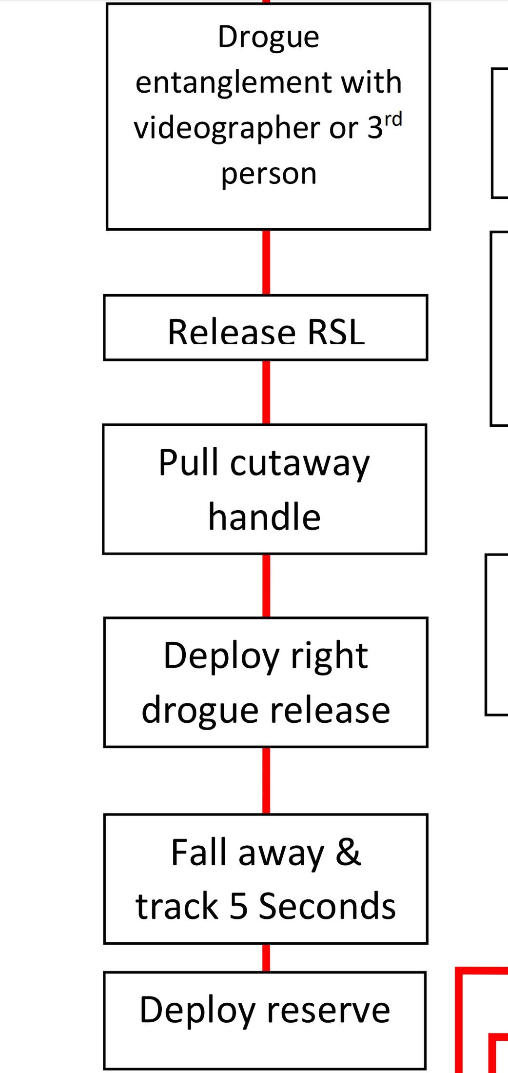

Binary93 65 #2 September 22, 2020 From SIGMA manual the TI procedure is clear I guess, so the cameraman should wait for the cutaway and then track? 3 Quote Share this post Link to post Share on other sites
husslr187 24 #3 September 22, 2020 (edited) if the drogue is inflated with someone tangled up in it, the cameraman is not tracking anywhere. but yes the TI duty is the safety of the student so they will chop it and it will be all your problem. Edited September 22, 2020 by husslr187 editing words to be a bit more clear 1 Quote Share this post Link to post Share on other sites
Binary93 65 #4 September 22, 2020 Thanks, I was asking more towards what should the cameraman do. Wait for the cutaway, then try to track (or if that's impossible with an inflated drogue proceed to cut the bridle immediately after TI cuts away)? Quote Share this post Link to post Share on other sites

husslr187 24 #7 September 23, 2020 there’s way too many variables to have one solid answer. the only thing consistent in this situation is there is a person entangled with the drogue. do whatever you can to make the situation better, equipment can be replaced. chances are the TI will chop before you exhaust your other options to free yourself and reach for your knife. at that point do whatever you need to, to live. they won’t be happy if you cut their equipment but they’ll be even less happy if you burn in. Quote Share this post Link to post Share on other sites
husslr187 24 #8 September 23, 2020 one other thing I thought about is AFTER the TI chops his main you have a situation very similar to a horseshoe malfunction and you can treat it as such. only exception is you still have a main and reserve. two trys then deploy main. it would probably be easy to lose altitude awareness in this situation so this is likely your best bet 1 Quote Share this post Link to post Share on other sites
