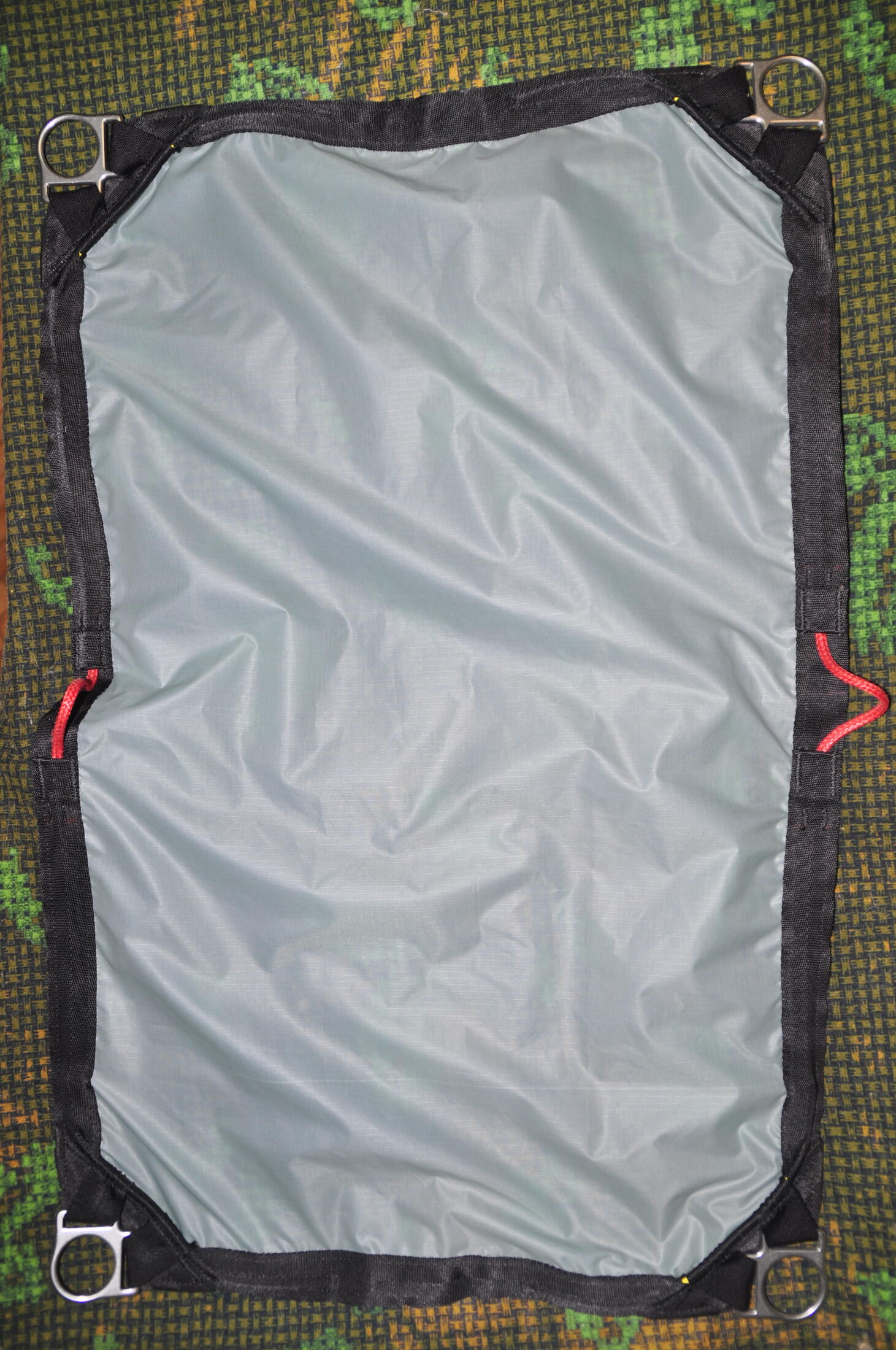

Veis 29 #7 December 10, 2020 (edited) The NEW RDS removeable Slider from hardcore Russian swoopers (no bears was hurt!) Developed for terminal deployment. It can be manufactured in any size specified by the customer, and costs about $150. Full version (prototype) has a different design, we strongly dislike traditional separate lines for the bridle connect. Edited December 10, 2020 by Veis 1 Quote Share this post Link to post Share on other sites

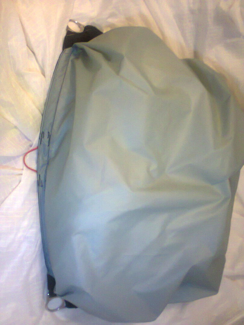

Veis 29 #8 September 4, 2021 New semi-domed version of RDS available. Quote Share this post Link to post Share on other sites

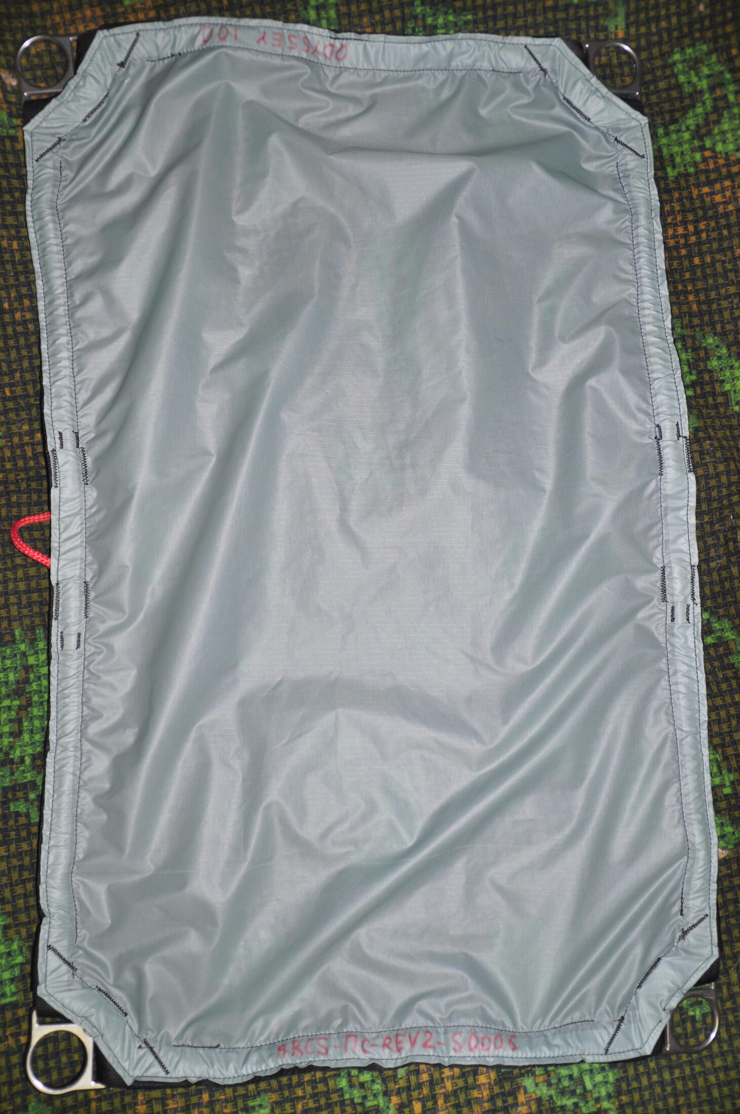

Veis 29 #9 September 18, 2021 Newest SUPER-domed available! Quote Share this post Link to post Share on other sites
Veis 29 #10 September 18, 2021 To the question "full RDS vs. slider only". During the tests, we saw the situation of wrapping and blocking the opening by the "full-RDS" bridle link in the terminal deployment, a high-speed failure and an almost inevitable cutaway. Be careful! 1 Quote Share this post Link to post Share on other sites

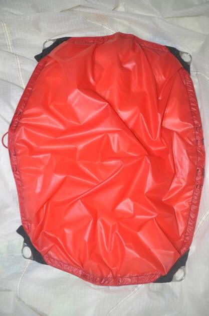

Veis 29 #11 January 31, 2023 More RDS, Evo-Odyssey. Quote Share this post Link to post Share on other sites
