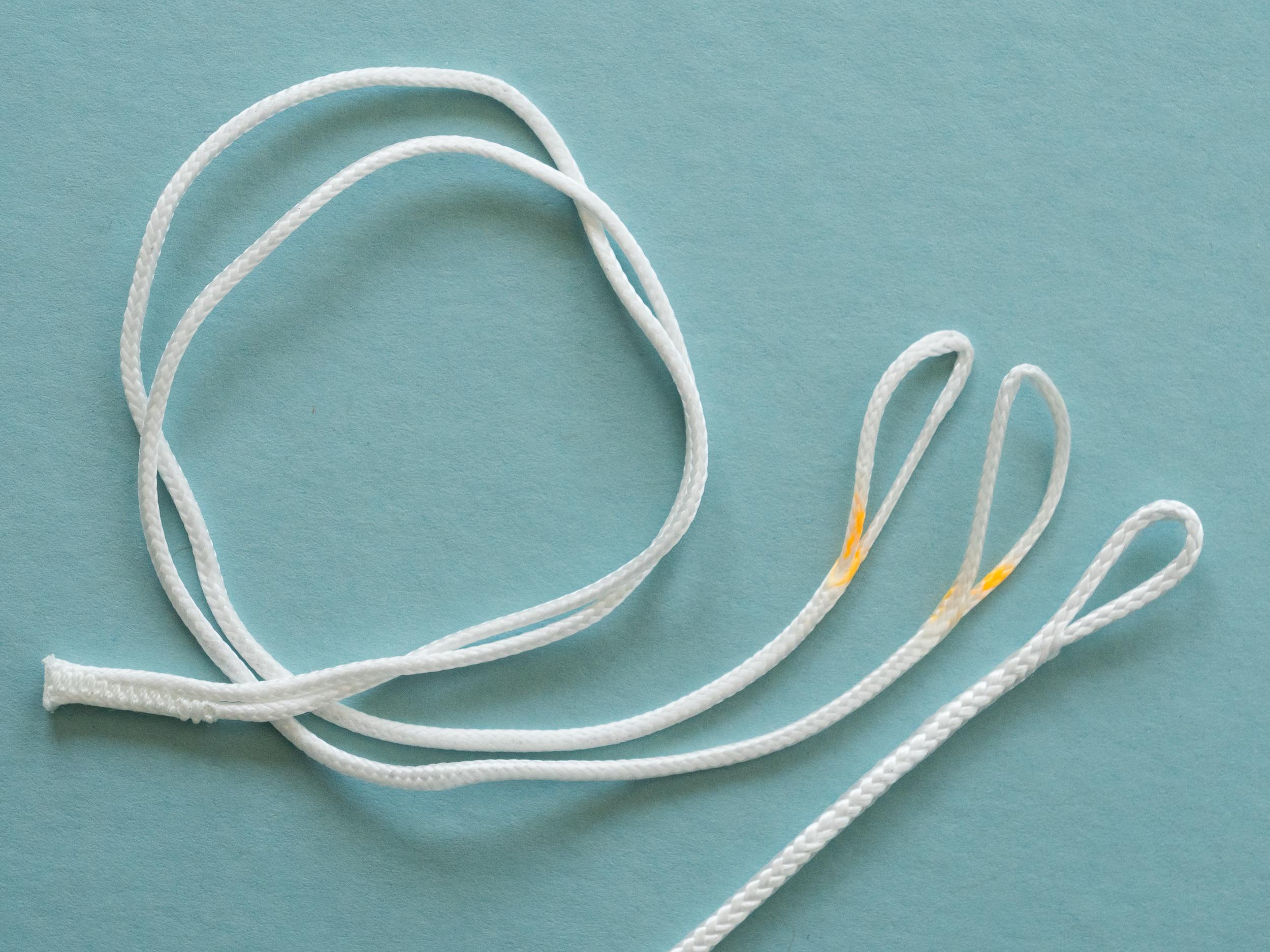

Divingdude 1 #7 June 11, 2020 (edited) Yes, this was before the Collin's lanyard and was intended to solve the issue of the non-RSL-connnected riser not releasing properly. (or the RSL-connected one breaking and activating the reserve without a cut-away first) With two RSLs, two pins, and two loops the reserve container wouldn't open until both risers had released. The loop material was crazy thin, see attached image. Regular Cypres loop at the bottom right for comparison. The "LOR2" loops (as they were called) came sewn together in a pair of precisely the same length, but it was quite awkward to adjust the length and set them up in the Cypres washer and still keep the same length. They were so thin that it felt that you only had one chance to close the container. After one go at it, you feared that you might have worn them down slightly to the point where it wouldn't be advisable to use them any more. There was another funny detail that I recall. Only one of the RSLs was hooked up with a Swede-link that could be opened quickly. The other one was attached to the riser with a rapide link, i.e., quite cumbersome to open if you are in a hurry. So, in the event of a landing in strong winds you could unsnap the one RSL, chop the main, and avoid being dragged across the ground. However, the other riser would pull its pin as the main left and you would have to get the rig repacked! Trying to reinsert the pin in the very thin and fragile loop would not be a good idea, if even possible (I never had the opportunity to try). Edited June 11, 2020 by Divingdude 1 Quote Share this post Link to post Share on other sites

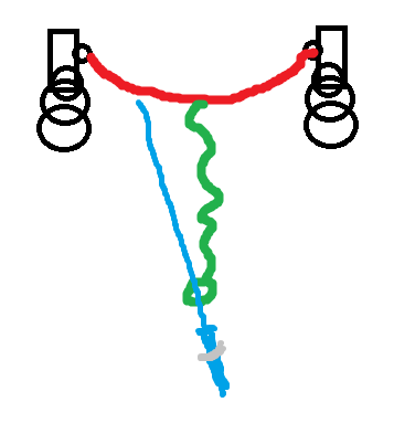

JerryBaumchen 1,484 #14 June 14, 2020 3 minutes ago, Binary93 said: Thanks for that, I was sure those two were the same thing. Any chance you could explain the difference in words or a picture (not sure if I'd be hogging the thread but I guess there might be others confusing these two)? Hi Binary, I'll try. The Jump Shack design used a cross connecting lanyard that goes around the back of the jumper's neck, on the container. This what a lot of people consider the problem with their design. The French system just uses two lanyards, one from each riser. No cross connector. I do not have any photos to show. Anyone?????? Jerry Baumchen Quote Share this post Link to post Share on other sites
Binary93 65 #15 June 14, 2020 Something like this? (red being the cross connecting lanyard, blue being the reserve rip cord)? If so, this would mean that if one riser releases, it will stay connected to the other one before deploying the reserve? (Not sure if I understood you correctly, but it fits their "release RSL on one side before cutaway" requirement). Quote Share this post Link to post Share on other sites
JerryBaumchen 1,484 #16 June 14, 2020 8 minutes ago, Binary93 said: Something like this? (red being the cross connecting lanyard, blue being the reserve rip cord)? If so, this would mean that if one riser releases, it will stay connected to the other one before deploying the reserve? (Not sure if I understood you correctly, but it fits their "release RSL on one side before cutaway" requirement). Hi Binary, That is pretty close; nicely done. IMO the problem is: ' . . . "release RSL on one side before cutaway" requirement).' That simply requires too much of the jumper when encountered with a malfunction. Jerry Baumchen 1 Quote Share this post Link to post Share on other sites
