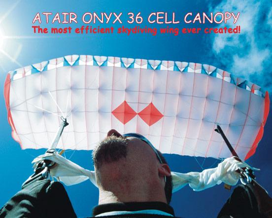

pchapman 280 #8 March 10, 2020 (edited) What Skylark is doing looks nice. The crossbrace design reminds me of the Atair Onyx of around 2002 - one over-hyped canopy even if some aspects were inventive. Two sections on the bottom surface become 4 sections on the top surface. Edited March 10, 2020 by pchapman 1 Quote Share this post Link to post Share on other sites

GoneCodFishing 24 #10 March 10, 2020 (edited) Skylarks approach is a really elegant solution to provide shaping and rigidity to a canopy, Atair's however i always thought it to be a pretty impressive feat given they probably didn't have much in the way of 3D software to get the patterns dialled. The amount of trial and error involved when sewing those must have been huge. (Edit: Thinking more about it, they probably designed it with ribs on and then just removed them?) The rib design in those Phantom paragliders are really interesting. A bi-cell bracing nested inside a tri-cell to give a quad cell. (Edit: I'm making the names up. Don't know if there's an actual name for that) Clever the way they run the fabric threaded through the holes! Interestingly the bi-cell type seems to run at 45 degrees tying with what Mark mentions above regards angles Edited March 10, 2020 by GoneCodFishing 1 Quote Share this post Link to post Share on other sites
