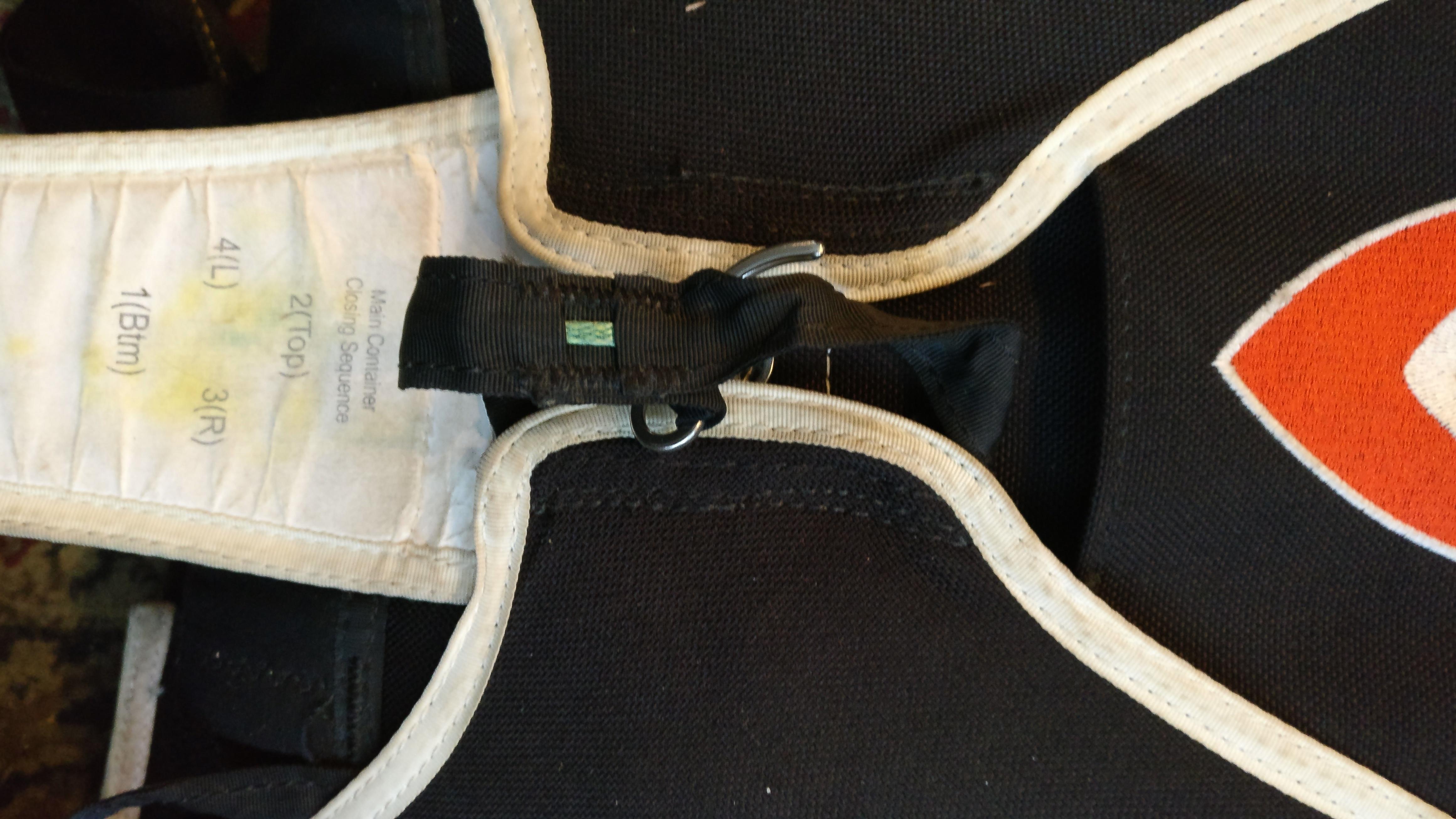

TommyM 3 #13 February 22, 2020 Interesting video. Here is a pic of my closed rig. I use the alternate closing method and don't tuck the bridle in under that corner. I think I like the alternate method even more. Notice the lower corner of my flap, it has a slight bend. Rig has about 200 jumps on it. 1 Quote Share this post Link to post Share on other sites
