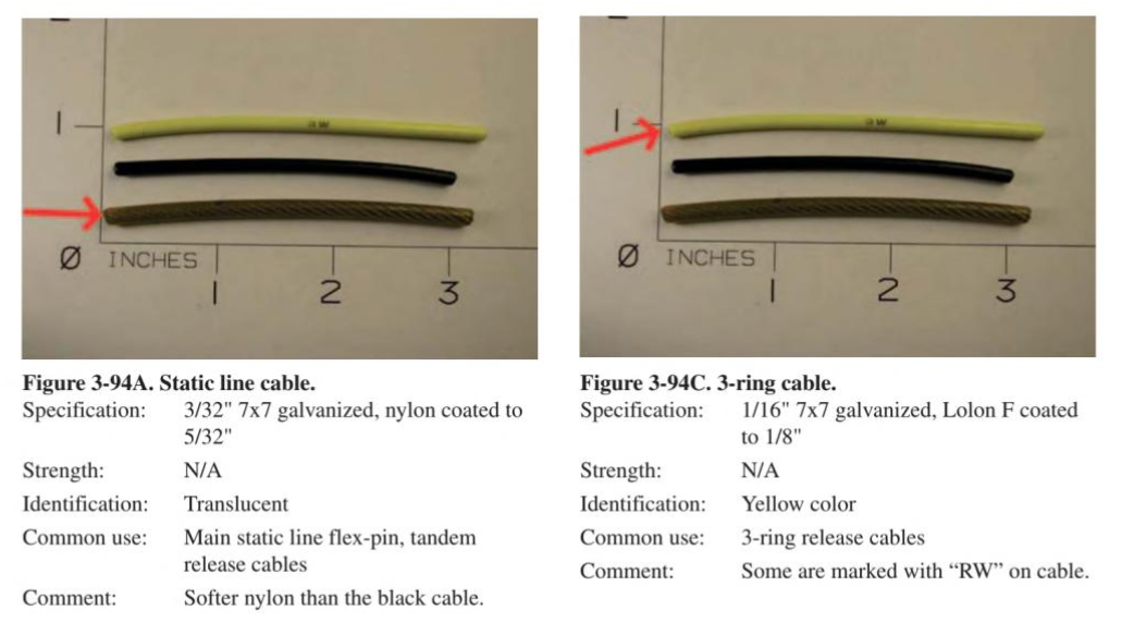

Binary93 65 #8 January 27, 2020 In the Parachute Rigger Handbook is the following image. I'm not 100% sure but I think I saw the yellow 3-ring cables as pins for the static line. Is this something that's okay or something that should be strongly avoided? (I'm not a rigger, just trying to learn) Thanks! 1 Quote Share this post Link to post Share on other sites
evh 22 #9 January 28, 2020 I have seen both the yellow and the transparent version used for staticlines, but not the black ones. 2 Quote Share this post Link to post Share on other sites
wolfriverjoe 1,523 #10 January 29, 2020 It's been a while, but my old DZ had two Wings student rigs (purchased new in 03 maybe). S/L, freefall, even had a setup for a reserve side release so it could be used for AFF. The freefall could be setup as a throw-out or a spring loaded PC ripcord. The ripcords were the black stuff. The S/L were direct bag, with the pin on the S/L being the black stuff too. Not sure if they could be set up as Pilot Chute S/L rigs or not. If they could, we never did. 1 Quote Share this post Link to post Share on other sites
riggerrob 644 #11 January 30, 2020 Black-coated cable is stiffer, ergo better with spring-loaded pilot-chutes. Black-coated cable is stronger than needed for S/L. Most S/L rigs use flex-pins made of clear-coated cable. Quote Share this post Link to post Share on other sites
