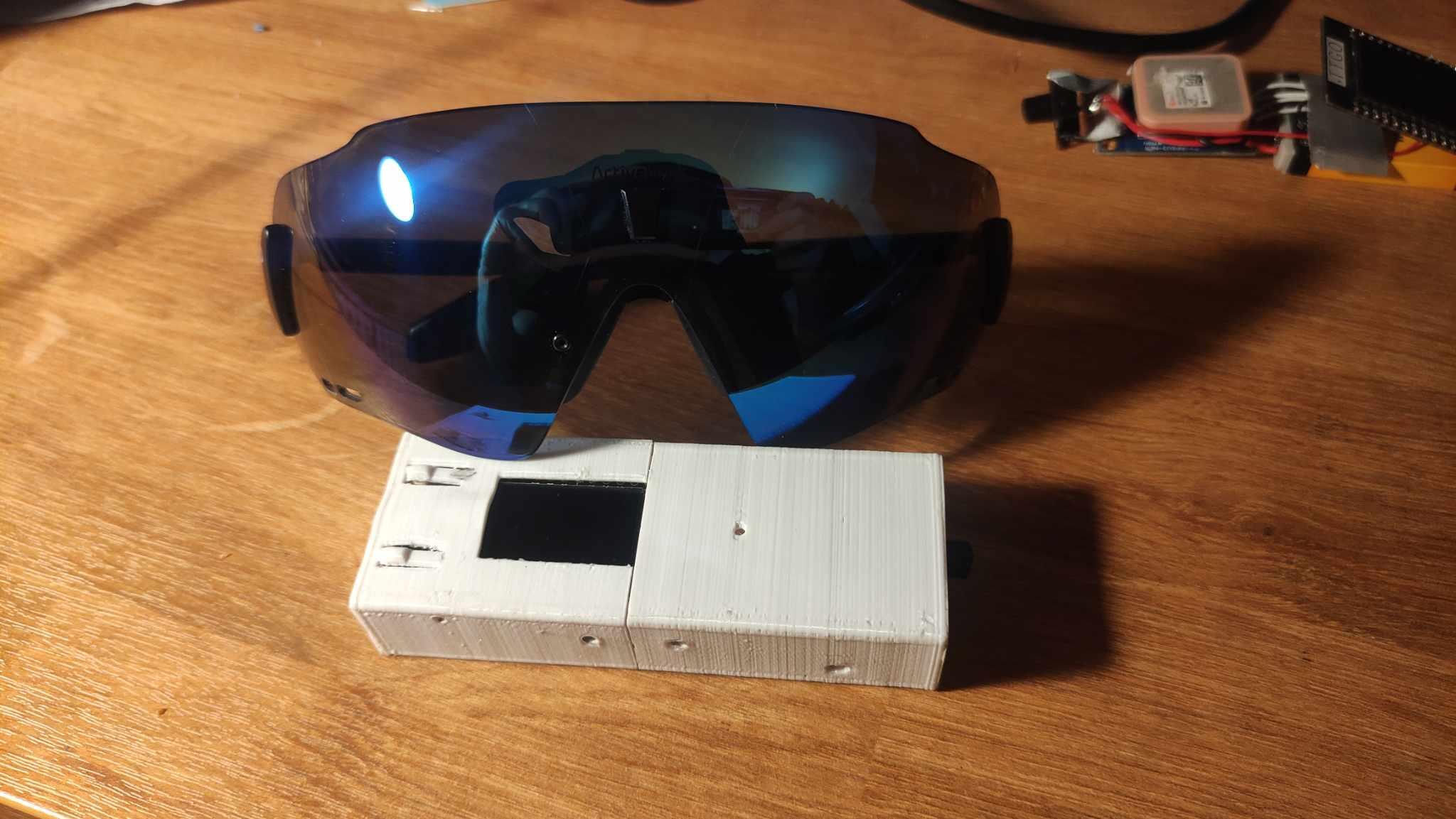

I've pretty much settled on hardware configuration. There's still some space for optimization (like size for example) but that shouldn't affect the codebase too much.
ENGO 2 indeed pretty good for this purpose. Although there was no SDK for ESP32, I was able to write some basic implementation using the documentation available.

So far this prototype that can display whatever data I need, and I'm working on different layouts and overall stability.
Since the device doesn't have a barometer, the altitude is based on GPS. It has some pros and cons:
+ Displays real altitude relative to the ground (after MSL/AGL offset is stored in memory via corresponding menu)
+ Burble does not impact readings - true altitude displayed regardless of back/belly position
+ You see the same altitude as the one used by judges during scoring ( because Exit and Start/Finish gates are read from GPS, and AGL offset if preset in the beginning of competition) - last year during championship there was a case when Visio and FlySight altitudes were different by few hundred meters, and competitors were to exit an aircraft at 3700m AGL according to GPS, not barometer reading
- If signal is weak (i.e. too few satellites in view) the altitude readings swing back and forth by astronomical margins (sometimes as much as 400m) - I'm working on improving signal reception
With time I'll release a web-tool for creating custom layouts so anyone could see whatever they want (actually, the tool is already in working state, but now I need to implement support for JSON definition of layouts)

When I started, there was nothing of that kind, so through trials and errors it's now where it is.  Smartphones aren't good enough because their GPS is too slow (only 1 reading per second).
Since I don't have Garmin watch I can't comment on that.
ActiveLook became available only about a year or two ago, but when this project has started there was no hardware on the market that could provide the solution at a reasonable price and scalability.
Yes, FlySight 2 has technical capabilities of working with ActiveLook, it's only a matter of firmware update. Although its UI will be a bit cumbersome because there's only 1 button on FlySight and proximity sensor on goggles (which doesn't recognize swipe directions, only that there's a swipe). Or it will rely on config files that have to be uploaded from PC.
I've been considering making custom firmware for FlySight but at this point it's faster for me to experiment with the code I already know because functionality is constantly changing.
Who knows, maybe at some point it will be merged into FS.
