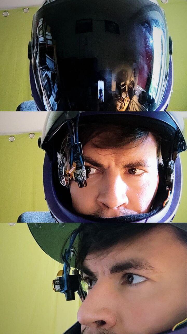

the.Legend 55 #28 August 26, 2021 Yes, I'm perfectly are of that problem. I'm trying to overcome it by combining screen big enough so that even blurry text/numbers at close distance are readable, and putting it as far as possible for the best results. So far sticking OLED to the visor on the outside seem to be good enough. That's why it has to be transparent - big screen obscures more view. Also it's placed not directly in front of an eye, but at the bottom and to the side - again to get more distance and obscure less view. LilyGo TTV has arrived about a week ago and actually I'm quite impressed with what they've managed to squeeze in such a small package - it even has WiFi! And plenty of power in the processor, so with time the functionality could be extended. I've hooked up the GPS and it works, now I'm sorting out few technical challenges * Extend wiring so that unit could be hidden in one of audible pockets * Test with different batteries. The stock one is too small, it lasted for just about 1-2 hours working only as a display. For that I had to hook up GPS module to external battery with higher voltage * There's 5-10 seconds delay in GPS readings - displayed speed lags behind actual speed. Likely some bug in the code. Same GPS module on Arduino had better reaction time In few days I'll post an update with link to GitHub for anyone interested 1 Quote Share this post Link to post Share on other sites

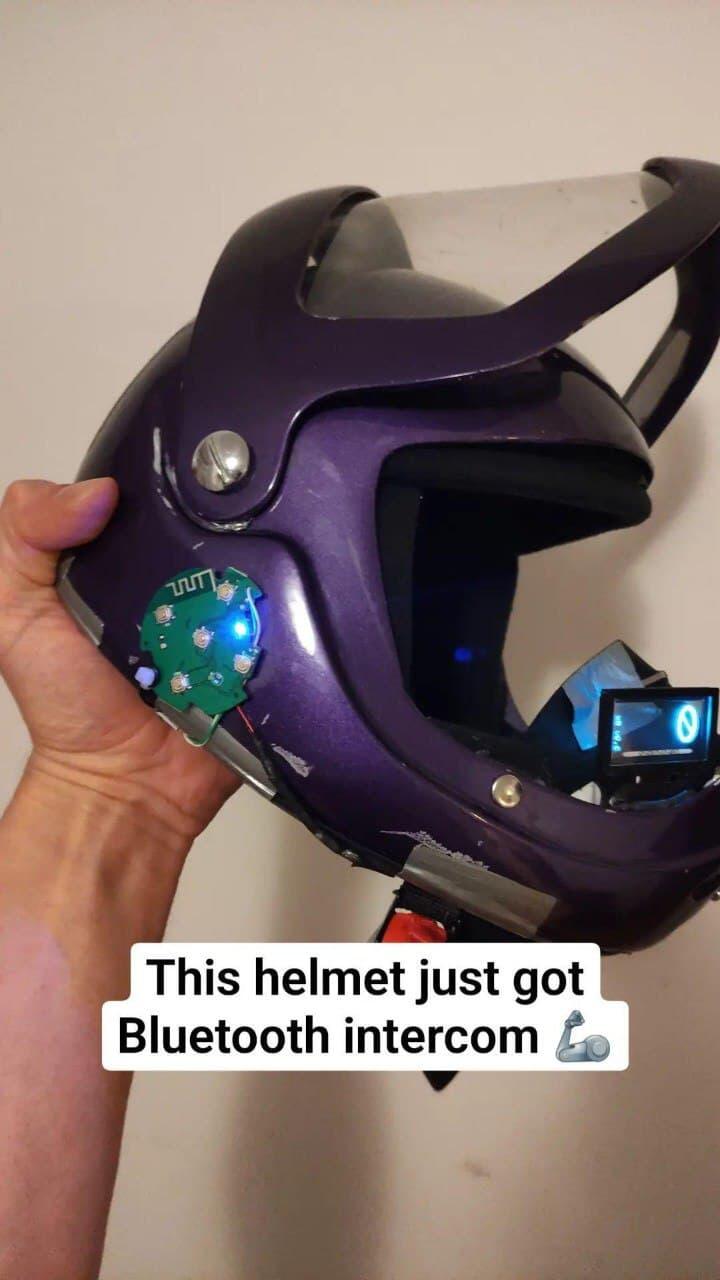

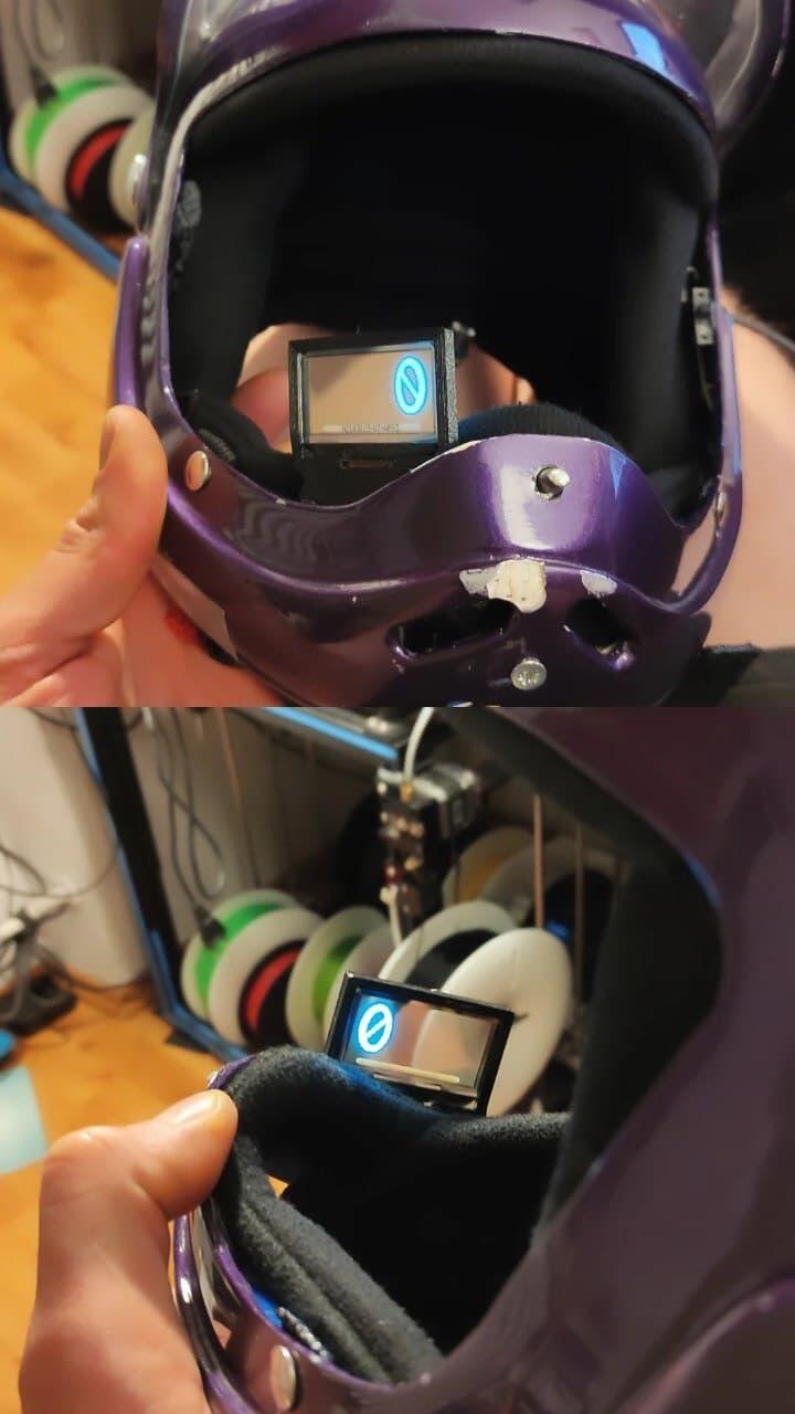

the.Legend 55 #30 September 2, 2021 (edited) Prototype ready and assembled. I tested it today riding a bicycle in cloudy weather and it was readable. In bright sunlight this OLED is too weak on its own, but it could be improved by putting some tinted tape on the back of the frame, or in worst case a piece of duct tape. Will be testing it this Saturday, hopefully, it will be able to catch up with readings. GPS module is rated up to 5 Hz (similar to FlySight) so if anything, the bottlenecks would be in the code. I'm wrapping up the documentation & source code, will post it after field tests Edited September 2, 2021 by the.Legend 2 Quote Share this post Link to post Share on other sites

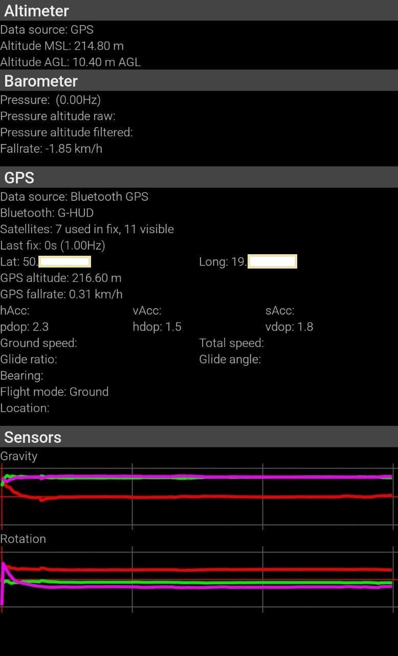

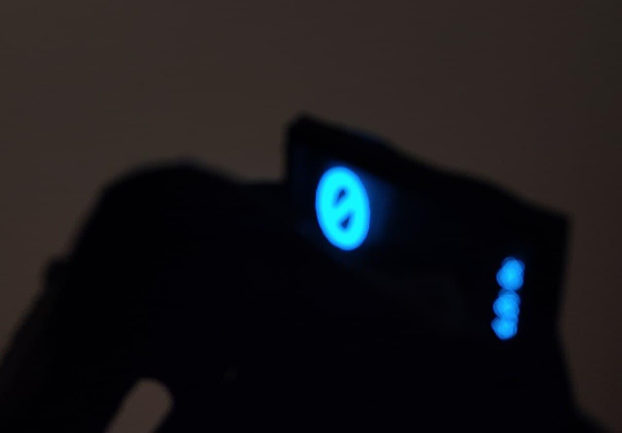

the.Legend 55 #36 September 5, 2021 The unit has been tested through the weekend and I'm really happy that it worked! Unlike previous attempts, when proprietary GPS units couldn't handle freefall, this time GPS data was displayed during all phases of the flight. Update was to 250ms and unit reaction time was pretty accurate. GPS unit rated up to 5Hz, with time it will be upgraded to 10Hz (same as in FlySight) I didn't have time to order tinted tape, so I put black one on the back, and on a bright day digits were readable no problem at all. Despite digits being blurry (the image attached is pretty close to what's in reality) it was easy to read them during the flight. Display is not distracting and could be looked at with quick eye movement. You might need some practice on the ground first just to get used to it, but then during the flight it didn't take an effort to check speed. As promised, basic source code and hastily written assembly instructions: https://github.com/RomanTheLegend/WingsuitGps Contributions are welcome because I won't have enough time to develop this project at a good pace, and there are few quite complex functions to be implemented. Next on the ToDo list: * Make few more units for my friends for wider testing and feedback (mid-October because shipping is only from China) * Make 3D models and wiring cleaner and leaner * Explore the possibility of attaching some control switches - that would allow to write some kind of menu interface in the future P.S. I got carried away a bit and added Bluetooth intercom made from old cheap headset while at it. This helmet gets more and more advanced 2 Quote Share this post Link to post Share on other sites

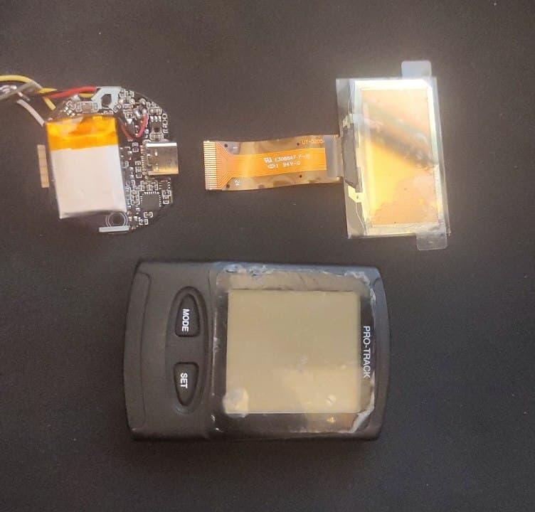

the.Legend 55 #42 December 17, 2022 It's been a year since the last update, eh? Fear not, the project is still moving forward! Now that there's more free time in winter I hope to catch up on what was delayed. Actually, there was another reason for delay - I switched to new display type and then spent countless hours banging my had against the wall trying to figure out why suddenly the image was distorted, but I can say with confidence it was worth the effort. The new display solves the problem of blurry image as well as it lets me display more information at once. Also due to it's size it's nicely positioned in front of the eye and fits under visor (it'll look even cleaner and slimmer once all the boards are hidden) One more benefit of the new display is adjustable focus, meaning people with vision complications can adjust it to their needs raw changes: https://github.com/RomanTheLegend/WingsuitGps/tree/composite_display Two primary tasks for the nearest future are 1) Improve the UI 2) Implement WS competition mode. Now that everything on the screen is clear and readable, I can implement visual gauges to display distance to the gates and deviation from the flight path. But this feature would take some time because reliably detecting the moment when competitor leaves the plane would be tricky. I think of implementing Kalman filter on data stream to detect true-positive downwards acceleration. If anyone has the experience with these please lend me a hand (preferably, in form of github merge requests :) ) P.S. I've been thinking of changing the project name to FlySense. Why? Well, if FlySight doesn't display a thing, calling it FlySense sounds logical because you won't feel anything either. P.P.S. The more I work with ESP32 platform the more awesome possibilities I'm discovering. Potentially, FlySense will be able to replace Sena/Cardo intercoms in the distant future https://docs.espressif.com/projects/esp-idf/en/latest/esp32/api-reference/network/esp-wifi-mesh.html#mesh-self-organized-behavior . Very distant future because the scope of work is huge 1 Quote Share this post Link to post Share on other sites
