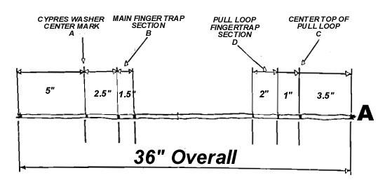

airnutt 11 #1 Posted October 16, 2019 I have a reflex that has come in for a repack and I'm looking for dimensions to make a reserve closing loop.any help would be appreciated. Quote Share this post Link to post Share on other sites

gowlerk 2,273 #3 October 16, 2019 1 hour ago, airnutt said: I have a reflex that has come in for a repack and I'm looking for dimensions to make a reserve closing loop.any help would be appreciated. Here is the drawing with the dimensions. Quote Share this post Link to post Share on other sites

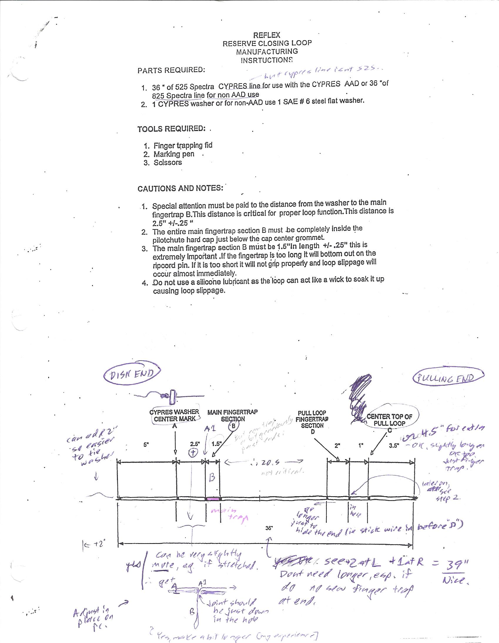

gowlerk 2,273 #4 October 16, 2019 (edited) 38 minutes ago, RiggerLee said: Don't you have the manule? All of this must be in there. The dimensions are not in the manual. But there is a note in it that they must be made pretty exactly. Better instructions are in the attached HTML file. Reflexclosingloop.htm Edited October 16, 2019 by gowlerk Quote Share this post Link to post Share on other sites
mark 107 #5 October 16, 2019 The only critical measurements are the ones marked 2.5" and 1.5". The 2.5" measurement is the distance from the grommet on the edge of the cap to the grommet in the center. This distance must be long enough that the fingertrap section is entirely below the center grommet. The 1.5" fingertrap section used for loop length adjustment can be a little longer if pack thickness allows, but cannot be any shorter without risking loosening during the pack cycle. Instead of the usual Cypres knot, you can make a small (0.5" I.D.) loop at the end of the closing loop, and secure using the no-sew method. The length of the fingertrap for this small loop should knot exceed about 2", so it won't interfere with the fingertrap section used for adjusting loop length. Larks-head the small loop to the Cypres washer to get a more solid anchor than the usual double-overhand + single-overhand. Quote Share this post Link to post Share on other sites
gowlerk 2,273 #6 October 16, 2019 (edited) 35 minutes ago, mark said: The 1.5" fingertrap section used for loop length adjustment can be a little longer if pack thickness allows, but cannot be any shorter without risking loosening during the pack cycle. Yes, this is where I always use the +/- .25 inch on the plus side. I've found that 1.5 inch is not quite enough to hold, but an extra 1/4 goes a long way. Even so, in the student size Reflex we were using the cap would still need to be tightened at least once a season. I'm not sure that you can do it on a smaller one though. Edited October 16, 2019 by gowlerk Quote Share this post Link to post Share on other sites

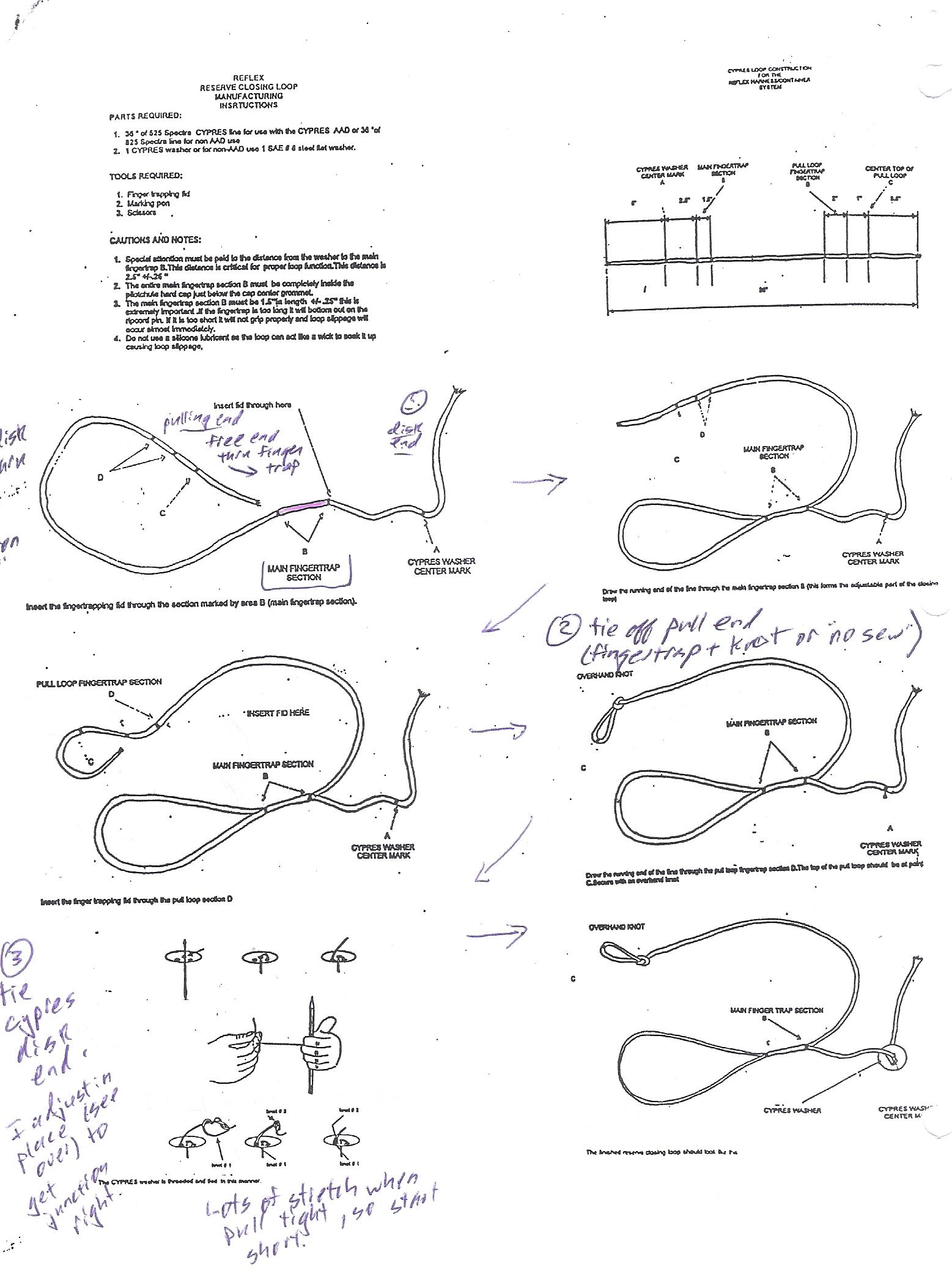

pchapman 279 #8 October 17, 2019 While we are sharing Reflex loop info, here's more: 1. Basically the same thing but from the Trident folks who I guess took over the TSO later. At least that shows updated manufacturer info is the same. 2. A two page instruction set unlike the single sheet one seen so far. It has some early scribblings of mine all over it, which can either be distracting or useful. When I first had to build the loops, it was all a bit confusing what each of those A,B,C,D and other marks or sections would correspond to in the final assembly.... Quote Share this post Link to post Share on other sites
