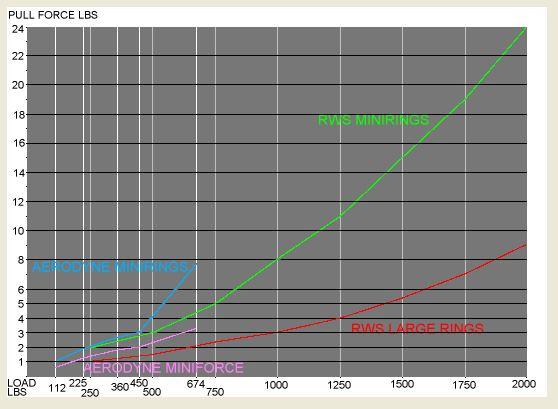

sundevil777 102 #1 Posted September 29, 2019 (edited) I think the value of lubricating the inside radius of the 3-ring loop where it contacts the release cable is important and underappreciated. Of course lubing the cable in general is important, but I think a substantial part of the overall force to pull a release cable is due to the drag right at the loop, and applying lube to the loop is a subject worth addressing. The attached pic provides some evidence to support my claim. Mr. Booth used it many years ago in a thread where he advocated the benefits of the traditional, large 3-ring system over mini rings. The different graphs were intended to show how pull force varies with the load at the loop, with the different systems having a different mechanical advantage (and some effect from inconsistent construction affecting mechanical advantage) which results in different loads at the loop. While on the subject of reducing pull force, we might as well touch on what I think is now widely accepted that silicone lube is best instead of some type of oil or other product. I think the gel type silicone grease, such as the cypress loop grease is better than the spray type. Other threads have devoted a lot of discussion about food grade silicone sprays, but the gel makes more sense to me. Please correct me if I am wrong. Perhaps there would be fewer instances of hard pulls and only one side released if lubing the loop were standard practice. I can't remember it being emphasized in all my years. I put the gel grease right on the inside radius of the loop, what do you think? Edited September 29, 2019 by sundevil777 edited to include attachment Quote Share this post Link to post Share on other sites

Guest #10 April 17, 2020 On 9/29/2019 at 5:40 PM, sundevil777 said: I think the value of lubricating the inside radius of the 3-ring loop where it contacts the release cable is important and underappreciated. Of course lubing the cable in general is important, but I think a substantial part of the overall force to pull a release cable is due to the drag right at the loop, and applying lube to the loop is a subject worth addressing. The attached pic provides some evidence to support my claim. Mr. Booth used it many years ago in a thread where he advocated the benefits of the traditional, large 3-ring system over mini rings. The different graphs were intended to show how pull force varies with the load at the loop, with the different systems having a different mechanical advantage (and some effect from inconsistent construction affecting mechanical advantage) which results in different loads at the loop. While on the subject of reducing pull force, we might as well touch on what I think is now widely accepted that silicone lube is best instead of some type of oil or other product. I think the gel type silicone grease, such as the cypress loop grease is better than the spray type. Other threads have devoted a lot of discussion about food grade silicone sprays, but the gel makes more sense to me. Please correct me if I am wrong. Perhaps there would be fewer instances of hard pulls and only one side released if lubing the loop were standard practice. I can't remember it being emphasized in all my years. I put the gel grease right on the inside radius of the loop, what do you think? When I bought a new rig I followed BB's advice and stuck with full-size rings. Might look dated (in fact a douchebag TM/AFF instructor once snarked at me about how "old" my rig looked. I was mystified by his remark because it was a VSE Infinity - vert der ferk?), but as BB has remarked, the large rings are much more forgiving when it comes to being manufactured - all forces acting on the rings are less than the smaller ones. I'm for anything that gives me more confidence (instead of less) in the equipment I'm betting my life on every time I go out the door. Quote Share this post Link to post Share on other sites
sundevil777 102 #11 April 17, 2020 Quite right! I'll choose to cut my cutaway pull force in half instead of having mini-rings. This is especially true for heavier jumpers, and when cutting away from spinning mals. 2 Quote Share this post Link to post Share on other sites

sundevil777 102 #13 May 18, 2023 Several hundred jumps since I've been doing this, and the loop still looks like it did 2 years ago in the earlier post. Midwest grass landing areas of course help it stay clean, but the loop looks to be in great condition, just darkened and slick. I still lay it with the loop facing down on packing carpets, so this is a reasonable test of whether my idea will wear out my risers - myth busted in my opinion. The question of whether my idea actually reduces the cutaway pull forces more than what is normally done to lube the cables isn't answered, but I do know I've done no harm. It would be interesting to know how the cutaway pull forces are distributed - how much is due to housing friction, how not pulling straight in line with the housing contributes, and how much is due to the loop friction. I also know there was VERY little drag when cutting away a spinning line-over a month ago. Big 3-rings and a well lubed system yields good results. You kids with your mini 3-rings can keep it. Especially for those pushing 200 pounds without gear. The graph I posted earlier in this thread should get some jumpers to consider the choice. Quote Share this post Link to post Share on other sites
