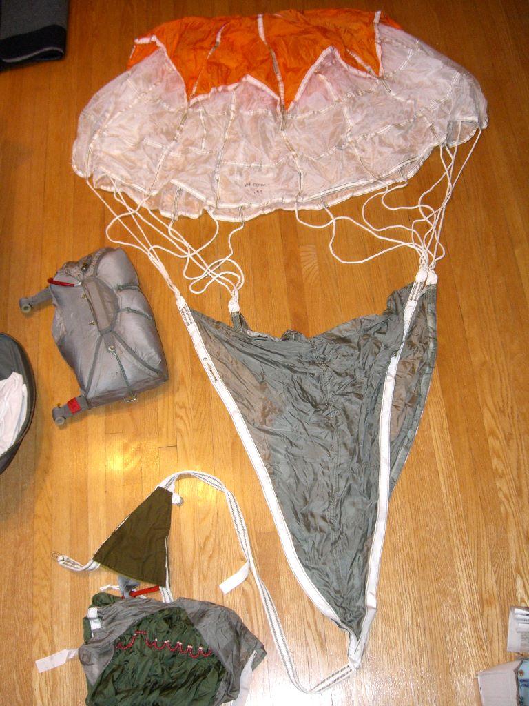

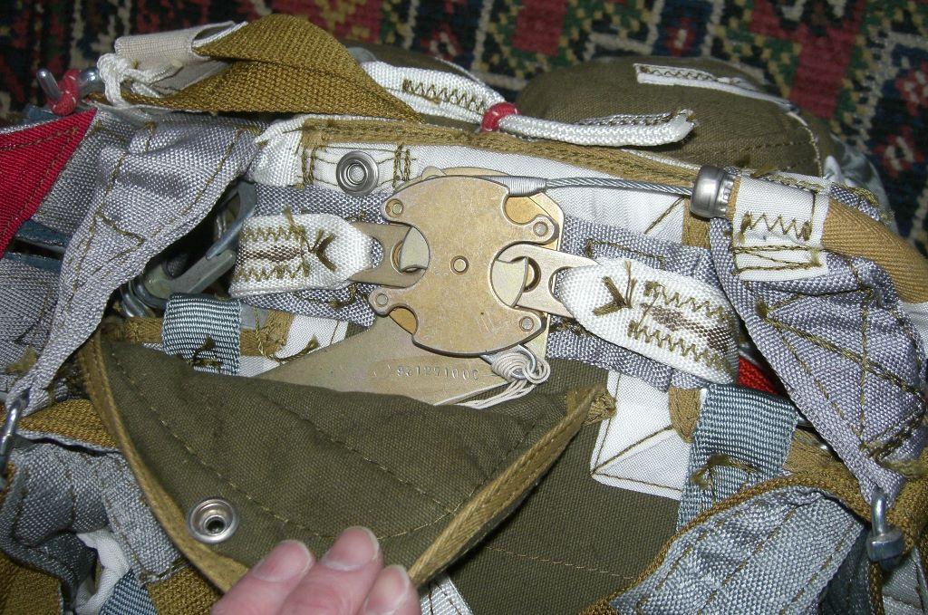

pchapman 280 #3 September 9, 2019 I'm not sure what their current system is, but the one I'm familiar with is the D-6 which is or was a common Russian paratrooper rig. There the drogue is static lined on exit, with the drogue attachment basically at the top of the pack behind one's neck. A rotating disc release mechanism can be activated by a KAP-3 style mechanical AAD, or by ripcord. The drogue then pulls the main canopy out. The whole system allows one to have a relatively light and large main canopy yet jump at very high exit speed. A few pics from my system are attached. (I posted years back on DZ, but the new dropzone.com system has made the old photos disappear) 2 Quote Share this post Link to post Share on other sites
