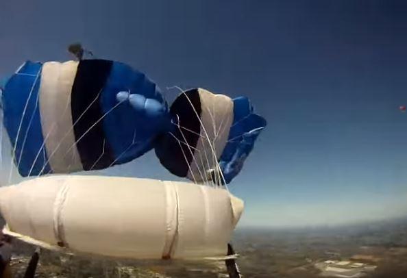

CoolBeans 11 #1 Posted August 4, 2019 (edited) Hi there, I had first cut-away on my last jump, #19 on Icarus Student 240 sqft canopy with RSL on it - rental rig. These are packed by drop zone packers. That was a coach jump. At pull altitude I went for the main deployment handle but I missed it. I went for it again and then I got good grip on it and deployed then. From coach perspective it looked like I grabbed and kept it for 1 sec or so and apparently bridle released on first touch. Don't know if any of that could have contributed to the malfunction. Opening was just fine. I'm used to Icarus Student 220 sqft canopy that usually gets energetic during the opening - end cells don't inflate for few secs and canopy shakes me side to side. Because of that I have a habit of getting quick on toggles as I'm always thinking - what if it's toggle fire? and also getting ready to pump brakes to get these end cells to inflate. Anyway this time on Icarus Student 240 sqft I did the same thing, went to toggles very quick. But then I noticed canopy wasn't square. It looked like a bow-tie attached on the picture except: - in my case the bow-tie knot on the canopy wasn't as tight, it was about 2 feet wide - normally steering lines bend as canopy flies forward; my left steering line didn't bend; it was tangled with other suspension lines What happened later - I realized I have to either fix it or cut-away. Canopy was pretty stable, no spin. I checked altitude, 4000 ft and then pumped brakes 3 times. That thing didn't clear, my canopy still wasn't square but it was relatively stable so far. Next thing I pulled left toggle only about half way down. That woke the devil. Now it spun me on my back like a roller-coaster. At that moment I decided I'm cutting it away as I realized things might get only worse from now on - I let both toggles off - I looked down on cut-away handle and grabbed it with both hands - I yanked it out - Right after that I went with both hands to reserve handle and pulled that one too At 2500 ft I was under fully inflated reserve and landed normal pattern. No injuries whatsoever. What I DIDN'T do was - I did not arch before starting emergency procedures - forgot about it as I never practice that part - I did not bother at all about peel-punch, I just yanked cut-away and then reserve handles - same thing, don't really practice details about how to handle the handle - Once under the reserve I realized my cut-away cables didn't clear all the way; I didn't swipe the cables - same thing, don't practice swiping cables when practicing emergency procedures - I did not LOOK at reserve handle; I might have been lucky that after cutting away I found it with no looking whatsoever - I normally practice that part; during real thing I must have forgotten about it - I did not keep reserve handle, it dropped Surprisingly this whole situation wasn't stressful at all, I didn't think about anything else but solving the problem and doing next step as I was trained. As a matter of fact I felt very calm and comfortable given that canopy for the initial part wasn't spinning and I had good altitude left. I have no problem jumping exact same rig again. There are things that I could have done better, I could have tried harder to fix it, I could have performed my emergency procedures better, I could have saved the reserve handle. Right before cutting away as I let both toggles off - canopy started getting stable again so I COULD HAVE tried again to fix it but I was already committed to cutting it away. I'm sharing this so I can learn and prepare better for any future dealings with problems but also for others to see, evaluate and learn from my incident. Also, I don't really feel like talking to family or non-skydiving friends about that... Disclaimer: attached picture is NOT my malfunction. My malfunction only looked very similar to it. Edited August 4, 2019 by CoolBeans Quote Share this post Link to post Share on other sites
20kN 93 #2 August 5, 2019 What I DIDN'T do was - I did not arch before starting emergency procedures - forgot about it as I never practice that part. Yea lots of people dont. Try to do it, but getting the reserve out quickly is the more important objective. - I did not bother at all about peel-punch, I just yanked cut-away and then reserve handles - same thing, don't really practice details about how to handle the handle. You should always practice pealing the velcro away. People have been unable to execute their EPs at all because they were not pealing the velcro and therefore could not pull the handle. But that's fine, it worked, just know if ever you grab the handle and cant pull it, possibly it's because you did not peal the velcro away. - Once under the reserve I realized my cut-away cables didn't clear all the way; I didn't swipe the cables - same thing, don't practice swiping cables when practicing emergency procedures. The point in sweeping the cables is to ensure you dont have a partial cutaway, but if you're already under your reserve and the main is gone then it worked. As long as you punch all the way down as far as you can with your cutaway arm(s), then you would have pulled enough cable through the housings to cut away both sides. - I did not LOOK at reserve handle; I might have been lucky that after cutting away I found it with no looking whatsoever - I normally practice that part; during real thing I must have forgotten about it. You should always look before reaching, but know that the day might come where you cannot see your handles. Many people have had issues finding their handles because they could not see them. This usually happens during linetwists that occur in a manner that your head is pinned in a position where you cannot look down. I've had this happen several times to me, just so far never during a cutaway. - I did not keep reserve handle, it dropped. Irrelevant. Keeping the handle is not part of conducting proper EPs. 1 Quote Share this post Link to post Share on other sites
meat.missile 25 #3 August 5, 2019 On 8/4/2019 at 11:01 AM, CoolBeans said: Disclaimer: attached picture is NOT my malfunction. My malfunction only looked very similar to it. Just so everyone is aware. This can happen with half a step through. As you can see the right riser is also twisted. Quote Share this post Link to post Share on other sites

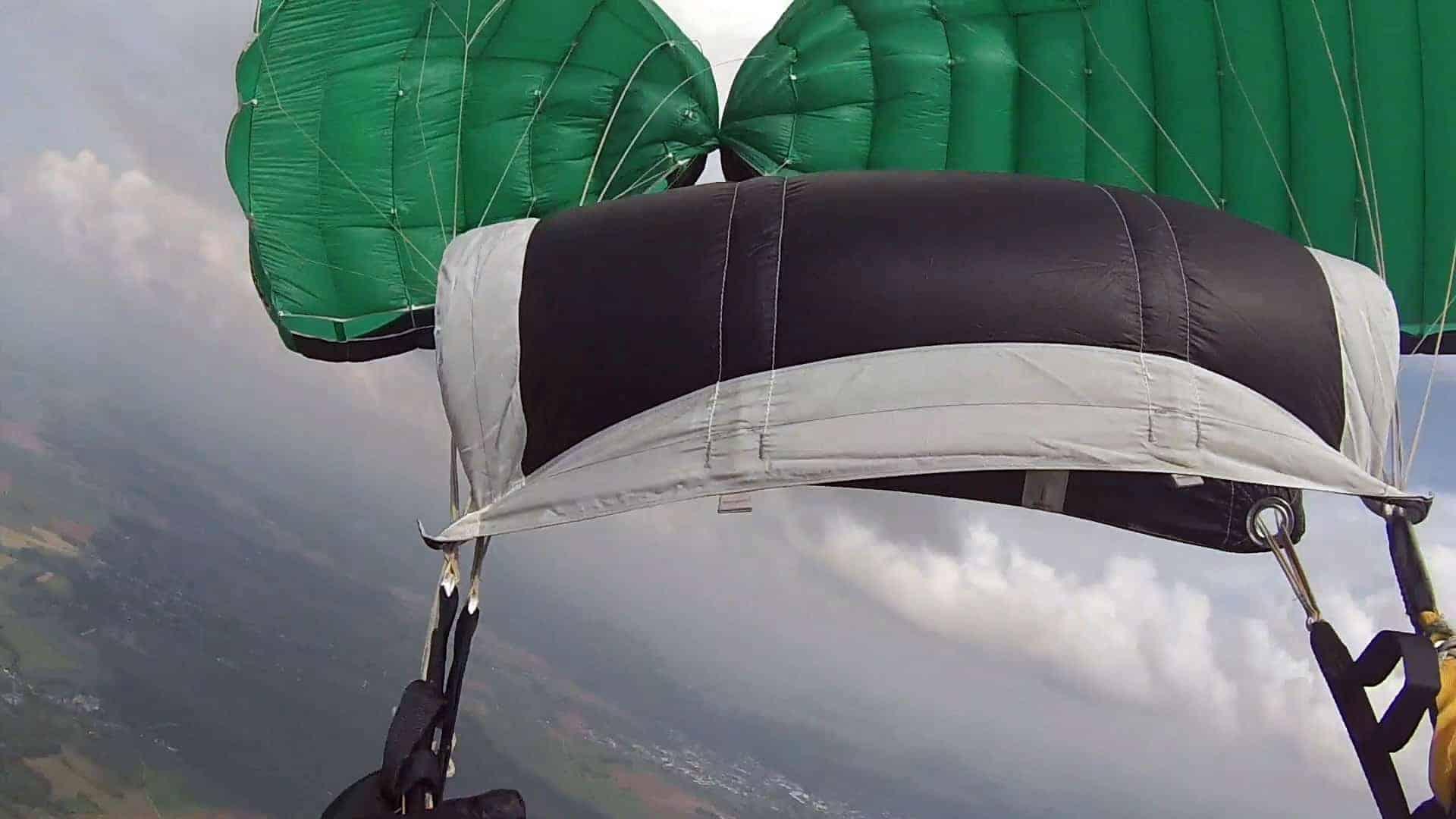

Divalent 169 #7 August 28, 2019 FYI, here's what my lineover looked like on a Pilot 189. I'm sure it fully pinched in the middle, but hidden by adjacent cell fabric. Quote Share this post Link to post Share on other sites
CoolBeans 11 #8 August 28, 2019 (edited) @Divalent mine looked very similar! Except it was on the left hand side and minimally farther from the center. Was your right steering line free to move? That knot on the right hand side you have, I had similar one but on the left hand side and my left steering line was tangled there so when I pulled left toggle - whole left part of the canopy would react. Is the knot part of line over malfunction? Or is it 2 malfunctions on that picture, line over + tension knot? Edited August 28, 2019 by CoolBeans Quote Share this post Link to post Share on other sites
Divalent 169 #9 August 28, 2019 (edited) 52 minutes ago, CoolBeans said: Is the knot part of line over malfunction? Or is it 2 malfunctions on that picture, line over + tension knot? There wasn't a knot (at least as far as I could tell). I'm pretty sure the bunching of the lines on the right side is due to the line that caused the lineover. A front line that goes over the top and down the back has to course outside around all the remaining lines to reach it's attachment point on the front riser. (and vice versa if it was a back line). You would expect that bunching to not look as extreme if the lineover was nearer the end (shorter distance, fewer good lines to get past). Edited August 28, 2019 by Divalent Quote Share this post Link to post Share on other sites
