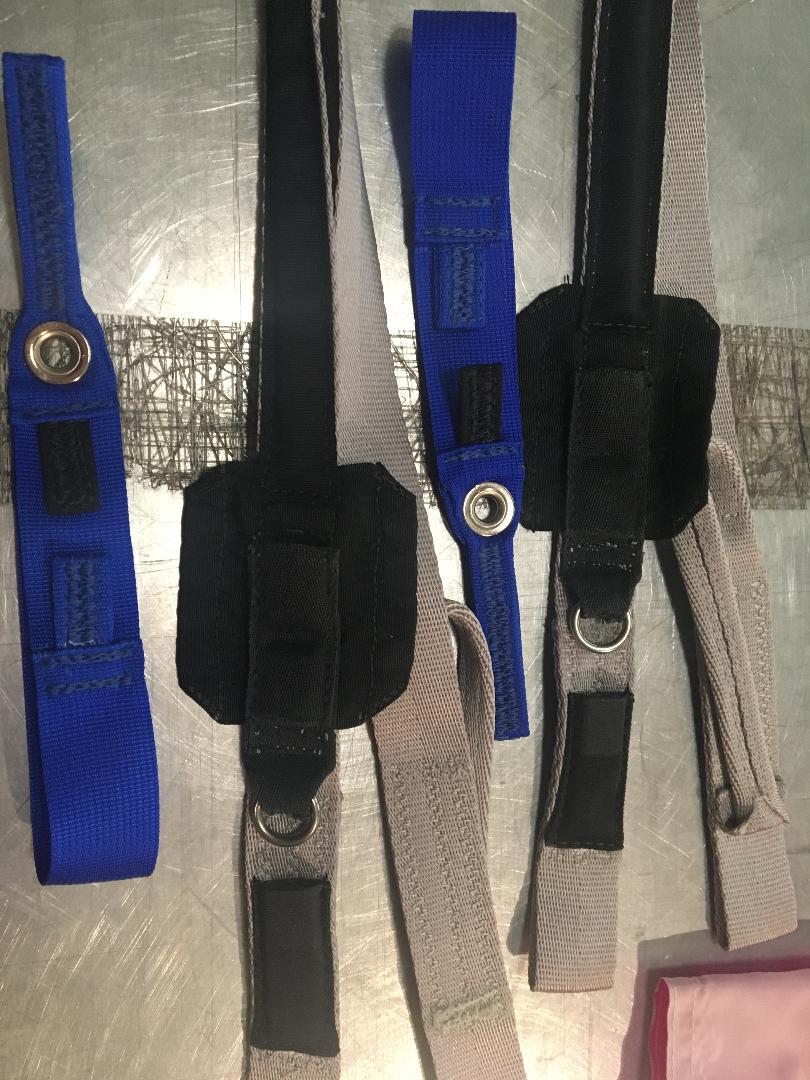

husslr187 24 #2 April 8, 2019 my toggle stows are tight and it has a fold at the bottom similar to the top that stows in a similar fashion. I’ll take a few pictures when I get home from work so you’ll see what I mean. Only time I had one unstow on me was my fault (didn’t pull cats eye through little ring) Nothing eventful happened and I now take another moment to check and make sure it’s right before I continue to pack. Quote Share this post Link to post Share on other sites

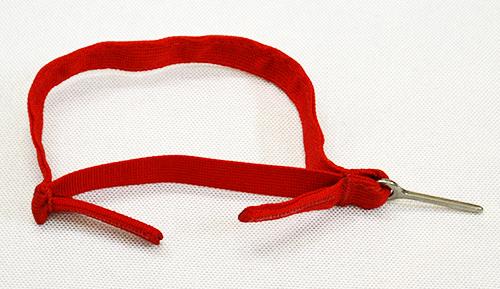

IJskonijn 45 #7 April 8, 2019 (Not my reserve ride, nor my canopy, nor my gear decisions) Risers had no slider bumpers. Slinks and type 17 risers. So yeah, the likely mechanism was the slider slamming into the top tuck tab of the toggle, and dislodging it. 4 hours ago, piisfish said: Parachutes de France toggles. Best, bar none. 1 pin up, 2 tabs down. Are there commercial risers for sale that have this design toggle, but with normal three-ring system, rather than reversed layout? Or would that require the efforts of a master rigger to create? Quote Share this post Link to post Share on other sites
gb1 3 #8 April 8, 2019 3 minutes ago, IJskonijn said: (Not my reserve ride, nor my canopy, nor my gear decisions) Risers had no slider bumpers. Slinks and type 17 risers. So yeah, the likely mechanism was the slider slamming into the top tuck tab of the toggle, and dislodging it. Are there commercial risers for sale that have this design toggle, but with normal three-ring system, rather than reversed layout? Or would that require the efforts of a master rigger to create? This an industry wide problem that has been mostly unreported because people did not have it happen on the next jumps. When the slider makers went to the premium quality stainless grommets, they elected to install the ones with an inside diameter of 15/16 in. Real bright. The old style #8's have an ID of 1 1/6 in. The riser and toggle material is mostly 1 in width. Then, slam a size #0 grommet in the toggle handle and it becomes more than 1in wide and rock hard. Try putting that through a 15/16 in hole. Guess what, you will have a jamb up or worse a toggle fire. A jamb up will cost you critical time upon opening when you are getting control of the canopy. A toggle fire will swing you around and maybe twist lines leading to a cutaway, even if you are not jumping a hot rod. I installed real #8's on my slider and built quick draw slim toggles. Either will drastically help the problem. After 2 toggle fires and multiple jamb ups, it is now just a memory. Then you will get the folks that say "just install bumpers" and live with your slider flapping, slowing you down, and obstructing your vision. Remember, It doesn't take much to work, and it doesn't take much to not work." Good Luck 1 Quote Share this post Link to post Share on other sites
piisfish 140 #9 April 8, 2019 24 minutes ago, IJskonijn said: (Not my reserve ride, nor my canopy, nor my gear decisions) Risers had no slider bumpers. Slinks and type 17 risers. So yeah, the likely mechanism was the slider slamming into the top tuck tab of the toggle, and dislodging it. Are there commercial risers for sale that have this design toggle, but with normal three-ring system, rather than reversed layout? Or would that require the efforts of a master rigger to create? Pretty sure Deyan can do that. All my risers were modified like that by Colin in Empuria. Quote Share this post Link to post Share on other sites

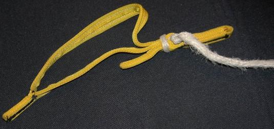

Cloggy 1 #14 April 9, 2019 (edited) On 4/8/2019 at 1:59 PM, piisfish said: Parachutes de France toggles. Best, bar none. 1 pin up, 2 tabs down. I fully agree. Never had any toggle fire with them. About a year ago I started looking into velcroless designs to replace some velcro toggles. So far I didn't find anything that I liked better than the Parachute de France toggles. I think it's quite an elegant design: no bulky tongues with 6 layers of fabric. And I like the way 1 piece of binding tape is used to make up the two pockets and cover the hard housing as well: smart. The design by ParachutesAustralia also seemed promising. Edited April 9, 2019 by Cloggy Quote Share this post Link to post Share on other sites

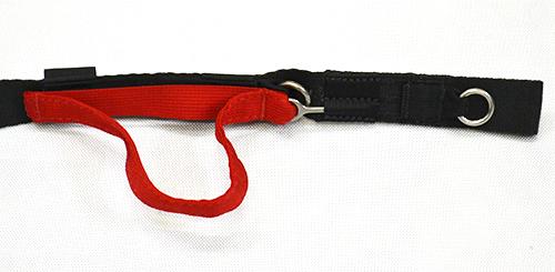

alexey 6 #15 April 10, 2019 SWS do pin-type risers 1 Quote Share this post Link to post Share on other sites
Cloggy 1 #16 April 10, 2019 1 hour ago, alexey said: SWS do pin-type risers Thanks Alexey, didn't know about these. Quote Share this post Link to post Share on other sites

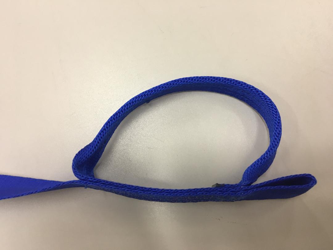

gb1 3 #17 April 10, 2019 (edited) After building many sets of toggles, one of many things I learned is that using a zig zag stitch on the upper tongue causes more abrasion and rapid wear on the brake eyelet on the brake line. Early on it was found that multiple straight stitching (301type) eliminates the wear on the "cat eye". The toggle with the downward tongue requires a wrong direction pull on the pocket it fits into. Eliminating the bottom tongue simplifies the whole system. For now that system works but could go to the next step quite easily. Edited April 10, 2019 by gb1 Quote Share this post Link to post Share on other sites

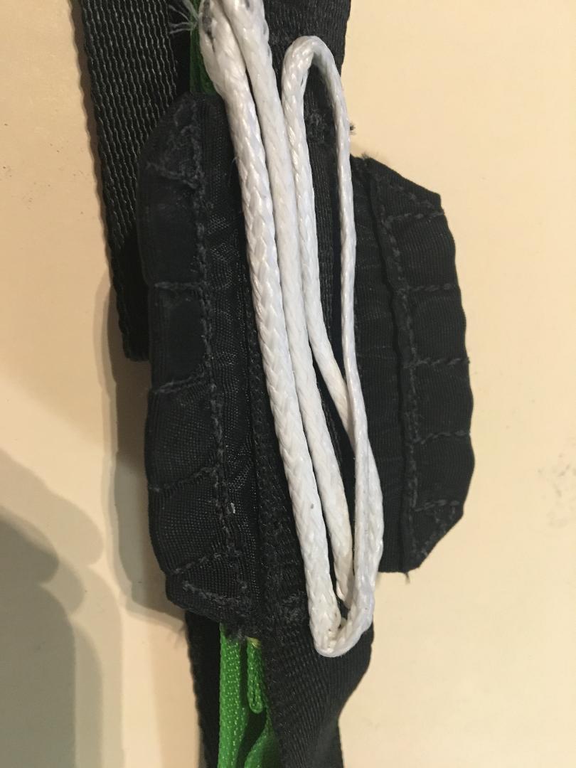

chips26 4 #18 April 12, 2019 On 4/10/2019 at 12:43 AM, alexey said: SWS do pin-type risers To me its less about the toggle design and more about the risers. In a two ring setup like the picture above, as well as on Wing's swoop risers, the cat eye goes through the bottom ring, and then the pin or soft toggle portion goes through the cat eye and into the keeper above the bottom ring. All pressure is pulling up on the toggle and the toggle cannot physically come unstowed unless the toggle gets released from the cat eye. The only way to do that is to pull down. Quote Share this post Link to post Share on other sites
sundevil777 102 #19 April 12, 2019 2 hours ago, chips26 said: To me its less about the toggle design and more about the risers. In a two ring setup like the picture above, as well as on Wing's swoop risers, the cat eye goes through the bottom ring, and then the pin or soft toggle portion goes through the cat eye and into the keeper above the bottom ring. All pressure is pulling up on the toggle and the toggle cannot physically come unstowed unless the toggle gets released from the cat eye. The only way to do that is to pull down. Isn't all of that true for std toggles with the webbing-nose? I don't see how the metal pin avoids any possible failure scenarios. Quote Share this post Link to post Share on other sites
Cloggy 1 #20 April 13, 2019 (edited) Disclaimer: I'm not a rigger, all is just my personal interpretation and opinion :-) The pin in itself is not the whole solution. The pin has a smaller profile (cross section) than a fabric tongue (nose). Most other soft toggles seem to use 1" square weave. The PdeF toggles (and probably the SWS too) use 5/8" square weave: also lower profile when passing through the slider grommet. All in all, I'd think there is less chance that the slider grommet comes into contact with the pin or toggle. The other part is the downward pointing tab immediately below the straight pin. This tab sits in the pocket on the riser below the guide ring, and prevents downward movement should the slider grommet come into contact with the pin or toggle. I tried to push the pin out of the keeper: very hard to do, even more so when there is any tension on the riser. Edited April 13, 2019 by Cloggy Quote Share this post Link to post Share on other sites
