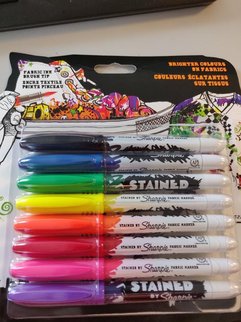

TheFlyingSwede 0 #14 February 15, 2019 On 2/14/2019 at 2:14 AM, 20kN said: Not necessarily. I colored my attachment points on my first canopy and I used the colored attachment points for my first 500 jumps. It was not until I had my D license that I packed a canopy without colored attachment points (it was a demo), and I found it to be just as easy as a canopy with the colored attachment points. At that point I had enough pack jobs that I was not even really paying attention to the colors much anymore. However, the colored attachment points helped big time when I was learning to pack. It made the process easier and if I had to start over again I'd 100% be down for using colored attachment points. It's useful when you're new. I think it is not a bad idea to mark them as you mentioned above and today i bought these pens and think that is what is good "textile markers" you think this are good if i decide to go the route of marking them in the weekend Quote Share this post Link to post Share on other sites
20kN 93 #15 February 15, 2019 (edited) 6 hours ago, TheFlyingSwede said: I think it is not a bad idea to mark them as you mentioned above and today i bought these pens and think that is what is good "textile markers" you think this are good if i decide to go the route of marking them in the weekend When I colored my lines I only colored the attachment point webbing that extends beyond the bar tack. If you look at the attachment point you'll see that the canopy manufacturer does not usually trim the webbing right at the bar tack that connects it to the canopy. Usually there is about 10mm of material that extends beyond the bar tack. I color that material because it is not load bearing. Edited February 15, 2019 by 20kN Quote Share this post Link to post Share on other sites
JerryBaumchen 1,471 #16 February 15, 2019 24 minutes ago, 20kN said: Usually there is about 10cm of material that extends beyond the bar tack. Hi 20kN, I think you mean 10 mm. 10 cm = ~ 4 inches. Jerry Baumchen Quote Share this post Link to post Share on other sites
