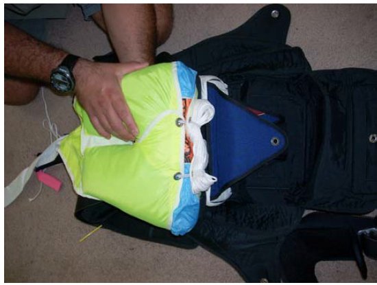

pchapman 280 #9 October 23, 2018 Quote ***As long as you can close it... I'd disagree with that. Note that I did then include some warnings and limits. But yes generally one doesn't want a ton of fabrics ticking out, and many may disagree with me about fabric sticking out in general, as it really isn't 'normal' or the way main bags are planned to be used. Still, consider the attached example from one manufacturer's reserve packing manual -- there's plenty of canopy sticking out in the official manual for a system certificated to 150 kts. Having some canopy sticking out isn't the end of the world, even if we can probably agree that in most situations it isn't ideal. [inline wingsreserve.jpg] Quote Share this post Link to post Share on other sites

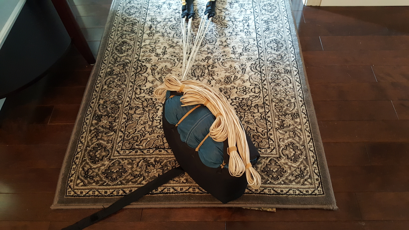

Volare500 0 #10 October 23, 2018 This is what it looks like. It all fits in the container like a glove, no problems there. Closes up just fine and is not overstuffed one bit. Maybe I'm truely horrible at packing, but I swear you could bounce a quarter off this thing. The rig has a 170 main and 170 reserve, giving me a 0.95 wing load. It's older, but in great shape. And the harness was made for someone exactly my hight and weight. Unless my research has lead me wrong, it all sounds like a good starter rig for someone like myself with under 100 jumps. Quote Share this post Link to post Share on other sites
pchapman 280 #11 October 23, 2018 Yeah that's pretty overstuffed in the bag. At least chain a couple elastics together for the first two stows, so those two aren't overstressed and break too easily? And follow some of the earlier advice in the thread -- check container vs. canopy volume, and have an experienced packer pack it. Quote Share this post Link to post Share on other sites
degeneration 5 #12 October 23, 2018 Basic question - are you sure that the canopy is filling all the dbag? All the way into the corners? If that's a 170 main, are you sure the container is sized suitably for a 170 main?Sky Switches - Affordable stills camera tongue switches and conversion adaptors, supporting various brands of camera (Canon, Sony, Nikon, Panasonic). Quote Share this post Link to post Share on other sites
sundevil777 102 #13 October 23, 2018 The middle locking stows are likely to break right when the most load is on them, when the bag is lifted, the acceleration of the canopy putting a lot more stress right at the locking stows. You really should do something to avoid that.People are sick and tired of being told that ordinary and decent people are fed up in this country with being sick and tired. I’m certainly not, and I’m sick and tired of being told that I am Quote Share this post Link to post Share on other sites

Westerly 61 #15 October 24, 2018 Volare500This is what it looks like. It all fits in the container like a glove, no problems there. Closes up just fine and is not overstuffed one bit. Maybe I'm truely horrible at packing, but I swear you could bounce a quarter off this thing. The rig has a 170 main and 170 reserve, giving me a 0.95 wing load. It's older, but in great shape. And the harness was made for someone exactly my hight and weight. Unless my research has lead me wrong, it all sounds like a good starter rig for someone like myself with under 100 jumps.Yea, if the canopy is packed well, then that bag is definitely too small. What brand and size container do you have? It should say on the TSO label that holds your reserve packing card. Quote Share this post Link to post Share on other sites
