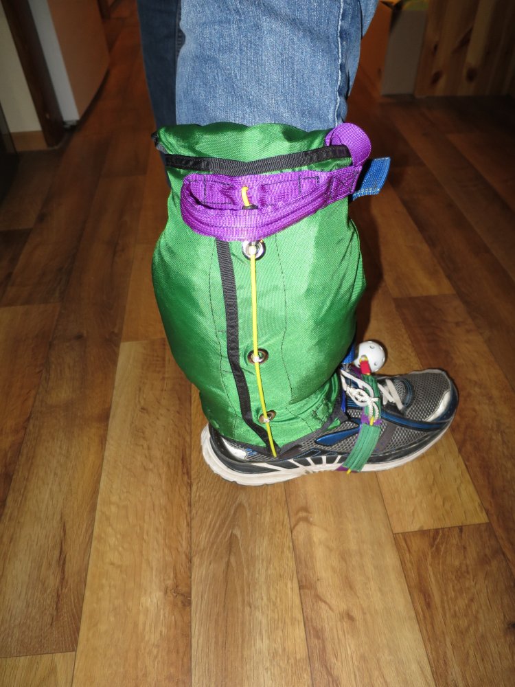

IJskonijn 45 #13 October 25, 2018 I personally use a leg-mounted flagbag. It holds a flag that attaches to my foot on the bottom end (via an easily released connection), and can hook into my risers on the top end. Added advantage is that there is no weights to deal with. This bag can be taken to terminal without issues (as long as it is tight enough, so don't understuff it). Made of parapac, binding tape, webbing, chest strap hardware and a main cutaway cable. Any rigger with some sewing experience and the ability to set grommets can sew it for you. Quote Share this post Link to post Share on other sites
