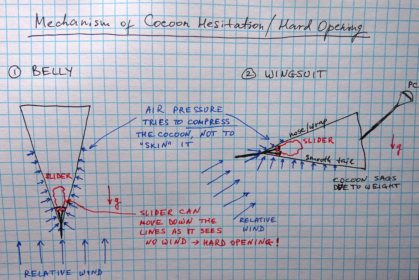

yuri_base 1 #56 October 14, 2018 Here's the diagram I promised. I didn't find the pressure distribution around a cone, but by analogy with the pressure distribution on the bottom surface of an airfoil - [inline AirfoilPressureDistribution.gif] - pressure is nearly perpendicular to the surface of the cocoon, so it tries to compress the cocoon, not to "skin" it. Fresh ZP is happy to unwrap itself as it's so slippery and springy, but used ZP's friction can keep the cocoon closed for an extra fraction of a second and cause the slider to slide down the lines as it encounters no resistance from the wind - it's inside the "cabin" of the cocoon. With wingsuit, due to sagging, the air mostly hits the bottom of the cocoon which is a smooth surface and it's just happy to stay closed and trailing behind. [inline MechanismOfCocoonHesitation.jpg] Anyway, I feel I said everything I wanted to say, tested the ground 5 years after first sharing this (after about 4 years of testing it), and it's still infertile. Oh well, not the first time, not the last. I'll revisit the topic in a few years to see if it's a good time to plant the seed. Bye bye now! Android+Wear/iOS/Windows apps: L/D Vario, Smart Altimeter, Rockdrop Pro, Wingsuit FAP iOS only: L/D Magic Windows only: WS Studio Quote Share this post Link to post Share on other sites
LeeroyJenkins 3 #57 October 15, 2018 yuri_base Here's the diagram I promised. I didn't find the pressure distribution around a cone, but by analogy with the pressure distribution on the bottom surface of an airfoil - - pressure is nearly perpendicular to the surface of the cocoon, so it tries to compress the cocoon, not to "skin" it. Fresh ZP is happy to unwrap itself as it's so slippery and springy, but used ZP's friction can keep the cocoon closed for an extra fraction of a second and cause the slider to slide down the lines as it encounters no resistance from the wind - it's inside the "cabin" of the cocoon. With wingsuit, due to sagging, the air mostly hits the bottom of the cocoon which is a smooth surface and it's just happy to stay closed and trailing behind. Anyway, I feel I said everything I wanted to say, tested the ground 5 years after first sharing this (after about 4 years of testing it), and it's still infertile. Oh well, not the first time, not the last. I'll revisit the topic in a few years to see if it's a good time to plant the seed. Bye bye now! Are you trying to argue that the pressure caused by the relative wind is greater than the core of the wind blowing on the top skin tail so much so that it prevents the canopy from opening as fast? It seems you assume that the cacoon won’t be parrle with the relative wind, I don’t know what you are basing that idea on but it seems like you are inventing a fixed point while there are none. Quote Share this post Link to post Share on other sites

billvon 3,109 #59 October 15, 2018 Quotesed ZP's friction can keep the cocoon closed for an extra fraction of a second and cause the slider to slide down the lines as it encounters no resistance from the wind - it's inside the "cabin" of the cocoon. In that case, what force do you imagine is accelerating the slider downwards? Quote Share this post Link to post Share on other sites
LeeroyJenkins 3 #60 October 15, 2018 Bill, Don't forget the force of the air against the cocoon pushing against the slider pushing against the line attachments, something creates the tension in the lines. Quote Share this post Link to post Share on other sites

Westerly 61 #62 October 16, 2018 yuri_base Here's the diagram I promised. I didn't find the pressure distribution around a cone, but by analogy with the pressure distribution on the bottom surface of an airfoil - - pressure is nearly perpendicular to the surface of the cocoon, so it tries to compress the cocoon, not to "skin" it. Fresh ZP is happy to unwrap itself as it's so slippery and springy, but used ZP's friction can keep the cocoon closed for an extra fraction of a second and cause the slider to slide down the lines as it encounters no resistance from the wind - it's inside the "cabin" of the cocoon. With wingsuit, due to sagging, the air mostly hits the bottom of the cocoon which is a smooth surface and it's just happy to stay closed and trailing behind. Anyway, I feel I said everything I wanted to say, tested the ground 5 years after first sharing this (after about 4 years of testing it), and it's still infertile. Oh well, not the first time, not the last. I'll revisit the topic in a few years to see if it's a good time to plant the seed. Bye bye now! Why not just wrap the top skin without folding it? That's what I do when I pack. I leave the nose out, and I dont wrap the tail whatsoever. I just wrap it around the canopy and then lay it on the ground. Then when it comes out of the bag, regardless of whether the air is pushing on the bottom of the cocoon or trying to strip the fabric off, there is really not much to hold it in place since the tail is not wrapped at all. Quote Share this post Link to post Share on other sites

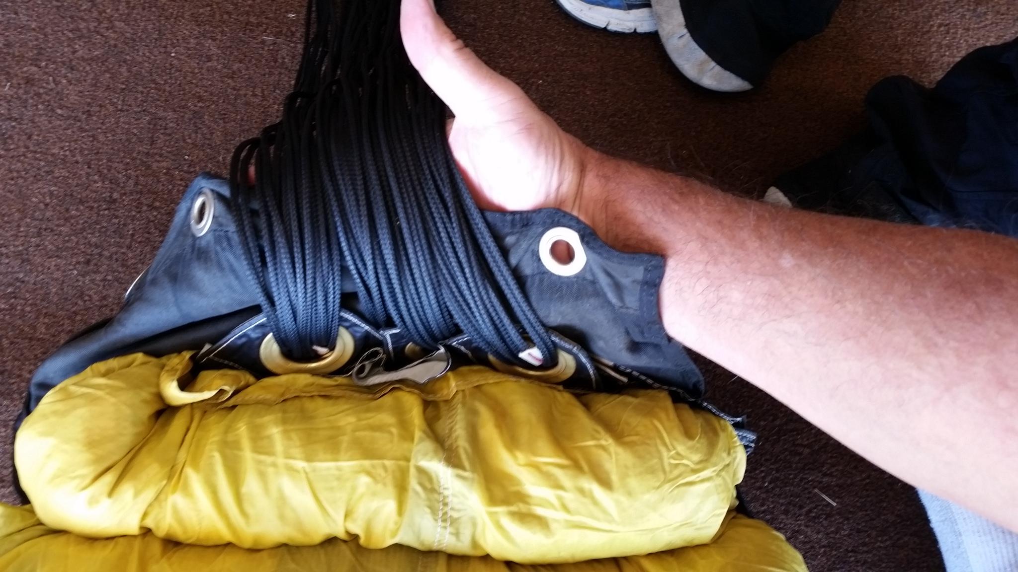

peek 21 #67 March 23, 2019 On 3/21/2019 at 11:12 PM, Elpnor said: I reverse s fold my canopy. The end with the slider is the last thing I put in my bag, and I always give it a last push up against the stops. Minus the movement of the slider under tail, is there anything else terrible about this packing style? Yuri makes a convincing argument I took the attached picture back when this thread was new, and have been waiting to use it. This is my zero porosity Manta in the bag, waiting for me to check the grommet position and close the bag. (Yes, those are black Dacron lines.) It starts out stack-packed with the tail ever so slightly wrapped around the canopy. It is packed "wide", to fit the bag. (I don't fold it into the bag, rather I fold and stack the folds, then put it in the bag.) This is how I have packed all of my canopies for decades, including the Stiletto. All wonderful openings. Quote Share this post Link to post Share on other sites
