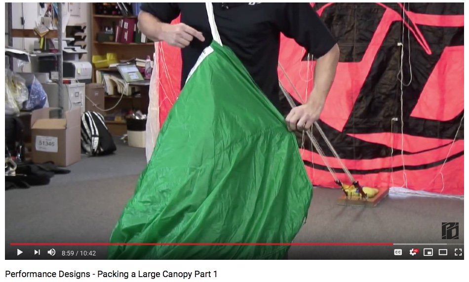

yuri_base 1 #42 October 12, 2018 >>> https://www.youtube.com/watch?v=cVAoiLl2B6M What's interesting that in the old illustrations of PRO pack we've all seen in the manuals, it shows slider grommets exposed, with a big "mouth" of the cocoon making grommets visible: [inline OldPROPackIllustration.gif] (is this John LeBlanc, a sketch made from a photo?) So, maybe it was taught like this in the beginning (1970's?), but people just started wrapping the cocoon tightly above the grommets, and it just stuck, and exposed grommets became a "no-no"? But in the video, we see a tightly closed cocoon with no hole in the apex and no slider grommets visible. INCORRECT: [inline PDIncorrect1.jpg] INCORRECT: [inline PDIncorrect2.jpg] INCORRECT: [inline PDIncorrect3.jpg] CORRECT: (Forgot: yet another benefit of the ES method is it makes squeezing air out much much easier.) According to USPA, about 3 million jumps are made every year. Worldwide, probably about 5 million? Every jumper experiences a hard opening once in a while. Let's be conservative and say that on average, hard opening occurs only once in 1000 jumps. That's ~5000 hard openings a year. Some of them are hard enough to cause at least some injury (spine, neck). And some of them are hard enough to kill. (probably, an average of 1 per year? some deaths that are chalked up to "medical condition" may have been caused by a hard opening as a trigger of that medical condition) If we can develop a method that reduces hard openings by at least some factor - 10, 100, whatever - that's a great achievement, there will be many thousands of people (over the years) without back/neck problems, and dozens of people (over the years) alive today. Imagine they're alive and knew that they were destined to be killed by a hard opening - you could organize a boogie and invite these "dead men walking" and celebrate life! I - very strongly - believe that Exposed Slider is such a method.* Don't hide the slider from the blast of fresh air it likes so much! Free the nipple slider! * I'm only a human, so might be wrong. Only widespread courage of experienced jumpers willing to test it, can prove it right or wrong. I've done 400 tests, I'm done with this. The ball is in YOUR court now. Android+Wear/iOS/Windows apps: L/D Vario, Smart Altimeter, Rockdrop Pro, Wingsuit FAP iOS only: L/D Magic Windows only: WS Studio Quote Share this post Link to post Share on other sites

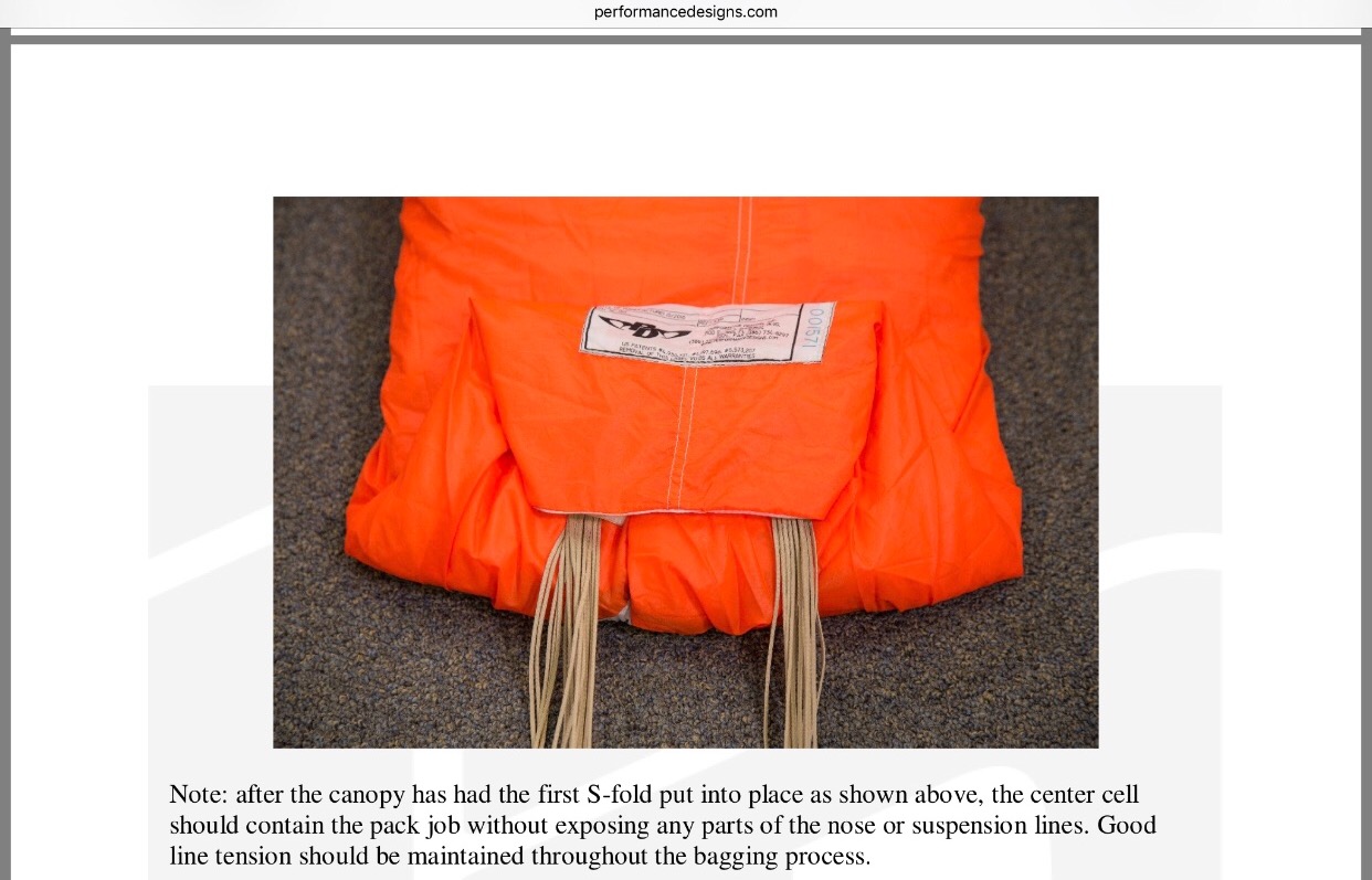

dgw 8 #43 October 12, 2018 I think the physics of what you say is difficult to refute. I agree with the idea. Safe implementation might be a practical issue, but implementation of the 'standard' method is also potentially a practical problem. Out of curiosity, I downloaded a PD reserve manual to see what the practice is on (a) reserve parachute. It's a TR-375, which was just the first manual that I happened upon. The attached photograph shows the slider packing method to be ES Quote Share this post Link to post Share on other sites
Westerly 61 #44 October 12, 2018 yuri_base >>> https://www.youtube.com/watch?v=cVAoiLl2B6M What's interesting that in the old illustrations of PRO pack we've all seen in the manuals, it shows slider grommets exposed, with a big "mouth" of the cocoon making grommets visible: (is this John LeBlanc, a sketch made from a photo?) So, maybe it was taught like this in the beginning (1970's?), but people just started wrapping the cocoon tightly above the grommets, and it just stuck, and exposed grommets became a "no-no"? But in the video, we see a tightly closed cocoon with no hole in the apex and no slider grommets visible. INCORRECT: INCORRECT: INCORRECT: CORRECT: [.image]http://www.dropzone.com/cgi-bin/forum/gforum.cgi?do=post_attachment;postatt_id=150637;[/image] (Forgot: yet another benefit of the ES method is it makes squeezing air out much much easier.) According to USPA, about 3 million jumps are made every year. Worldwide, probably about 5 million? Every jumper experiences a hard opening once in a while. Let's be conservative and say that on average, hard opening occurs only once in 1000 jumps. That's ~5000 hard openings a year. Some of them are hard enough to cause at least some injury (spine, neck). And some of them are hard enough to kill. (probably, an average of 1 per year? some deaths that are chalked up to "medical condition" may have been caused by a hard opening as a trigger of that medical condition) If we can develop a method that reduces hard openings by at least some factor - 10, 100, whatever - that's a great achievement, there will be many thousands of people (over the years) without back/neck problems, and dozens of people (over the years) alive today. Imagine they're alive and knew that they were destined to be killed by a hard opening - you could organize a boogie and invite these "dead men walking" and celebrate life! I - very strongly - believe that Exposed Slider is such a method.* Don't hide the slider from the blast of fresh air it likes so much! Free the nipple slider! * I'm only a human, so might be wrong. Only widespread courage of experienced jumpers willing to test it, can prove it right or wrong. I've done 400 tests, I'm done with this. The ball is in YOUR court now. Why dont you just email John LeBlanc and ask him what he thinks? Quote Share this post Link to post Share on other sites

dgw 8 #49 October 12, 2018 The attached is from the PD Horizon manual. I'll leave the physics to Yuri. Quote Share this post Link to post Share on other sites
PhreeZone 20 #50 October 13, 2018 In that photo the grommets are not exposed, they just did not cocoon it as tight as some jumpers do for the photos. The reason that in the reserve manual they are shown that way is since you need to stack the grommets on top of each other for each side while creating an and at no point are you wrapping the tail all the way around the canopy. Reserve openings from terminal are rarely described as "Soft and gentle" - the method we use to pack reserves is to give the canopy the best chances of opening on heading in the fastest possible way while consuming the least amount of altitude while not causing openings that are excessively hard. We leave the nose exposed and don't wrap anything.Yesterday is history And tomorrow is a mystery Parachutemanuals.com Quote Share this post Link to post Share on other sites
