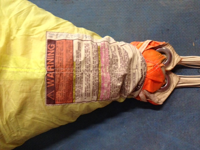

yuri_base 1 #5 October 7, 2018 Hard openings, imho, are caused by slider being "shaken down" under the cover of the cocoon if there's even a slight delay in wind blowing it off. This is especially true for wingsuiting with non-fresh ZP and even tracking (even tracking on break-off after a non-tracking jump). Exposing the slider so it's pushed by relative wind into the stops the first moment the canopy is out of the D-bag, solves the problem. It also greatly helps with reducing the occurrence of line twists. (see attached video illustrating cocoon hesitation) [inline Cocoon.jpg] On the other, less serious hand, hard openings are not always a bad thing: when I was doing my AFF, a hard opening fixed a problem in my spine with displaced vertebrae (from a big wave crush on my back when body surfing in the ocean), it settled them in proper place. I felt like I was born again. PS. Exposing slider is for experienced enough jumper, of course. Don't do it without packing/jumping at least 100-200 of normal pack jobs. Android+Wear/iOS/Windows apps: L/D Vario, Smart Altimeter, Rockdrop Pro, Wingsuit FAP iOS only: L/D Magic Windows only: WS Studio CocoonHesitation.m4v Quote Share this post Link to post Share on other sites
billvon 3,173 #6 October 8, 2018 >Hard openings, imho, are caused by slider being "shaken down" under the cover of the >cocoon if there's even a slight delay in wind blowing it off. That is one of the many reasons for hard openings. >Exposing the slider so it's pushed by relative wind into the stops the first moment the >canopy is out of the D-bag, solves the problem. I would note that if "exposing the slider" allows the slider to move down the lines even a little during S-folding and insertion into the bag, then that technique will cause, not prevent, hard openings. Quote Share this post Link to post Share on other sites
yuri_base 1 #7 October 8, 2018 billvon>Hard openings, imho, are caused by slider being "shaken down" under the cover of the >cocoon if there's even a slight delay in wind blowing it off. That is one of the many reasons for hard openings. That doesn't mean that it doesn't need to be addressed. billvonI would note that if "exposing the slider" allows the slider to move down the lines even a little during S-folding and insertion into the bag, then that technique will cause, not prevent, hard openings. It won't move by itself, push the grommets all the way up the lines while folding and closing the bag.Android+Wear/iOS/Windows apps: L/D Vario, Smart Altimeter, Rockdrop Pro, Wingsuit FAP iOS only: L/D Magic Windows only: WS Studio Quote Share this post Link to post Share on other sites
Westerly 61 #8 October 8, 2018 yuri_base Hard openings, imho, are caused by slider being "shaken down" under the cover of the cocoon if there's even a slight delay in wind blowing it off. This is especially true for wingsuiting with non-fresh ZP and even tracking (even tracking on break-off after a non-tracking jump). Exposing the slider so it's pushed by relative wind into the stops the first moment the canopy is out of the D-bag, solves the problem. It also greatly helps with reducing the occurrence of line twists. (see attached video illustrating cocoon hesitation) On the other, less serious hand, hard openings are not always a bad thing: when I was doing my AFF, a hard opening fixed a problem in my spine with displaced vertebrae (from a big wave crush on my back when body surfing in the ocean), it settled them in proper place. I felt like I was born again. PS. Exposing slider is for experienced enough jumper, of course. Don't do it without packing/jumping at least 100-200 of normal pack jobs. I think the only people I have ever seen pack that way are AFF students. It seems that method could just as easily create a hard opening as prevent one. If those grommets move down at all while putting it in the bag, you're possibly going to get a hard opening. Why not just loosely wrap the top skin instead? For the PD Horizon, PD recommends very light wrapping of the top skin and leaving a small gap to let air through at the tip of the cocoon. I do a single wrap on the tail all the way at the bottom and that is it for WS jumps. I would think that effectively accomplishes the same thing you're trying to do, except it doesent leave the grommets exposed to get moved out of place while bagging the canopy (or extraction). Quote Share this post Link to post Share on other sites
yuri_base 1 #9 October 8, 2018 WesterlyIt seems that method could just as easily create a hard opening as prevent one. If those grommets move down at all while putting it in the bag, you're possibly going to get a hard opening. See my reply above. Why would anyone let the grommets move down, is it like they have this insane sliding power that the packer can't overcome? (Never happened to me while doing hundreds of jumps on this pack job.) QuoteWhy not just loosely wrap the top skin instead? For the PD Horizon, PD recommends very light wrapping of the top skin and leaving a small gap to let air through at the tip of the cocoon. I do a single wrap on the tail all the way at the bottom and that is it for WS jumps. I would think that effectively accomplishes the same thing you're trying to do, except it doesent leave the grommets exposed to get moved out of place while bagging the canopy (or extraction). The wrap on the tail helps with keeping grommets up during packing (not required, since grommets can be controlled all the way through closing the bag), but doesn't prevent them from sliding down under the cover of the cocoon. It tuns out (watch video attached in my post above), the cocoon - especially on WS jumps - likes to dance closed in the wind, just that extra fraction of a second, but that dance is what causes the slider to move down the lines, as well as spin the canopy around. This may not be noticeable on new, super slippery ZP, but as it gets more used, the cocoon is just happy to dance, because in WS deployment, the wind hits the cocoon from the bottom, which is wrapped by the tail and is a smooth surface. So, a small hole in the apex of the wrap is not sufficient - I tried that; it needs to be big, such as when slider is exposed. The most important thing in reefing the canopy to prevent hard openings is to let the slider be the first thing that "sees" the relative wind, and gets pushed against the stops for good. The worst thing to do is to "hide" the slider from relative wind, under the cocoon. As in wingsuits, acceptance of new things and brave thinking in skydiving/BASE is very slow. Most people just do what most other people do, copying others mechanically. They don't think through how, for example, opening actually works. And they are scared of any deviations from "official party line".Android+Wear/iOS/Windows apps: L/D Vario, Smart Altimeter, Rockdrop Pro, Wingsuit FAP iOS only: L/D Magic Windows only: WS Studio Quote Share this post Link to post Share on other sites

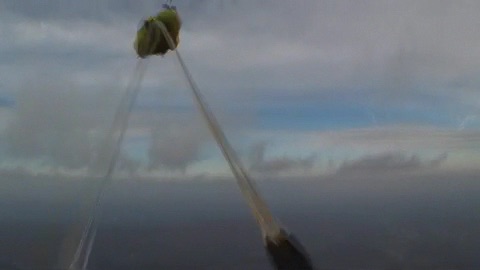

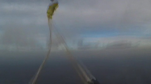

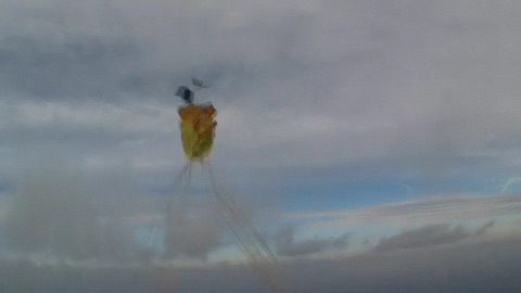

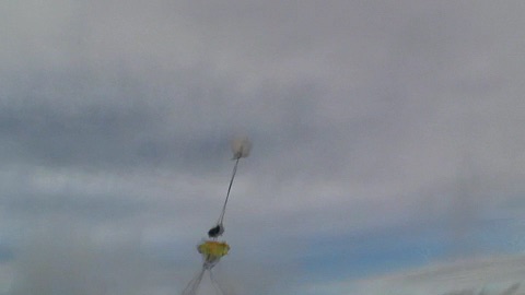

yuri_base 1 #10 October 8, 2018 Here's an illustration of cocoon hesitation. Yellow is center cell (tail wrap), cells get orange and red progressively towards the end cells; slider is red. t = 0 - canopy is out of the D-bag: [inline CocoonHesitation000.jpg] t = 20ms - cocoon is now open on the top (facing the sky), but closed on the bottom surface (facing the ground), as the relative wind hits it from the bottom at an angle due to canopy sagging below the wind line due to weight: [inline CocoonHesitation020.jpg] t = 40ms - cocoon is dancing still partially closed, slider possibly being shaken down the lines, still hidden by cocoon's tip: [inline CocoonHesitation040.jpg] t = 60ms - cocoon is still dancing, slider still not visible: [inline CocoonHesitation060.jpg] (unfortunately, cocoon goes out of frame, but it obviously doesn't look pretty out there) t = 133ms - cocoon is finally unwrapped, red slider is visible and inflated, but probably moved down the lines a bit due to shaking, and the canopy managed to make a full turn during the dance - hello, linetwists: [inline CocoonHesitation133.jpg] Android+Wear/iOS/Windows apps: L/D Vario, Smart Altimeter, Rockdrop Pro, Wingsuit FAP iOS only: L/D Magic Windows only: WS Studio Quote Share this post Link to post Share on other sites

yuri_base 1 #14 October 8, 2018 Ooops, the times should be multiplied by 10: 0.2s, 0.4s, 0.6s, and 1.33s. My math is terrible. 6 frames at 30fps is 200ms, not 20!Android+Wear/iOS/Windows apps: L/D Vario, Smart Altimeter, Rockdrop Pro, Wingsuit FAP iOS only: L/D Magic Windows only: WS Studio Quote Share this post Link to post Share on other sites

yuri_base 1 #19 October 9, 2018 >>> Anyway, I tried your method of leaving the slider grommets fully exposed. I did 7 WS jumps today and tried it on all of them. I dident notice any difference from how I normally pack. It dident open any faster from what I could tell and it certainly dident open any more on heading than it normally does (which is usually not on heading at all). <<< The difference is not necessarily noticeable. It won't be noticeable if, for example ZP is fresh and superslippery, since it unwraps itself very quickly, especially if it's wrapped lightly and a hole is left at the apex of the cocoon. It won't be noticeable if one uses non-collapsible PC, as continuous stretching of the packjob by inflated PC helps with quick unwrap of the cocoon. It won't be [much] noticeable if one pulls not from full WS flight (with canopy being extracted at a shallow angle), but collapses wings to kill forward speed and deploy "old way", falling more down than moving forward, since in this case, the mechanism for long hesitations (relative wind hitting the smooth bottom surface of the cocoon that sags under the windline under its weight) is not so strong. All this doesn't mean that the method with exposed slider doesn't work; only sudden disappearance of hard and twisted openings in the long run, like it was in my case, confirms that it works. I strongly believe this is the only, proper way of controlling the slider: it MUST be exposed to relative wind INSTANTLY when canopy is out of the bag. It must NOT be hidden by a cocoon. I believe the idea of wrapping the slider when PRO pack was invented and became mainstream, what, 40+ years ago? - was a wrong choice. And now, because of this huge momentum of being taught this for decades, we can't even fathom exposing the slider, we think that it's sketchy and will result in hard openings... while it's the opposite! The Emperor has no clothes!Android+Wear/iOS/Windows apps: L/D Vario, Smart Altimeter, Rockdrop Pro, Wingsuit FAP iOS only: L/D Magic Windows only: WS Studio Quote Share this post Link to post Share on other sites

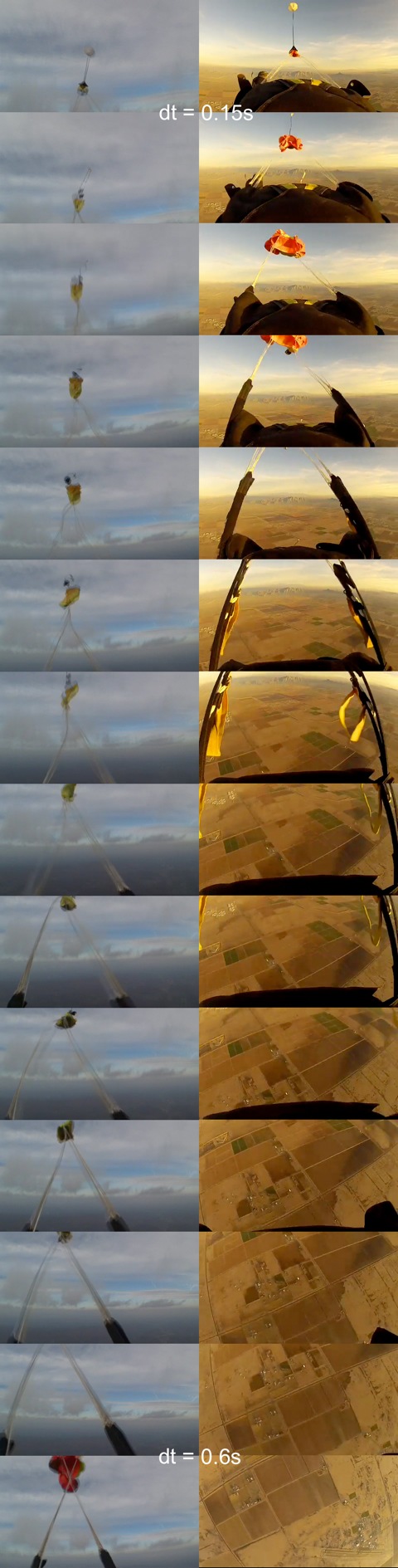

yuri_base 1 #20 October 9, 2018 Here's an illustration of cocoon hesitation leading to line twists and harder than normal opening, vs. exposed slider opening leading to immediate (but not hard), properly staged opening, with no useless altitude loss while trailing the dancing cocoon (dt=1/15s (2 frames at 30fps) is the step between frames (0.15s is a typo), 0.6s for the last frame): [inline CocoonHesitationVsExposedSlider.jpg] Note that the 1st thing that shows up when D-bag opens is yellow on the left (this is tail/cocoon, center cell is yellow) and red on the right (this is the slider), and slider is instantly inflated and quartered - this is what we want! Android+Wear/iOS/Windows apps: L/D Vario, Smart Altimeter, Rockdrop Pro, Wingsuit FAP iOS only: L/D Magic Windows only: WS Studio Quote Share this post Link to post Share on other sites

yuri_base 1 #23 October 10, 2018 An example of Cocoon Hesitation was posted above; here is an example of an opening (same canopy, Spectre 190) with the Exposed Slider method. The opening is more immediate, with stronger initial jolt on the shoulders due to towing the inflated slider in the first moments, but the openings are comfortable, just not wasteful of altitude. And I've had ~400 of such openings like this one, 1:1, virtually exact replica. Openings become very consistent, and with very good heading performance (thanks to inflated slider anchoring the heading). It feels like it even 'corrects' your body position! (because the inflated slider is hard to turn, it turns your body is you drop one shoulder; with cocoon-cigar, dropped shoulder spins the cigar very easily, besides its own dance) And... ZERO line twists. (before, linetwists were like 1 in 3-4 jumps, that would be >100 linetwisted openings out of 400 jumps!) I'm no longer jumping my skydiving canopy, so if anyone asks to take a video of packing or opening, I can't do this. If nobody jumps this pack job, the idea will be buried, but I'll remind again in 5 years, since in skydiving world any fresh idea takes decades to pick up.Android+Wear/iOS/Windows apps: L/D Vario, Smart Altimeter, Rockdrop Pro, Wingsuit FAP iOS only: L/D Magic Windows only: WS Studio OpeningWithSliderExposed.m4v Quote Share this post Link to post Share on other sites
