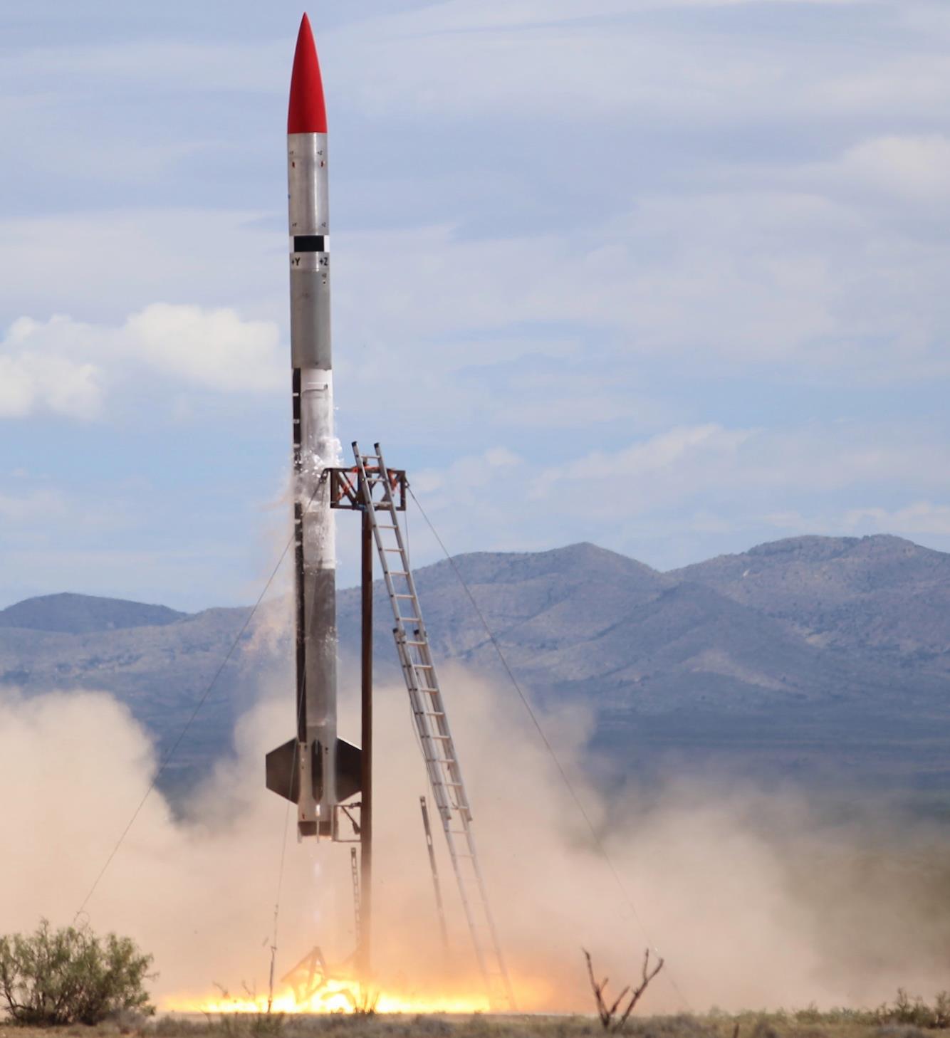

RiggerLee 63 #7 November 12, 2018 https://www.youtube.com/watch?v=VHPeGH7t_QQ&feature=youtu.be Here's an edited release. There was a couple of film crews out there. One from space port America and some other stuff going on. I'm not in the loop on any of this. I don't know if this is the final product or the first of several clips. It's mostly a bunch of B role. No flight footage from the rocket. Not even the rocket flying or landing under canopy although my ballute does make a brief cameo descending with the nose cone. So I have no idea what these people were thinking. It does have shots of all the usual suspects. And it has the launch shot from the trailer. This is actually a very cool, Oh Shit! kind of shot. I'll explane. DO to some plumbing issues we are not getting as high of a pressure to the LOX at the engine as we would like. We have reworked the plumbing to fix that but at the time we decided to short load the LOX. So as a result of that decision the milk stand, big heavy blast deflector that the rocket sits on prior to launch, rather then being bolted down to the pad was sitting on a set of large scales to allow us to weigh the LOX. Well some one apparently forgot their fluid dynamics and did not think to secure the milk stand in any way. Well when 5,500 lb or so of thrust hits the graphite plates and turns 90 deg they forgot that you get 5,500 lb of force sideways on the stand. Well it went scooting along the pad till it hit the launch rail which bowed and flexed. In fact it flexed enough that it pulled very hard in the lower launch lug of the rocket. It was still in that lower section of the rail when the milk stand hit the launch rail. It actually ripped the lug off the rocket where it was welded in to the lower bulk head of the fuel tank. This imparted a big tug to the base of the rocket. Some thing you really do not want to do. That is why you see it take a big curve away from the launch rail. Then the engine cranked all the way to the stop on the gimble brings it back and a little past vertical to bring it back over the pad and then away it goes on it's marry way. But when you see all of our faces that is why we are all saying "Oh, shiiiit!!!" They politely edit that out and play mood music all through the video, but if you can read lips you'll see it. Actually it was a great, absolutely grade A+ test for the control system. You couldn't ask for a better small perturbation test right off the pad. Speaking of which if you want to see how we used to do that test, if you scroll all the way down to the bottom of the You tube page you'll see an old Armadillo aero space video that includes them doing rocket tug of war during a hover which is actually how we used to do it when testing the control system. It also includes shots of all the same people minus about 10 years. Flash backs. LeeLee lee@velocitysportswear.com www.velocitysportswear.com Quote Share this post Link to post Share on other sites
Phil1111 1,256 #8 November 12, 2018 RiggerLee https://www.youtube.com/watch?v=VHPeGH7t_QQ&feature=youtu.be Here's an edited release. There was a couple of film crews out there. One from space port America and some other stuff going on. I'm not in the loop on any of this. I don't know if this is the final product or the first of several clips. It's mostly a bunch of B role. No flight footage from the rocket. Not even the rocket flying or landing under canopy although my ballute does make a brief cameo descending with the nose cone. So I have no idea what these people were thinking. It does have shots of all the usual suspects. And it has the launch shot from the trailer. This is actually a very cool, Oh Shit! kind of shot. I'll explane. DO to some plumbing issues we are not getting as high of a pressure to the LOX at the engine as we would like. We have reworked the plumbing to fix that but at the time we decided to short load the LOX. So as a result of that decision the milk stand, big heavy blast deflector that the rocket sits on prior to launch, rather then being bolted down to the pad was sitting on a set of large scales to allow us to weigh the LOX. Well some one apparently forgot their fluid dynamics and did not think to secure the milk stand in any way. Well when 5,500 lb or so of thrust hits the graphite plates and turns 90 deg they forgot that you get 5,500 lb of force sideways on the stand. Well it went scooting along the pad till it hit the launch rail which bowed and flexed. In fact it flexed enough that it pulled very hard in the lower launch lug of the rocket. It was still in that lower section of the rail when the milk stand hit the launch rail. It actually ripped the lug off the rocket where it was welded in to the lower bulk head of the fuel tank. This imparted a big tug to the base of the rocket. Some thing you really do not want to do. That is why you see it take a big curve away from the launch rail. Then the engine cranked all the way to the stop on the gimble brings it back and a little past vertical to bring it back over the pad and then away it goes on it's marry way. But when you see all of our faces that is why we are all saying "Oh, shiiiit!!!" They politely edit that out and play mood music all through the video, but if you can read lips you'll see it. Actually it was a great, absolutely grade A+ test for the control system. You couldn't ask for a better small perturbation test right off the pad. Speaking of which if you want to see how we used to do that test, if you scroll all the way down to the bottom of the You tube page you'll see an old Armadillo aero space video that includes them doing rocket tug of war during a hover which is actually how we used to do it when testing the control system. It also includes shots of all the same people minus about 10 years. Flash backs. Lee Thanks for the explanation. I thought gimbaled thrust corrected a off centerline launch condition. Quote Share this post Link to post Share on other sites
RiggerLee 63 #9 November 12, 2018 It does and it did correct for for it. That correction was through the gimbled thrust of the engine not aerodynamic in any way. It just takes time. That was a big jerk on the bottom of the rocket. It caused a big deviation, about 12 deg. That's big it's going to be a big woo-wo-wo of a curve to bring it not just back to vertical but back to center line. Proper damping involves a certain amount of over correction. The rocket has a lot of inertia in that axis. Depending on how much gimbal angle you have to work with it can take a bit of time to correct. LeeLee lee@velocitysportswear.com www.velocitysportswear.com Quote Share this post Link to post Share on other sites

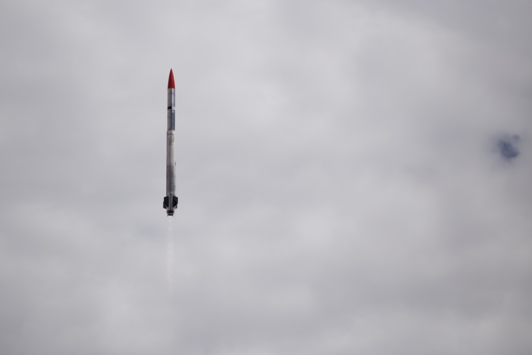

RiggerLee 63 #11 July 13, 2019 (edited) Little bit of video from the third flight. For the record this is not what it is supposed to do. Let's just say that there was a slight control/guidance issue. It would have made a free flyer proud. It was more then a bit frightening to watch it go into a flat coning spin right above us. That's over 1,500 lb of fuel/lox ready to drop in the middle of us if the cone gets to flat and it stops accelerating upwards. It did get going and the fins finally did provide us with enough stability to clear the area. Appogy was about 13,000 ft. Engine shut down do to IIP, it was about to exceed it's 7 km circle. That translates to about 500 mph over the top. Nose cone fired shortly after that, a bit slower but not by much. Nose tears off. Ballute inflates and whips the rocket around. 10 sec delay till it releases the main. We were only going about 150 mph as it came out so not too bad. Sewing the lines into the risers ala security 150 worked well. I'm pleased with that. And the ballute and cutter system certainly proved them selves that day. One break did not unstow till the very end. But it seemed to be flying it's pattern about 1000 ft low. I think there might be an issue with the terrain soft ware. So it landed as it was turning to base with out flaring. Cracked the boat tail and broke lose one of the actuators for the engine. No biggy. Found the nose cone, broken. Spent three days in the dessert looking for the ballute, no joy. That's a bummer. https://youtu.be/GlgN1bJWO48 https://youtu.be/-cTNevdDCN4 https://youtu.be/2qYF-0SwM94 Remember, you can use the hand to move the view around on the 360 fly cameras. So you can look down or up better the 180 deg. If the guys at Dekunu can figure out how to up load the flight data to their cloud I'll share the flight path as well. We had a couple of their altimeters on there for fun. There little units did good. Lee Edited July 13, 2019 by RiggerLee 1 Quote Share this post Link to post Share on other sites
