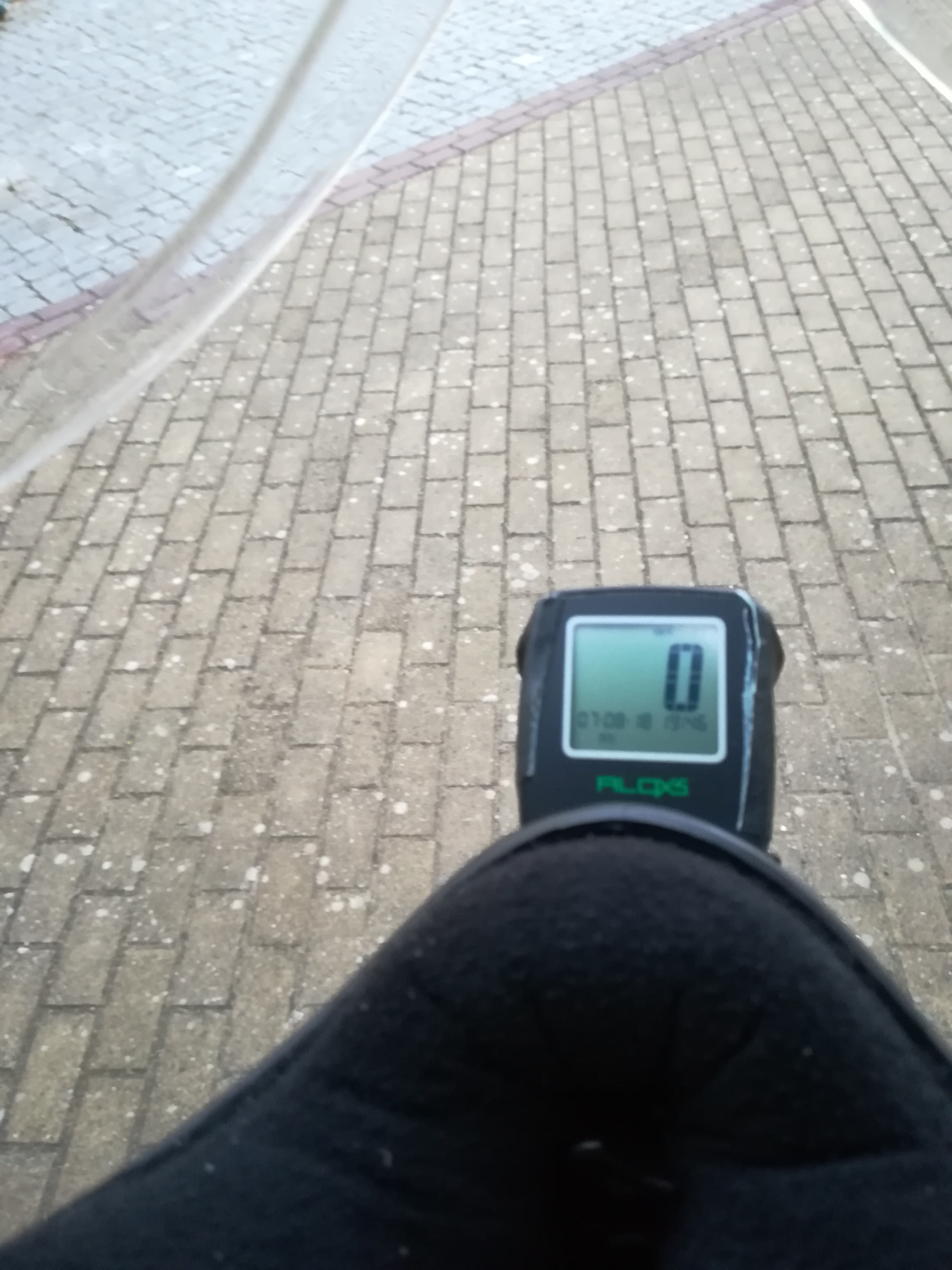

carvai 0 #4 August 25, 2018 An analog always on the wrist. Nowadays a digital in front of the eyes mounted on the helmet.Always visible in any type of jump. Quote Share this post Link to post Share on other sites

AtrusBatleth 0 #8 August 26, 2018 carvai An analog always on the wrist. Nowadays a digital in front of the eyes mounted on the helmet.Always visible in any type of jump. What kind of helmet mount? I've heard of the color-light based altis but I get the impression you are talking about something else.Max Peck What's the point of having top secret code names, fellas, if we ain't gonna use 'em? Quote Share this post Link to post Share on other sites
benlangfeld 1 #9 August 27, 2018 AtrusBatleth*** An analog always on the wrist. Nowadays a digital in front of the eyes mounted on the helmet.Always visible in any type of jump. What kind of helmet mount? I've heard of the color-light based altis but I get the impression you are talking about something else. Take a look at the attachment. Quote Share this post Link to post Share on other sites

AtrusBatleth 0 #13 August 29, 2018 benlangfeld****** An analog always on the wrist. Nowadays a digital in front of the eyes mounted on the helmet.Always visible in any type of jump. What kind of helmet mount? I've heard of the color-light based altis but I get the impression you are talking about something else. Take a look at the attachment. Thanks, I didn't see the attachment until I looked with my computer. Interesting, I had not seen a mount like that before.Max Peck What's the point of having top secret code names, fellas, if we ain't gonna use 'em? Quote Share this post Link to post Share on other sites
