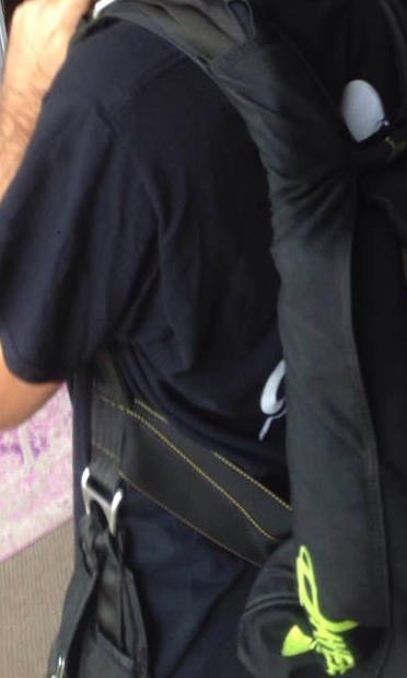

bigboysne 0 #12 August 9, 2018 This is a friend of me wearing it. He is way smaller than me and just threw it on his shoulders so don't look a the fit. Quote Share this post Link to post Share on other sites
RiggerLee 63 #13 August 9, 2018 The better it fits you the more you will like it. The two of you are going to be together for a long time. I've seen rigs out live marages. You would like for the hip junction or ring to be at the point of rotation of your leg. If it's two far forwards of that point the main lift web shift upwards and will loosen when you lift your legs, like in a sit. The rig will lift off your shoulders in a sit and that slack will allow the rig to hinge up off your back. This can range from annoying to dangerous. In the worst case you could in theory roll out the back. That has happened with a couple of badly fitting student rigs but it can happen with sport rigs if the lateral is too long or particularly if there is a lot of stagger and a small rig fits high on their back. There are people that can bend over and slide their rig off their shoulders over their head. Incut lats help with this. They do not loosen as much when the main deploys. So the measurement stays consistent. Got to go to work. LeeLee lee@velocitysportswear.com www.velocitysportswear.com Quote Share this post Link to post Share on other sites
