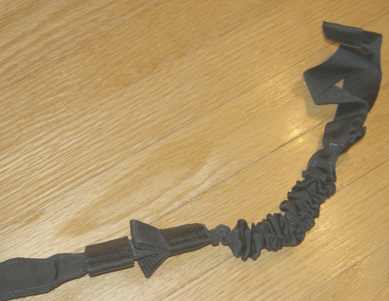

pchapman 280 #13 July 27, 2018 The UPT ones: Photo attached for reference. This was taken in 2010 so I don't know if design details changed. I never liked the concentric scrunched up bridle system for the kill line & bag retainer line, but the no-metal bag to bridle design looks nice. Quote Share this post Link to post Share on other sites
betzilla 56 #14 July 27, 2018 I'm pretty sure UPT is still using that same design, though it's been a few months since I've assembled a sparkly new Vector. This design requires a #4 grommet too (a good thing to know in case you're thinking of putting a UPT PC on some other manufacturer's d-bag). The type 4 stop can pull through a #5 when it gets broken in and softens up a little. I like the fully enclosed kill-line in the scrunched up bridle. Two slack lengths of tape/line in the deployment bag (like you get with non-enclosed designs) kind of bugs me -- I'm not aware that's ever caused trouble, but it's not that hard for me to imagine it could, somehow... Quote Share this post Link to post Share on other sites
Deyan 36 #15 July 27, 2018 gowlerk You probably have a Vector. It uses no hardware at all to attach the bridle to the bag. But they are the only ones I've seen that can do so. VSE is using similar setup on Infinity, although they use the kill line to connect to the canopy. Very smart design. Aerodyne also did something similar like UPT for a short period of time. Like Betzila pointed out, those should be used on D-bags with grommet #4 only. Unfortunately so many jumpers think they know better when they swap parts from rig to rig."My belief is that once the doctor whacks you on the butt, all guarantees are off" Jerry Baumchen Quote Share this post Link to post Share on other sites
riggerrob 644 #16 July 28, 2018 ***I'm pretty sure UPT is still using that same design, though it's been a few months since I've assembled a sparkly new Vector. This design requires a #4 grommet too (a good thing to know in case you're thinking of putting a UPT PC on some other manufacturer's d-bag). The type 4 stop can pull through a #5 when it gets broken in and softens up a little. ———————————————————————————— I have also seen a few bridles attached to d-bags with fat Dacron soft-links. These were the one-use-only soft links that pre-dated Parachutes de France’s re-useable soft links. Fat suspension line is the key to preventing accidental pull-through. Quote Share this post Link to post Share on other sites
