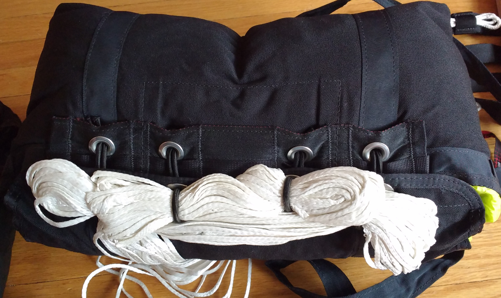

JTH 0 #9 May 31, 2018 was refering to these beauties that I was using first and hard 2 hard openings, prior to switching over to double wrapped rubber bands which I am currently using. (please see attachement) Thanks for all your comments. Quote Share this post Link to post Share on other sites
pchapman 279 #10 May 31, 2018 To assist the thread in understanding the bungee stuff, see the attached photo for an example of how recent Wings bags have been built to use bungees. (Their thinking is clearly different than that of the many manufacturers that say to use, or imply the use of, double stowed elastics.) Quote Share this post Link to post Share on other sites
JTH 0 #11 May 31, 2018 Thanks. That's exactly how mine were installed. They came stock with the new wings SSdbag when I got it last year and figured I'd give them a try. They retain the lines with considerably less traction then even single stow on a large rubber band. With my HMA700 lines anyway. Quote Share this post Link to post Share on other sites
gowlerk 2,262 #12 May 31, 2018 Oh, I've not seen one of those yet. What a bad idea. Quote Share this post Link to post Share on other sites

LeeroyJenkins 3 #14 May 31, 2018 gowlerkOh, I've not seen one of those yet. What a bad idea. I quite enjoy mine, I haven't had any hard openings yet with the bungee, and I only use the middle 2. You can adjust and tighten them just like a closing loop. There is a place to put rubber bands on the bag if that is your preference. Quote Share this post Link to post Share on other sites
gowlerk 2,262 #15 May 31, 2018 Oh, they'll work just fine. Until they don't. Like when they wear out and you don't replace them. Or, as Westerly pointed out, you need one to break for some reason. Quote Share this post Link to post Share on other sites
LeeroyJenkins 3 #16 May 31, 2018 gowlerkOh, they'll work just fine. Until they don't. Like when they wear out and you don't replace them. Or, as Westerly pointed out, you need one to break for some reason. That doesn't differ from rubber bands. Quote Share this post Link to post Share on other sites
gowlerk 2,262 #17 June 1, 2018 LeeroyJenkins***Oh, they'll work just fine. Until they don't. Like when they wear out and you don't replace them. Or, as Westerly pointed out, you need one to break for some reason. That doesn't differ from rubber bands. I differs a lot from rubber bands. Bungee cord loses it's stretch and grip long before the nylon sheath will break. And the breaking strength of that sheath is more than enough to resist the pulling power of a P/C. Rubber bands just break. Quote Share this post Link to post Share on other sites
LeeroyJenkins 3 #18 June 1, 2018 gowlerk******Oh, they'll work just fine. Until they don't. Like when they wear out and you don't replace them. Or, as Westerly pointed out, you need one to break for some reason. That doesn't differ from rubber bands. I differs a lot from rubber bands. Bungee cord loses it's stretch and grip long before the nylon sheath will break. And the breaking strength of that sheath is more than enough to resist the pulling power of a P/C. Rubber bands just break. Edit: confused threads. "They will work just fine until they don't" - that can be said about rubber bands too. While I don't feel like purposefully causing a bag lock just to prove you wrong, rubber bands are not guaranteed to break. Will they break before a bungee? probably. Is human error/poor gear maintenance the fault of the equipment? No. So yeah, rubber bands will work until they don't. More on topic, as long as your bungees were in good shape they wont cause a hard opening. As i said before I only use two. Quote Share this post Link to post Share on other sites
