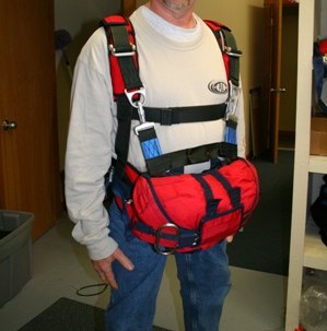

JerryBaumchen 1,493 #4 April 8, 2018 Hi Sabre, Quote Is it possible to attach front-mounted round reserve to ordinary skydiving container? Yes, many ways to do it. The attached photos are one way. You could easily just thread the 'chest risers' thru the 3-rings in a similar manner. The 'L' bar links go under all harness webbing straps. Jerry Baumchen Quote Share this post Link to post Share on other sites
RiggerLee 63 #5 April 8, 2018 There are many ways that this has been done. Legally it's much simpler to add an attachment point for a main or test canopy. You would like to put the cutaway canopy in the chest mount or at least the secondary main. It's harder to make the argument that that attachment point is for a reserve. It hasn't been TSO drop tested. At the very least you would have to do paperwork on it through the FSDO. Been there done that. But if it's just for a cutaway canopy then it's just a toy you're playing with in the air and as long as it doesn't compromise the TSO'd system... fair game? In any case you can generally get away with it. Ways to do this have been discussed before. Some better then others. The example shown strikes me as a good way to get bitch slapped by that B-12 and it does not lend it self to being cut away so not well suited as a main. Could put 3 rings on it but it could still whack you. If you're making a test canopy cut away, better to put a separable three ring on there below that ring so that it would be less prone to whipping around. What he's showing you there was probable used in TSOing that pilot rig. Probable never regularly deployed. If he did have to use it he would probable be hand deploying it past a may west or torn up canopy from an inversion as the "main" was not designed to be cutaway. It's a suitable solution for that purpose. If you ever really needed to use it in anger, like a total on the "main", a broken orbital in your eye socket would be to least of your worries. But do you want to risk loseing an eye or getting a concussion on every opening? No offence to his attachment point but you can do better. Also just as a note. RW-8's not the best ring to attach a snap to. It's not designed for that concentrated load from the thin snap. I've broken them that way. They beak at about 1/3 the normal point of failure. And yes I've built kevlar risers heavy enough to beak rings. If you look at snap rings you'll see they are much thicker or pointed to load at a small radius to match the snap. And use the heavier snaps designed for reserves. They're rated for higher loads. It's assumed that one may come lose. And cross connectors. If you're going to build risers for a belly mount reserve don't forget them and build it in a non pealing way that could survive an opening on one snap. LeeLee lee@velocitysportswear.com www.velocitysportswear.com Quote Share this post Link to post Share on other sites

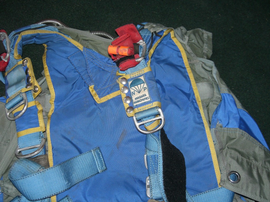

pchapman 281 #6 April 8, 2018 Good point on the point loading of harness rings - obvious in itself but its practical effect was unclear. Most of us don't have specs on that kind of stuff, beyond "it's good for X proof load". Something for me to consider. (I went back and looked at the RW-1-82 bulletin on weak rings, and even there they used webbing folded to 1" wide to do the 2500lb proof loading of the harness ring.) You were wondering about getting bitch slapped by the B-12 if one has rings to attach a belly mount, on a section of webbing. Ok, that's at possible hazard. Yet I do have a rig from the '70s with extensions for the belly mount attachments, giving a similar geometry. I think the idea is to load you more vertically (if the belly mount is used) by pulling from the shoulders, without having the belly mount sitting just under your chin. A photo is attached. It wasn't TSO'd as it is from Canada. If the belly mount is used, the short riser hidden under the mudflap pops the snaps and rotates up from the Capewell attachment point. So I wonder, were there American rigs built like that too? Anyway, that rig suggests that even if Baumchen's method does have its hazards for your face, a similar configuration also existed on some regular belly mount rigs in the '70s. Thanks. Quote Share this post Link to post Share on other sites
