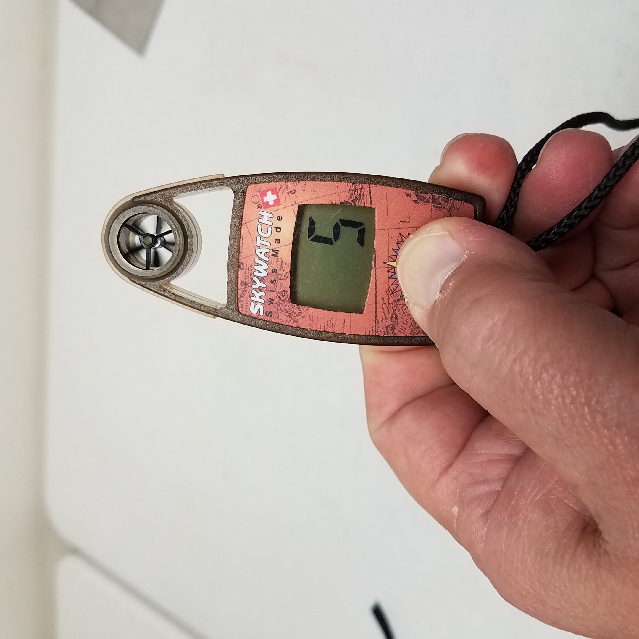

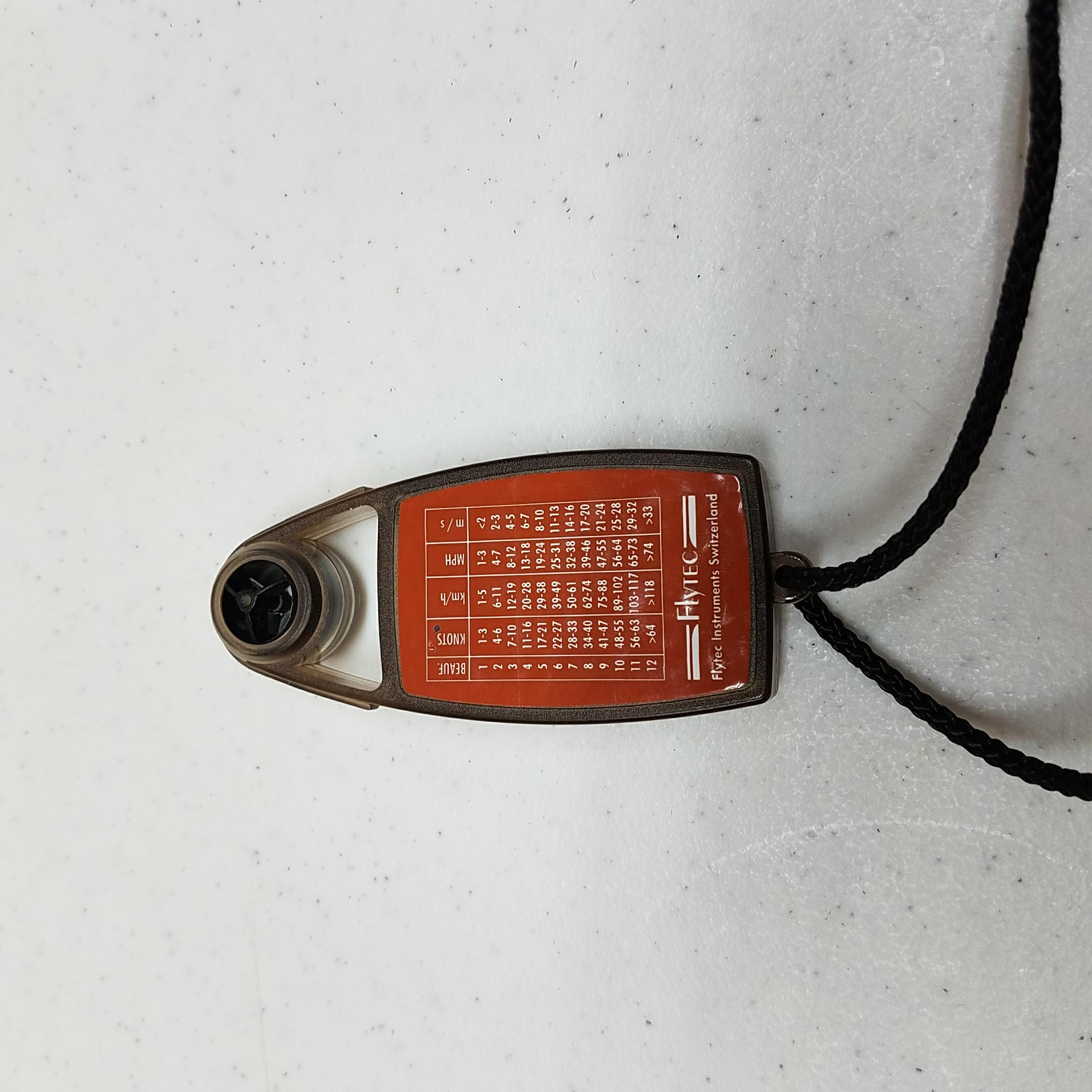

councilman24 37 #12 April 12, 2018 I bought this thumb size anemometer around 25 years ago. Battery not replaceable but still going. As simple as possibke but was 15 or 20 bucks. Works for cheap imprecise but comparable measurement of canopy speed. Looks like company has went up scale. I'm old for my age. Terry Urban D-8631 FAA DPRE Quote Share this post Link to post Share on other sites
