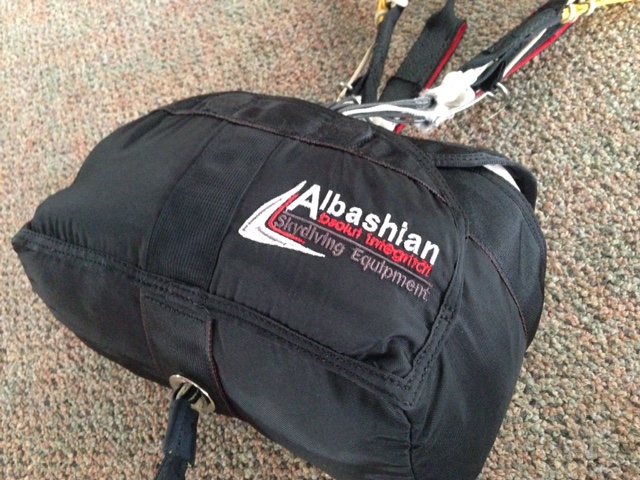

albashian 0 #23 February 1, 2018 The design of this fully magnetic deployment bag nearly eliminates any potential for an out-of-sequence deployment. Has been jumped in nearly every discipline including wingsuiting and subterminal with no issues. Packs fast.....packs simple....works simple. Unmatched quality. Quote Share this post Link to post Share on other sites
