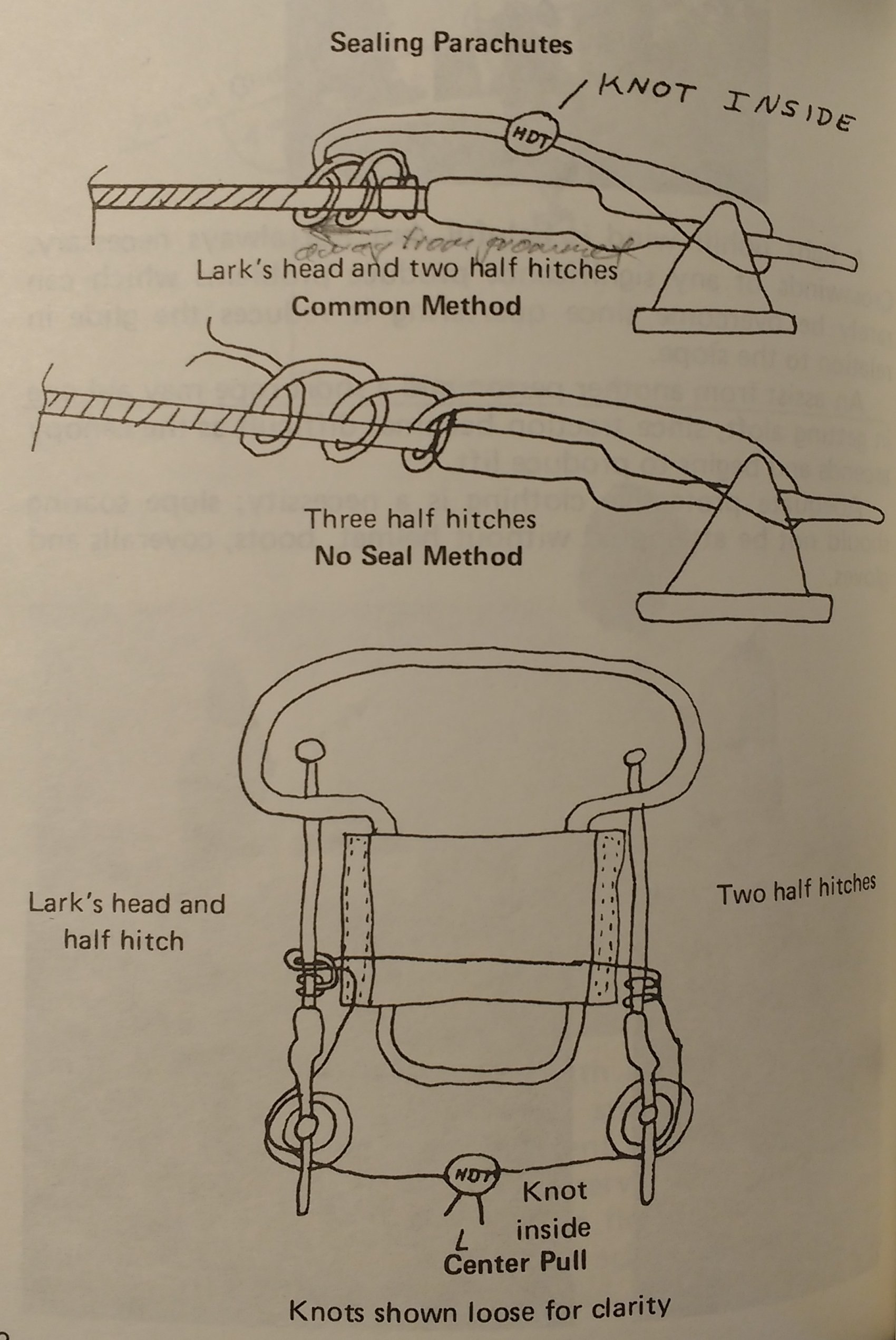

pchapman 279 #7 January 19, 2018 Ok, you want further back. I can do Poynter's I, section 7.92.2. Attached. And that shows pin and cone. If you want some original military manual... I'll let someone else step up. I guess we riggers could get into some discussions about seals. I don't recall the details, but I don't think the FAA specifies much, leaving it to the manufacturer -- but I haven't checked the FAR's. Then if the manufacturer doesn't specify much, it leaves it vague. But if one tries to not use a lead seal, the FAA objects even if the manufacturer's instructions allow it. "We won't tell you what to do... unless we don't like it." (UPT for example in a current Vector III manual just says "seal", with a fuzzy picture of a typical seal on a rig. No instructions. Hmm, the ends of the thread aren't knotted, unlike in that Parachute Rigger's Handbook version.) Quote Share this post Link to post Share on other sites

gb1 3 #11 January 19, 2018 When I received my senior riggers certificate in about 1973, I had to tie a surgeons knot completely crushed by the lead seal as taught by Dan Latchford at Midwest Parachute Sales and Service in Novi, Mi. He had showed me a pamphlet with the specs. Our study guide was Air Force and Navy manuals. Survival Equipmentation I and II. If the new accepted method is to leave the knot outside the seal as it appears in the new manual, do we buy that? Who wrote that manual? Did not mean for this thread to go this far. If there is no reply from Terry, the document I remember must not exist. Thank's for your time. GB Quote Share this post Link to post Share on other sites
gowlerk 2,259 #12 January 19, 2018 Quote If the new accepted method is to leave the knot outside the seal as it appears in the new manual, do we buy that? The text says to position the knot within the seal. Same as you, and I were taught. Quote Share this post Link to post Share on other sites
