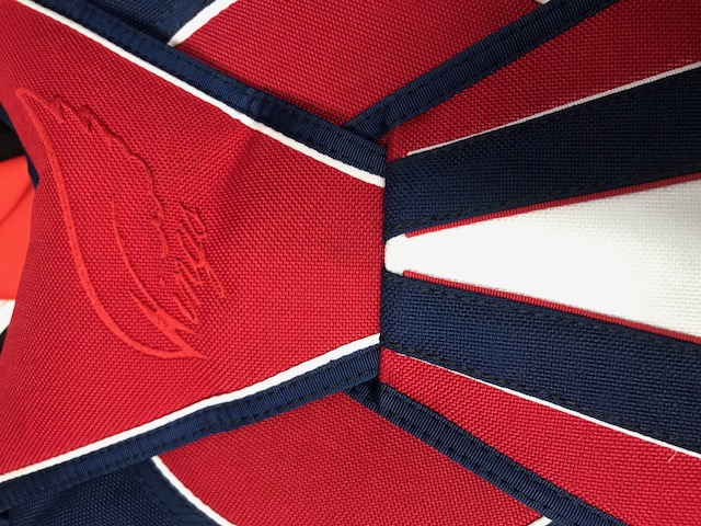

LeeroyJenkins 3 #37 June 20, 2018 New reserve pin cover is super easy to check. Quote Share this post Link to post Share on other sites

betzilla 56 #39 June 21, 2018 QuoteNew reserve pin cover is super easy to check. What's "new" about it? That looks identical to the same 2 square-inch section of any Wings I've ever seen. Also, your pin isn't seated all the way. Quote Share this post Link to post Share on other sites
LeeroyJenkins 3 #40 June 21, 2018 betzilla Quote New reserve pin cover is super easy to check. What's "new" about it? That looks identical to the same 2 square-inch section of any Wings I've ever seen. Also, your pin isn't seated all the way. The person I was talking to said it was difficult to check. I assume his experience was with an older wings since my 2018 Wings’s is easy to check. Edit: Attached pictures. Quote Share this post Link to post Share on other sites
