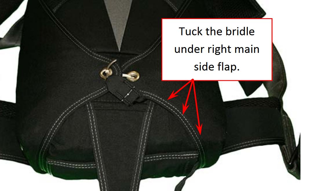

tripp9r 2 #26 March 23, 2018 mathrick Here you go: Am i the only one wondering how damn long ur loop is? Quote Share this post Link to post Share on other sites
mathrick 2 #27 March 23, 2018 Fairly long, as designed for that rig :). It's the Vector-style flap order, where the grommets are not intended to overlap with the correct length of closing loop. Instead, the stitching on the side flaps lining up with the pin protector pocket is a rough guide. I know it looks excessive, but the pin really has enough tension in there."Skydivers are highly emotional people. They get all excited about their magical black box full of mysterious life saving forces." Quote Share this post Link to post Share on other sites
Deimian 43 #28 March 26, 2018 I jump a vector. My flaps overlap way more than that. It looks to me like the loop is way too long. Have you checked with your rigger? Quote Share this post Link to post Share on other sites
dgw 8 #29 March 26, 2018 Deimian I jump a vector. My flaps overlap way more than that. It looks to me like the loop is way too long. Have you checked with your rigger? His side flaps look pretty similar to the manual image to me. (I am not a rigger.) Quote Share this post Link to post Share on other sites
erdnarob 1 #30 April 1, 2018 On a Vector 3, if the 2 side flaps biding tapes overlap as seen on the picture, everything is fine.Learn from others mistakes, you will never live long enough to make them all. Quote Share this post Link to post Share on other sites
