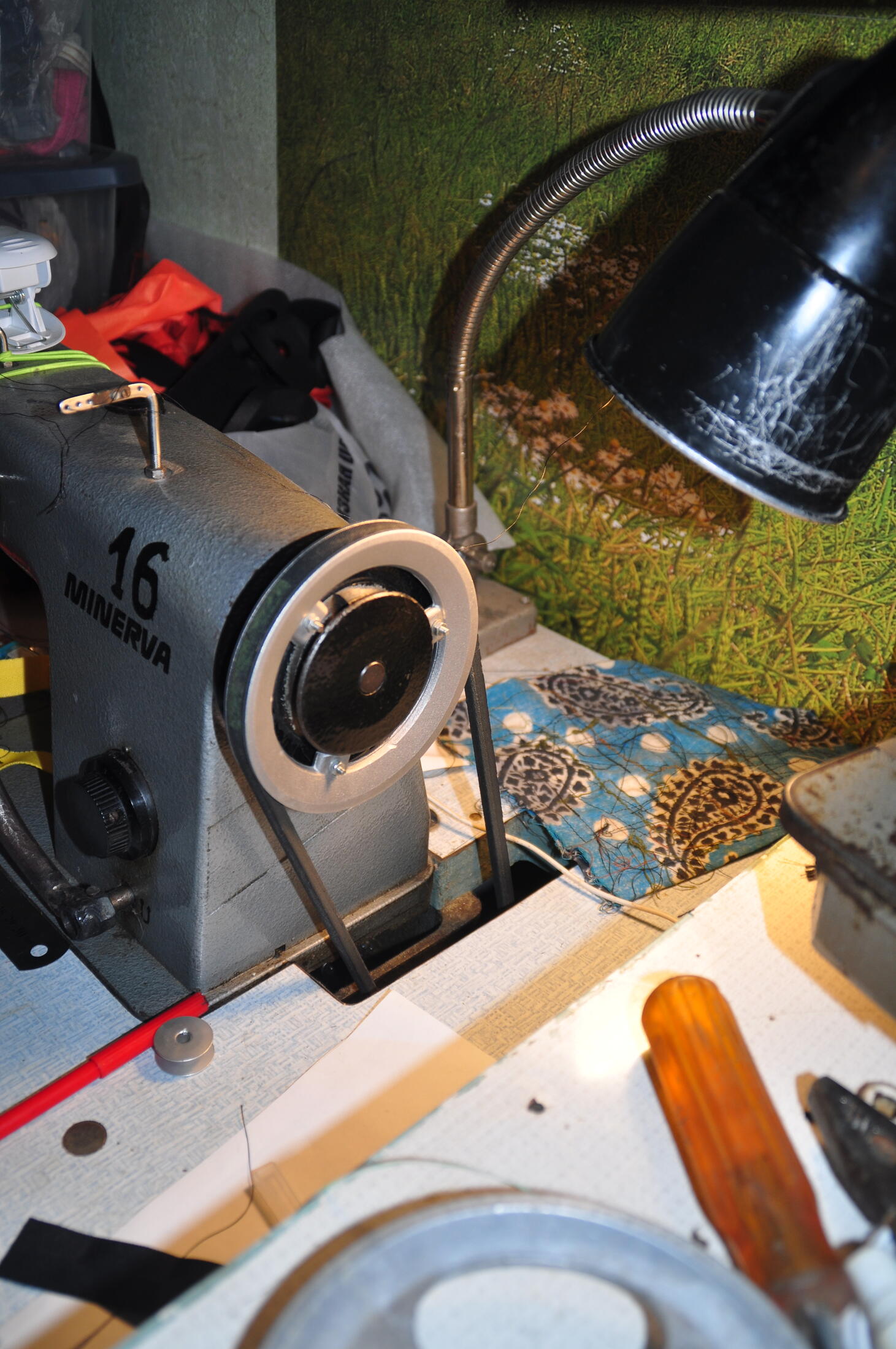

Veis 29 #24 January 15, 2021 To slow down sewing and control the needle, and for more torque too, we make gearboxes out of cheap components like this one. Total conversion ~ 6:1 Its nice sewing... Quote Share this post Link to post Share on other sites
