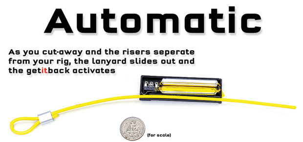

Chris-Ottawa 0 #5 July 30, 2015 This looks great in my opinion and I wish them the best of luck. Seems to be very compact and simple. I doubt I'd pay a subscription, but I'm certain that some people will. Good on you guys! One question. Are the electronics (I'm guessing the GPS module) exposed like the picture shows inside of the riser? If that's the case, I believe that will be a HUGE design flaw. Here are some thoughts: A) Wires/Solder points will fail from repeated stress from packing and curving around the harness B) The electronics module will be crushed or damaged from repeated deployments from the riser covers or just general use. I assume you will be sealing it in silicone or something? C) What about moisture in freefall/swoop pond on the electronics (or the activation cable) Maybe include an o-ring if it's not already, and silicone the entire electronics module? D) Cold weather - While jumping, will these wires easily bend when partially frozen and deployed, or while packing on a cold day? I'm not intending to be an ass, just providing constructive criticism that can hopefully be considered in the final product (if they haven't already). Keep in mind that I'm looking at a picture and making best guesses... I'd be curious to hear their thoughts on the abuse and how that will be or can be mitigated. I know that if the circuit board was included in the case, it would be much improved, but that's not what it looks like. ***Also, there are several spelling errors on the campaign page. [inline electronics.jpg]"When once you have tasted flight..." Quote Share this post Link to post Share on other sites

wolfriverjoe 1,523 #8 August 1, 2015 Talked with the people about this. I'm at Summerfest right now. The unit is encased in a "boot" sort of thing. Fully protected. The pic is to show what it looks like inside. I'm not sure about water resistance. The basics have been covered. GPS signal goes to a cell signal sent to their place. Then a text is sent to a (or several) cell phones, and the app will let the owner see exactly where it is. Price is around $170 (USD), service is $99/year or $500 for "lifetime", which will follow the user if there is a device upgrade in the future. The point was made that it could be used as a "find me" device too. If someone lands out and is hurt, they could (in theory) pull the cable out and activate it. If they had set it up to send a text to a second phone (manifest or jump partner or whatever), it would be simple to find them. FWIW, after spending quite a while searching for an "out-lander" from last night's sunset jump, cell phones are being required tonight. I thought about it and will probably pass. I have a fairly old Sabre2, not worth a ton of money. But I know of several people who have lost brand new (or nearly so) Valkyries. Worth it for them, probably."There are NO situations which do not call for a French Maid outfit." Lucky McSwervy "~ya don't GET old by being weak & stupid!" - Airtwardo Quote Share this post Link to post Share on other sites

findmycanopy 0 #18 August 16, 2015 Hey Chris! My name is Brendan Pope, I'm one of the inventors of the Get It Back. Myself and my partner Taneva Baker have spend the last ~18 months working on this project, and we're excited to finally be able to announce it to the world. To answer your questions: QuoteAre the electronics (I'm guessing the GPS module) exposed like the picture shows inside of the riser? No, the electronic module as well as the antenna are encase in a solid (but flexible) silicone rubber coating, in addition to having some protection from the installation pouch. We have it expose in the photos to give a better idea of what's inside and what sort of components we're using. QuoteWires/Solder points will fail from repeated stress from packing and curving around the harness The wiring we're using is an extremely fine multi-strand designed for tiny bend radii and very frequent flexing in industrial environments. While we can't make everything last forever, they are extremely robust and should last for years, even when used in Tandem rigs and getting packed/deployed 15 times a day. The antenna connection is not soldered, but a micro-snap connector that is reinforced with a solid coating of epoxy (similar to what's used in many other personal tracking devices, such as you'd find on various GPS pet tracking collars and locator beacons). It's extremely strong, and will easily take any kind of reasonable abuse that you can throw at it. If something hits you hard enough enough to make this thing disconnect, and you've got much larger problems. :) QuoteThe electronics module will be crushed or damaged from repeated deployments from the riser covers or just general use. I assume you will be sealing it in silicone or something? Yup! It's a very specific grade of silicone rubber that is very flexible, but also abrasion and impact resistant. This coating, combined with the neoprene pouch that installs it onto the riser, give a very good amount of protection from normal usage. I'm sure if you lay the riser out on the ground and whack it a bunch of times with a sizable hammer you could probably damage it, but I'd recommend not using a hammer to pack your rig. QuoteWhat about moisture in freefall/swoop pond on the electronics (or the activation cable) While we do not have the initial budget to take the device through official IEC testing in a laboratory (as detailed here: https://en.wikipedia.org/wiki/IP_Code) and satisfy the legal requirements for advertising something as “Waterproof”, we believe that the design of the device will render it immune to damage from short-term or incidental contact with water. So if you take a dunk in the swoop pond, you should be fine. The replaceable battery pack is not currently waterproof. While there is no danger in submerging it, corrosion on the internal switch could inhibit it from activating properly. Because of this, we recommend replacing the battery pack if the device does get fully submerged. Replacement battery packs will be readily available and should sell for ~$20. QuoteCold weather - While jumping, will these wires easily bend when partially frozen and deployed, or while packing on a cold day? Yup! Very easily, they're extremely flexible. The only real effect from cold is on the battery pack, below -30c its transmit time begins to drop off dramatically. Feel free to ask me any other questions you've got about the device! We've been getting a ton of questions about it, and we've been posting some of the more common ones on our FAQ here: http://findmycanopy.com/faq/ *Edits* typos and links Quote Share this post Link to post Share on other sites
