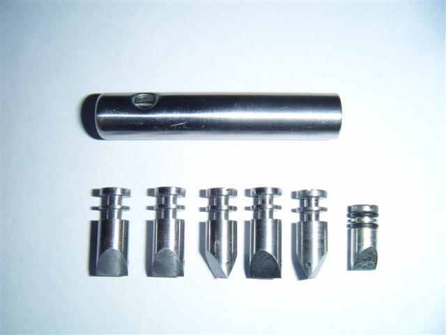

df8m1 24 #257 February 10, 2018 Prototype cutter blades ready to be hardened, then the cutting edge lapped. I would like to do some cutter tests later next week. Note: the blade on the right is a Cypres cutter blade for reference. Quote Share this post Link to post Share on other sites
skydiverek 63 #258 February 11, 2018 df8m1Prototype cutter blades ready to be hardened, then the cutting edge lapped. I would like to do some cutter tests later next week. Note: the blade on the right is a Cypres cutter blade for reference. Make sure it is hard enough. Argus' blade was not... See the whole report (in English) here: http://mib.gov.pl/mediakomisje/archiwum/2009562RKPKBWLang.pdf . Quote Share this post Link to post Share on other sites
df8m1 24 #259 February 11, 2018 skydiverek***Prototype cutter blades ready to be hardened, then the cutting edge lapped. I would like to do some cutter tests later next week. Note: the blade on the right is a Cypres cutter blade for reference. Make sure it is hard enough. Argus' blade was not... See the whole report (in English) here: http://mib.gov.pl/mediakomisje/archiwum/2009562RKPKBWLang.pdf . Very aware of the Argus cutters. The Argus blade design, (cylindrical), and the large hole in the cutter body allowed the grommet to drop down into the cylinder, so the blade would strike the grommet before the loop. That type of blade edge is very thin and delicate, prone to bending. My blades are made from 440C Stainless and hardened to RC 58-60. The blade design is the same as chisels which are made to cut by blunt force. One of the tests I would like to do is to thread a loop through the cutter, suspend the cutter in a container and fill it with steel shot so the cutter is buried, then fire it. I have no expectations for this test, purely curious to see if the blade will push the shot out of the way and cut the loop. This test will be conducted within a bullet proof enclosure in case things get interesting.. Safety first.... Quote Share this post Link to post Share on other sites
mxk 1 #260 February 11, 2018 I would be curious to see a test where you try to cut an untensioned closing loop. Cutting a loop under tension is much easier. This test would simulate what may happen if the cutter fires a split second after the pin is pulled by hand or RSL. Quote Share this post Link to post Share on other sites
mark 107 #261 February 11, 2018 df8m1Very aware of the Argus cutters. The Argus blade design, (cylindrical), and the large hole in the cutter body allowed the grommet to drop down into the cylinder, so the blade would strike the grommet before the loop. IIRC, the problem manifested when the closing loop did not go straight through the cutter. The blade would first strike the top (or bottom) side, causing it to tumble slightly, then jam on the opposite side because of misalignment. For Argus, the size of the hole compared to the diameter of the cutter body is not that different from Cypres and Vigil cutters. I do not recall a grommet strike being identified as an issue in any of the problematic incidents. -Mark Quote Share this post Link to post Share on other sites
LeeroyJenkins 3 #262 February 11, 2018 df8m1Prototype cutter blades ready to be hardened, then the cutting edge lapped. I would like to do some cutter tests later next week. Note: the blade on the right is a Cypres cutter blade for reference. Out of curiosity, why did you make you cutter so much bigger than the cypress cutter, while what looks like maintaining the same minimal cross sectional area? Quote Share this post Link to post Share on other sites
df8m1 24 #263 February 11, 2018 mxkI would be curious to see a test where you try to cut an untensioned closing loop. Cutting a loop under tension is much easier. This test would simulate what may happen if the cutter fires a split second after the pin is pulled by hand or RSL. All tests will be at zero loop tension. A consistent, clean cut is the requirement with the loop just laying in the cutter. Quote Share this post Link to post Share on other sites
df8m1 24 #264 February 11, 2018 mark***Very aware of the Argus cutters. The Argus blade design, (cylindrical), and the large hole in the cutter body allowed the grommet to drop down into the cylinder, so the blade would strike the grommet before the loop. IIRC, the problem manifested when the closing loop did not go straight through the cutter. The blade would first strike the top (or bottom) side, causing it to tumble slightly, then jam on the opposite side because of misalignment. For Argus, the size of the hole compared to the diameter of the cutter body is not that different from Cypres and Vigil cutters. I do not recall a grommet strike being identified as an issue in any of the problematic incidents. -Mark There was another incident here in the USA where the Argus blade hit a grommet and failed to cut the loop. As I recall, there was a witness mark on the grommet that was on top of the cutter. Kirk Smith of Para Concepts did some independent tests and reproduced the blade strike failure. His report is on line somewhere. Quote Share this post Link to post Share on other sites
df8m1 24 #265 February 11, 2018 LeeroyJenkinsOut of curiosity, why did you make you cutter so much bigger than the cypress cutter, while what looks like maintaining the same minimal cross sectional area? A larger diameter at the same pressure generates more force. From a failure mode aspect, if the pyro cartridge should, for some reason, not generate full pressure, or one of the seals fail, I want to have some margin built in. It will be interesting to see how low the pressure can be and still cut the loop at zero loop tension. It also allows for larger seals to be used. I am using quad rings instead of traditional 0-rings. Some of the tests will be done with only using one seal. Quote Share this post Link to post Share on other sites
LeeroyJenkins 3 #266 February 11, 2018 df8m1***Out of curiosity, why did you make you cutter so much bigger than the cypress cutter, while what looks like maintaining the same minimal cross sectional area? A larger diameter at the same pressure generates more force. From a failure mode aspect, if the pyro cartridge should, for some reason, not generate full pressure, or one of the seals fail, I want to have some margin built in. It will be interesting to see how low the pressure can be and still cut the loop at zero loop tension. It also allows for larger seals to be used. I am using quad rings instead of traditional 0-rings. Some of the tests will be done with only using one seal. Ah, yeah. I figured it was o-ring related. Those things are annoying to engineer Quote Share this post Link to post Share on other sites

df8m1 24 #273 March 22, 2018 At some point I will. With this first batch of cutters I was testing different cylinder materials, and loop hole / grommet face geometry, but the cutting aspects were the same (same blade material, hardness and geometry). For some tests, I turned the blade as much as 30 degrees off perpendicular to the loop, some the loop holes were in slightly different places / sizes, etc.. The last version (not in the video) was shaped to help with rigging. My intent was to reuse the blades, but it is too much of a PIA to get them out once they are fired lol.. The blades hold up well. If I think about it I will take a picture of a used blade. Now that I am happy with the cylinder material and, internal / external aspects, I will make more blades and cylinders based on the last design, and evaluate overall performance in a rig. I will also make more videos from different angles, put them together and up load them to YouTube. I just thought people would appreciate a sample vid. Quote Share this post Link to post Share on other sites

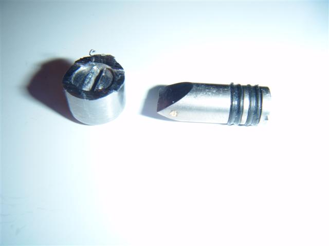

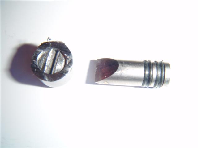

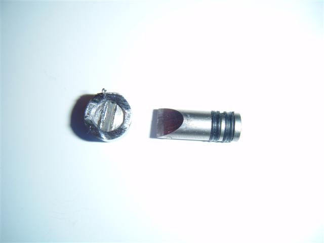

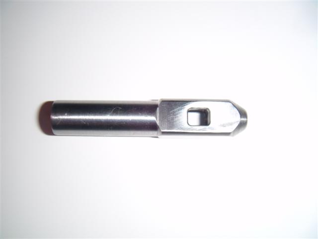

df8m1 24 #274 March 27, 2018 Attached are three pics of a fired blade and anvil. Anvil material is 17-4 SS at 34Rc. Blade is 440C SS at 58Rc. Also a pic of an assembly view of the finial design cutter and a pic of the body by itself. Quote Share this post Link to post Share on other sites
