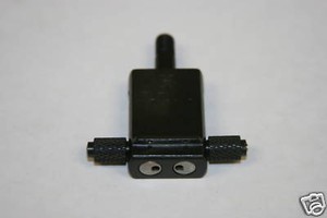

dpreguy 14 #6 March 27, 2015 When you get the new needle bar see if you can get the new "squid" needle bar. It has buttons on the side which allows you to raise each needle up into a non sewing position. It is great for turning a 90 degree corner. Steps: . You sew up to the corner and sink both needles into the work . You raise the left needle and spin the work 90 degrees. . Hand crank the needle bar to the up position, pause, then lower the left needle, so it will sew again It produces a perfect 90 degree corner With a regular needle bar, you have to turn the work with the needles up =no pivot point. The "squid" needle bar invention is pretty cool and worth the money. Quote Share this post Link to post Share on other sites

monkycndo 0 #8 March 28, 2015 This, but in 3/16". As long as the needle bar has a removable needle clamp, it will work. The thing to look for is that the clamp matches the size and thread pitch of the needle bar. The needle bar for my 339 needs a 5mm post on the clamp. Some of the clamps are 4.5mm.50 donations so far. Give it a try. You know you want to spank it Jump an Infinity Quote Share this post Link to post Share on other sites
gowlerk 2,277 #9 March 28, 2015 Cool. But who sells it?Always remember the brave children who died defending your right to bear arms. Freedom is not free. Quote Share this post Link to post Share on other sites

monkycndo 0 #11 March 28, 2015 Mel, I ordered one from that seller. The threaded post of the needle clamp was 4.5mm diameter, where my needle bar needed a 5mm post with a bit longer shaft. Had to send it back. Make sure to contact the seller and confirm post diameter and length before ordering. I was able to google his name and got his phone number to speak directly with him.50 donations so far. Give it a try. You know you want to spank it Jump an Infinity Quote Share this post Link to post Share on other sites
monkycndo 0 #12 March 28, 2015 gowlerkCool. But who sells it? Google "flip up needle clamp".50 donations so far. Give it a try. You know you want to spank it Jump an Infinity Quote Share this post Link to post Share on other sites
gowlerk 2,277 #13 March 28, 2015 I found it. And now I remember why I didn't already get one. "This Flip Up Clamp usually requires the removal of 5/8" from the bottom of the needle bar rock frame or the lower needle bar bushing. An experienced mechanic is highly recommended!" What did you do to make it work in the available space?Always remember the brave children who died defending your right to bear arms. Freedom is not free. Quote Share this post Link to post Share on other sites
monkycndo 0 #14 March 28, 2015 I don't have one. My machine has standard needle clamp.50 donations so far. Give it a try. You know you want to spank it Jump an Infinity Quote Share this post Link to post Share on other sites
