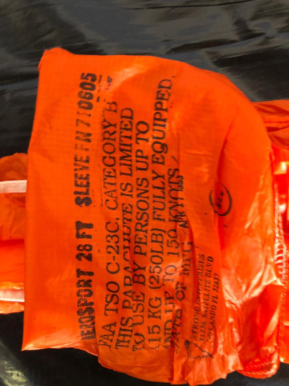

Gary73 10 #1 March 19, 2015 Just came across a Strong 304 Seat rig with a canopy I've never seen before: A Strong NOPO 24 Conical (P/N 420201). Very strange. The canopy is slit all the way around between the 2nd and 3rd panels, and came with a sleeve, X-slider, cross-connected suspension lines, and a detachable pilot chute. Of course Strong's closed for the weekend now. Anybody have any information on these? Thanks! "Extraordinary claims require extraordinary evidence." - Carl Sagan Quote Share this post Link to post Share on other sites
Gary73 10 #2 March 19, 2015 Photo of data panel. "Extraordinary claims require extraordinary evidence." - Carl Sagan Quote Share this post Link to post Share on other sites
pchapman 280 #3 March 19, 2015 Ooh, Strong Aerosport! Rare. Edit: Yes, p/n 420201 is a 24' Aerosport canopy according to my PDF manual. (As opposed to the 28' Aerosport, or 28' Aerosport HD.) Don't see the manual online anywhere at the moment but I could submit it to one of the rigging manual sites. Quote Share this post Link to post Share on other sites
councilman24 37 #4 March 19, 2015 Should be label Aerosport. DOM 95 or 96. Only on the market around there. I have two 28' versions. Nopo refers to them being made from 0-3 cfm (f-111) fabric. Manual is available on line. Check Parachutemanuals.com and ukskydiver.co.uk I think this only the 4th I've heard of. My two, one in Australia, and yours. Maybe a couple more. Free sleeve with stowed lines makes packing a Strong seat easy. This may be slightly diff. than mine but same design. Search strong aerosport on here. I serviced my two since the were new until the owner died a few years ago and I got them from the widow. Just saw photo. Think the changed name in 95. For several years in the 2000's nobody at strong new anything about them and I could find another rigger who had ever seen one.I'm old for my age. Terry Urban D-8631 FAA DPRE Quote Share this post Link to post Share on other sites
pchapman 280 #5 March 19, 2015 I couldn't find the manual at either of those two rigging sites... so I'm emailing the admins at those rigging sites my copy of the Aerosport manual. Not sure where I got it from originally. Quote Share this post Link to post Share on other sites
likestojump 3 #6 March 19, 2015 here's it's 28ft bro - Aerosport 28ft PN 4200702 sleeved and sub-apex vented and spyder-slidered Quote Share this post Link to post Share on other sites
councilman24 37 #7 March 19, 2015 Someone, maybe me, posted it on here a while ago. It was also added to the Strong website a few years ago. But couldn't find it last time I looked.I'm old for my age. Terry Urban D-8631 FAA DPRE Quote Share this post Link to post Share on other sites
Gary73 10 #8 March 19, 2015 Got a copy from Peter. Thanks, everyone! "Extraordinary claims require extraordinary evidence." - Carl Sagan Quote Share this post Link to post Share on other sites
