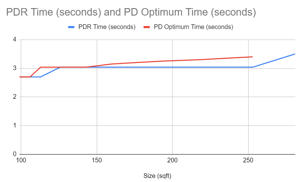

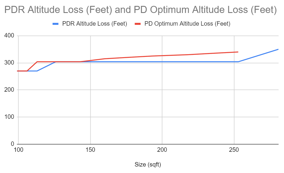

shadeland 5 #66 June 18, 2023 (edited) On 1/15/2014 at 2:45 PM, masterrigger1 said: The TSO requirements have been changed to allow canopies to snivel or have longer deployments. These same reserves, although they may have met the TSO requirements, may not actually meet the TSO requirements of another older TSO like in some of the H/Cs still have. Hi MEL, I know this is a very old thread, but I was curious about this doing research for Optimums so I did some digging. All of the PD Optimums are authorized under TSO c23d. The testing standards is of course SAE 8015b, which states opening should take no more than 300 seconds or 3 seconds. It's also the same TSO that the Aerodyne Smart reserves (regular and LPV) as well as Icarus World reserves (regular and nano). The PD Reserves are certified under c23b, c23c, or c23d, depending on when they're made I believe. c23f: Covered in PIA 135v1.4, section 4.3.8. It's an equation that takes maximum opening weight and maximum opening speed as inputs. The PD Optimums and PD Reserve aren't covered by this. Plugging in the various vendor weights and speeds, they're mostly in line with c23d. c23d: Covered in SAE 8015 rev b, section 4.3.6: Max 3 seconds or 300 feet. Exception is for over 250 lb, it can take a little longer (.01 seconds per pound). c23c: Covered in SAE 8015 rev a, section 4.3.6: Specifies only 3 seconds fully open from pack release. c23b: Covered in NAS 804, second 4.3.4: Open within four seconds. So from what I can tell, the optimums are required to open in the same amount of time as two of the other major vendors (Aerodyne and Icarus), and it's pretty much in line with the older TSOs as well. Edited June 18, 2023 by shadeland Quote Share this post Link to post Share on other sites
JerryBaumchen 1,484 #67 June 18, 2023 10 hours ago, shadeland said: Hi MEL, I know this is a very old thread, but I was curious about this doing research for Optimums so I did some digging. All of the PD Optimums are authorized under TSO c23d. The testing standards is of course SAE 8015b, which states opening should take no more than 300 seconds or 3 seconds. It's also the same TSO that the Aerodyne Smart reserves (regular and LPV) as well as Icarus World reserves (regular and nano). The PD Reserves are certified under c23b, c23c, or c23d, depending on when they're made I believe. c23f: Covered in PIA 135v1.4, section 4.3.8. It's an equation that takes maximum opening weight and maximum opening speed as inputs. The PD Optimums and PD Reserve aren't covered by this. Plugging in the various vendor weights and speeds, they're mostly in line with c23d. c23d: Covered in SAE 8015 rev b, section 4.3.6: Max 3 seconds or 300 feet. Exception is for over 250 lb, it can take a little longer (.01 seconds per pound). c23c: Covered in SAE 8015 rev a, section 4.3.6: Specifies only 3 seconds fully open from pack release. c23b: Covered in NAS 804, second 4.3.4: Open within four seconds. So from what I can tell, the optimums are required to open in the same amount of time as two of the other major vendors (Aerodyne and Icarus), and it's pretty much in line with the older TSOs as well. Hi shade, Without going thru a bunch of old documents [ some, I no longer have ], I believe that the 300 ft req'ment is an optional test; yes/no? Jerry Baumchen PS) Re: c23b: Covered in NAS 804, second 4.3.4: Open within four seconds. That is a Twisted Lines test, not a Functional test. TSO C23b NAS 804.pdf Quote Share this post Link to post Share on other sites
shadeland 5 #68 June 18, 2023 2 hours ago, JerryBaumchen said: Hi shade, Without going thru a bunch of old documents [ some, I no longer have ], I believe that the 300 ft req'ment is an optional test; yes/no? Jerry Baumchen PS) Re: c23b: Covered in NAS 804, second 4.3.4: Open within four seconds. That is a Twisted Lines test, not a Functional test. TSO C23b NAS 804.pdf 1.25 MB · 0 downloads Ah yup, my mistake. 4.3.3 is the open pack, normal. 3 seconds. I found this older copy of the FAA parachute rigger handbook (from 2005) which has all the standards that had been used up until then (8015a/b, NAE). Parachute-Rigger-Handbook.pdf Quote Share this post Link to post Share on other sites
shadeland 5 #69 June 18, 2023 The PD Reserve is c23b or c, I think depending on when it was made (3 seconds). The PD Optimum as well as the Aerodyne and Icarus reservers are c23d (3 seconds or 300 feet). c23f uses an equation, and I took the weights and speeds listed in the PD Reserve and PD Optimum and made some graphs on what the allowed altitude loss and opening time were if they were tested to c23f (which they're not). So the c23f is not too far off from c23d. (Keep in mind anything under 3 seconds or 300 feet would allowed to just be 3 seconds or 300 feet with c23f, so even though the smaller ones are less than 300/3, the standard specifies "or"). Quote Share this post Link to post Share on other sites
